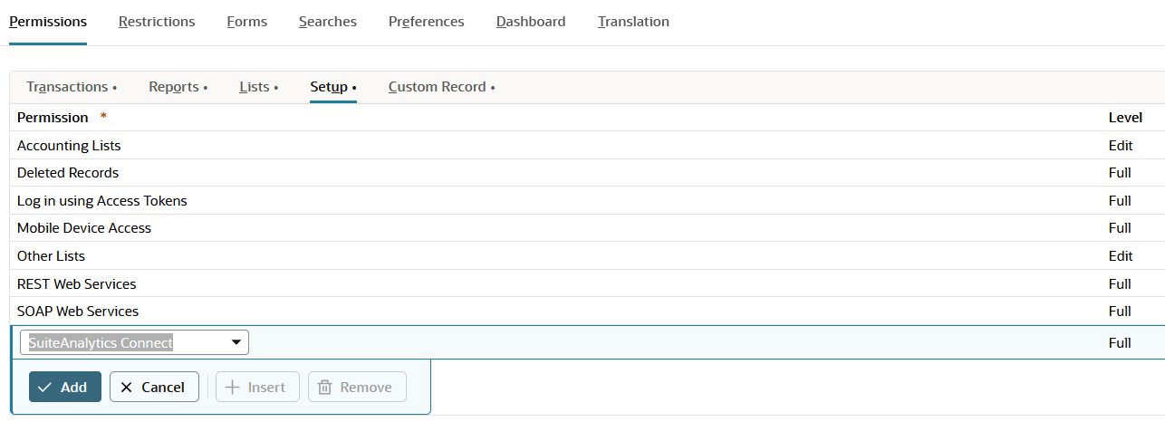

To set up SuiteAnalytics Connect permissions using Manage Roles:
  1. Go to Setup > Users/Roles > User Management > Manage Roles.
  2. Click Customize next to the name of the role for which you would like to add the SuiteAnalytics Connect permission.
  3. Click the Setup subtab under the Permissions subtab.
  4. Add the SuiteAnalytics Connect permission.
    Important:
    You can't add the SuiteAnalytics Connect permission to a role that has SAML Single Sign-on permission.
  5. Optionally, add the SuiteAnalytics Connect – Read All permission.
    This only applies to the Netsuite.com data source but not to the Netsuite2.com data source.
  6. Click Add.
  7. Click Save.
