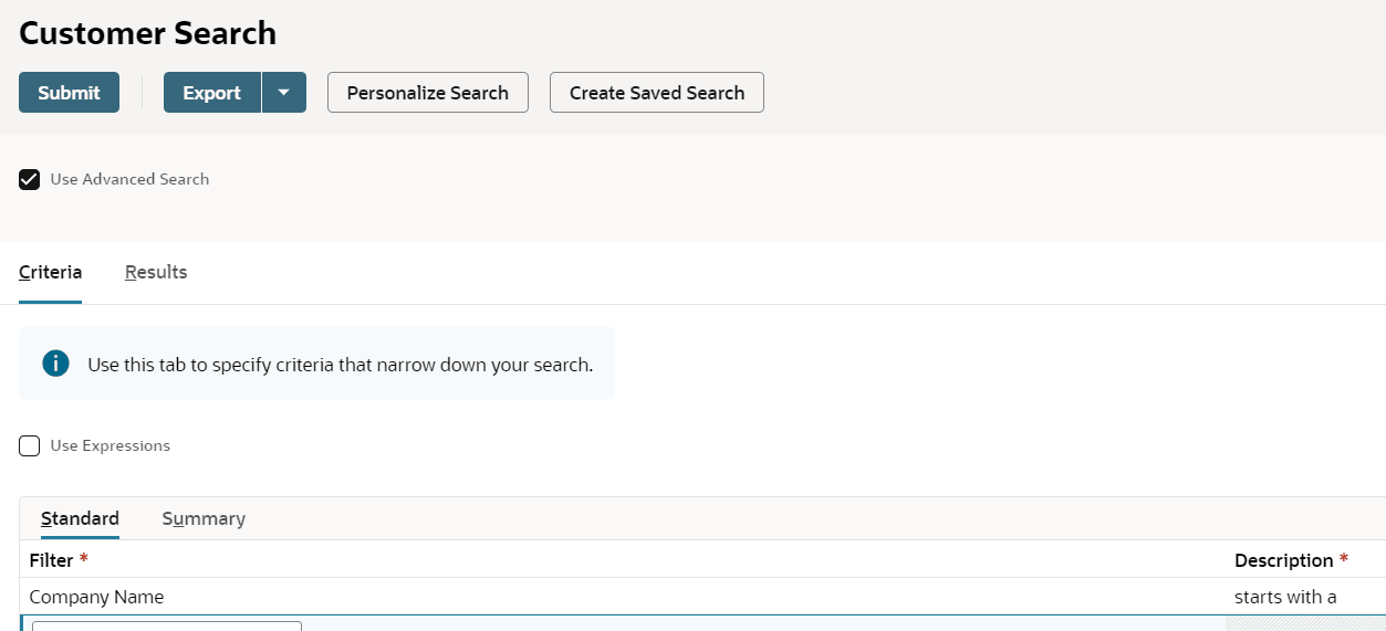

The following figures show the UI equivalent of an advanced search that includes search return columns.
First, specify the basic search criteria on the Criteria subtab (in this example all customers that have a company name starting with the letter A).

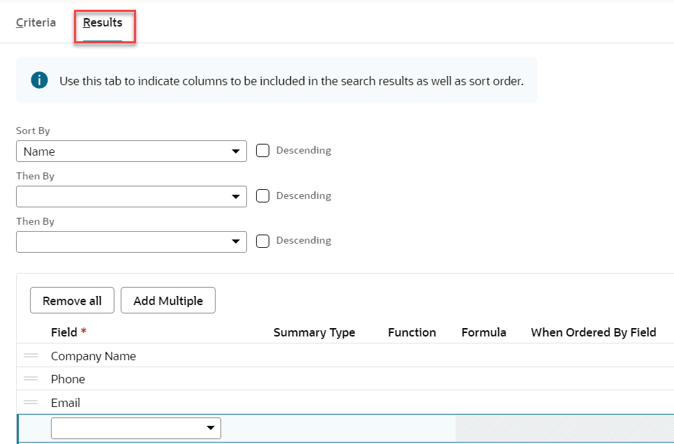

Next, click the Results subtab to define the search return columns. When your search is executed, your search response will return only the company name, phone, and contact name of all customers whose company starts with the letter A.
The following figure shows the results of the search. Only the relevant data are returned.
