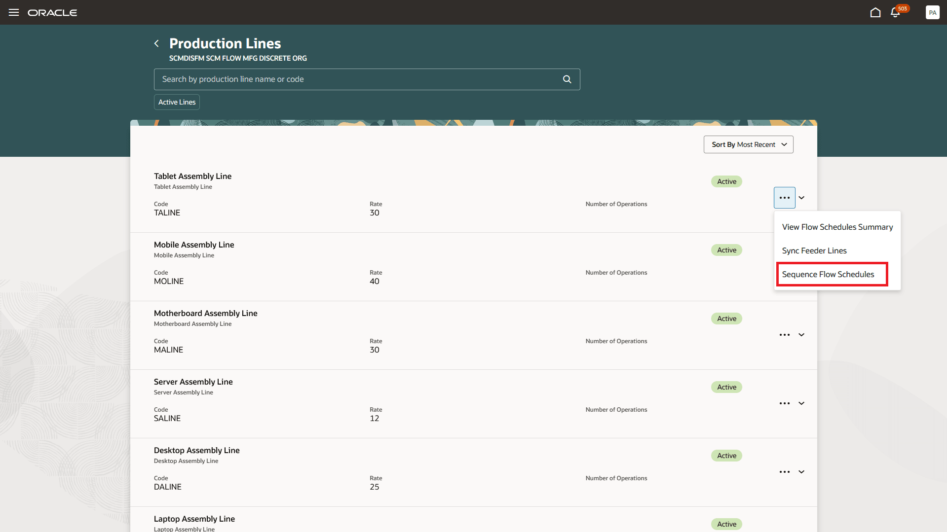

You can now sequence flow schedules for a production line using the scheduling strategy for an attribute sequence or rule-based sequence as defined in Production Scheduling.
Sequence Flow Schedules for a Production Line

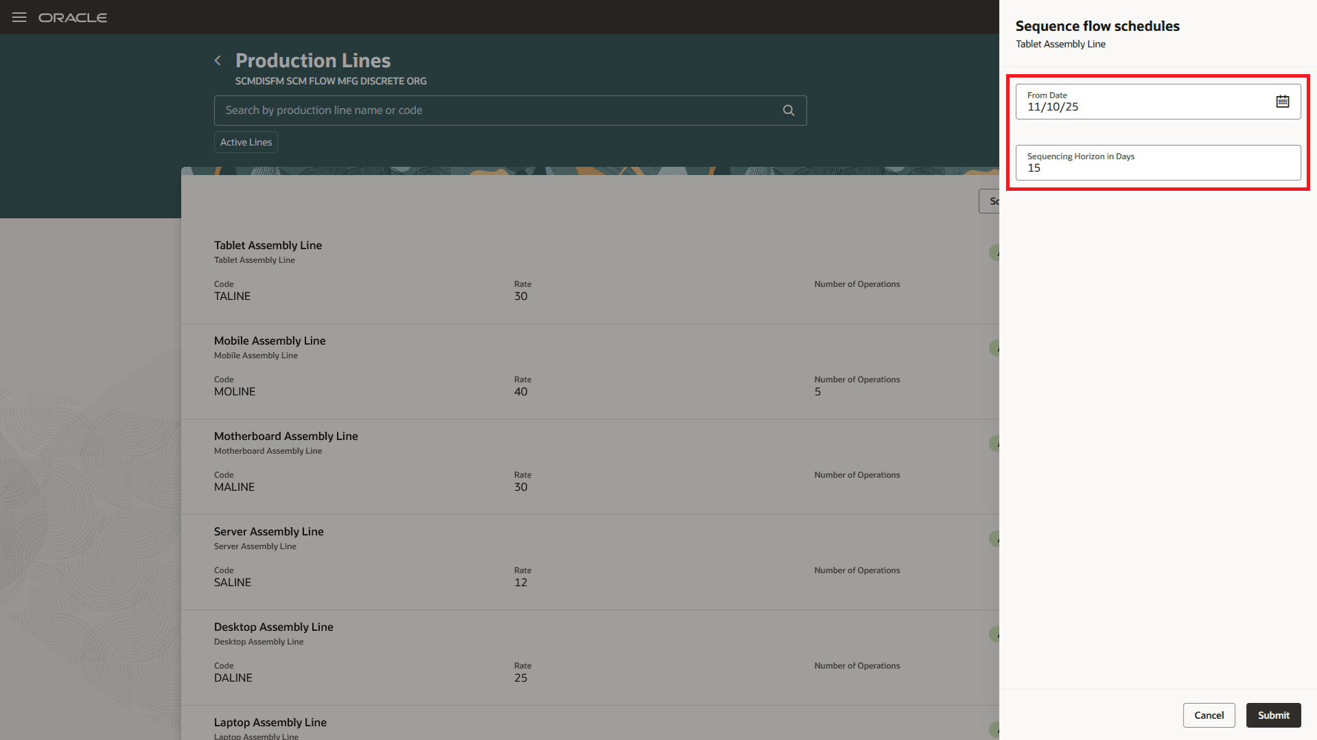

Specify the following sequencing parameters and submit the request to sequence flow schedules:
- From Date: Refers to the start date of the sequencing horizon.
- Sequencing Horizon in Days: Refers to the number of days from the start date of the sequencing horizon beyond which flow schedules will not be considered for sequencing.
Specify Sequencing Parameters
