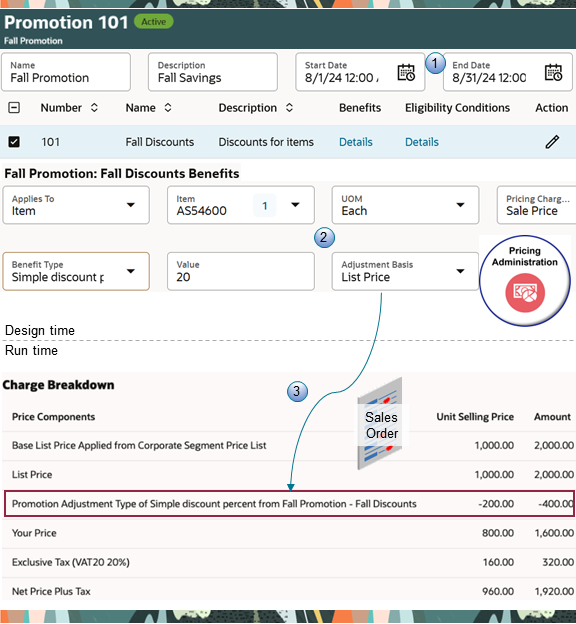

Create a Simple Promotion
Assume you sell supplies and equipment to students of all ages. You have a fall promotion that you want to run during the entire month of August:
Apply a 20% discount off the list price of each AS54600 item that my customer buys on August 1, 2024 through August 31, 2024.
Here's your set up:
try it
Try It:
  1. Go to the Pricing Administration work area, then click Tasks > Manage Pricing Promotions.
  2. On the Pricing Promotions page, click Create Promotion, then set the values.
    Attribute Value
    Number
    101
    Note
    • You can enter any alphanumeric value.
    • The value must be unique across promotions.
    • If you don't provide a value, then Pricing will automatically assign one after you click Save or Done.
    • You can't change the number after you save.
    • The same behavior applies for a promotion line's number.
    Name Fall Promotion
    Description Fall Savings
    Start Date
    August 1, 2024
    Use the promotion's start date and end date to determine when you want the promotion to be in effect.
    End Date August 31, 2024
  3. Click Add Row to add a promotion line, set the values, then click Apply.
    Attribute Value
    Promotion Line Number 101
    Promotion Line Name Fall Discounts
    Promotion Line Description Discounts for items
  4. A benefit is an incentive that provides a reason to motivate your customer to purchase an item. Click Add in the Benefits column, then set the values.
    Attribute Value
    Applies To Item
    Item AS54600
    UOM Each
    Pricing Charge Definition
    Sale Price
    Use this attribute to identify the charge where you want to apply the promotion.
    Assume you select Sale Price. If the item on the order line has a sale price charge, then Pricing will apply the promotion on that charge.
    For this example, you select only Sale Price, so Pricing will apply the promotion only on the sale price.
    Benefit Type Simple Discount Percent
    Value 20
    Adjustment Basis List Price
  5. Click Activate to make the promotion available so Pricing can use it to price your sales order. Use this button to help manage your set up. For example, you might need to add a number of lines and conditions before you want Pricing to use this promotion.
    You can't deactivate or delete a promotion. If you no longer want Pricing to use it, then set the End Date to a date that has already occurred.
If the sales order meets the condition, then Pricing will apply the rule at run time on the sales order in Order Management. The charge breakdown on the order line will include the promotion name, the promotion line's name, the type of adjustment, and the adjustment amount:
Promotion Adjustment Type of Simple Discount Percent from Fall Promotion – Fall Discounts

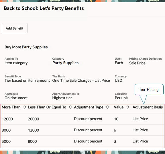

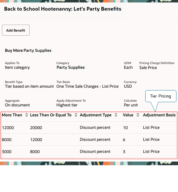

Tier Your Adjustments
You can add a tiered discount according to the list price and the category that the item is in:
If the total amount of one time charges for all party supplies on the sales order is more than:
  • $12,000 but less than $20,000, then apply a 10% discount off the list price.
  • $8,000 but less than $12,000, then apply a 6% discount off the list price.
  • $3,000 but less than $8,000, then apply a 3% discount off the list price.
Tell Pricing how to calculate the rule:
Attribute Value
Calculate
You can set it to one of:
  • Lump Sum. Apply the adjustment to all quantities. This is similar to the Block option in tier pricing.
  • Set the Remainder Quantities in the New Lump Sum attribute to Yes or No. This is similar to the Partial Block option in tier pricing.
  • Per Unit. Apply the rule to each unit. For example, if the order line's quantity is 4, and if the discount is $1 for each item, then the total discount is $4.
For this example, set it to Per Unit.
For background about tier pricing and how to set some of these attributes, see Tier Pricing and Add Tiers to Pricing Rules.

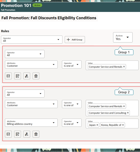

You can use a set of predefined customer attributes, order line attributes, and item attributes to focus your rule according to those attribute's values.
Consider this example:
Adding a group adds OR logic to your eligibility conditions. The Rules section in this example has two groups:
Group Rule
1 If the Customer attribute contains Computer Service and Rentals, then apply the promotion.
2 Or if the Customer attribute contains Computer Service and Rentals, or if it contains Computer Service and Consulting, and if the billing address is in Japan or Korea, then apply the promotion.
Note
  • If you reference an attribute that might have more than one value, such as Billing Address City, then include another condition that examines a different attribute, such as Billing Address State or Billing Address Country. This will help to further qualify the promotion.
  • The Eligibility Conditions dialog displays the attribute values that you can set.

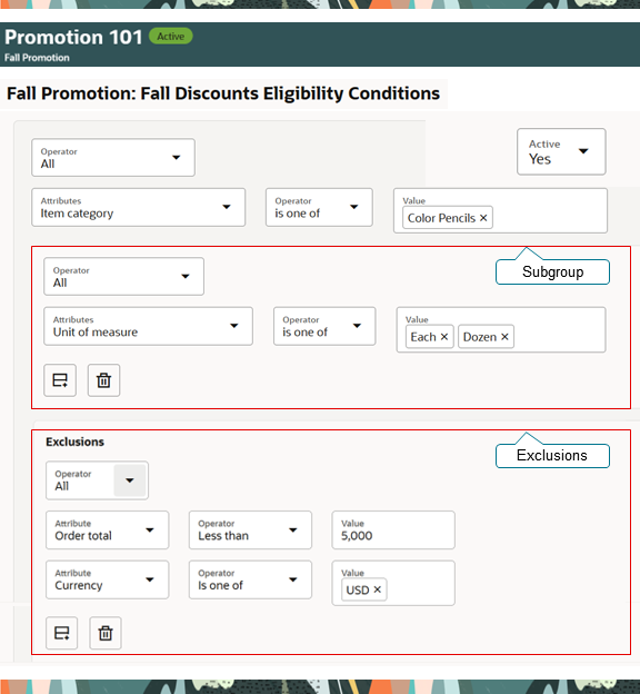

Group and Exclude
Use subgroups and exclusions to focus your promotion even more. A subgroup works like adding an AND operator to the group, while an exclusion works like adding a NOT operator to the group. Consider this example:
The category specifies Color Pencils as the group, an order line attribute specifies the subgroup, and we also have an exclusion. The example applies this rule:
Condition Rule
Group If the item is in the Color Pencils category. . .
Subgroup . . . And if the order line's Unit of Measure attribute contains Each or it contains Dozen. . .
Exclusion . . . And if the total amount on the sales order isn't less than 5,000 and the currency is USD, then apply the promotion.
Note
  • If you specify a condition according to Line Amount or Order Total, then include the currency as a separate condition.
  • If you specify a condition according to Line Quantity, then include the UOM as a separate condition.
  • Some customer attributes might have more than one value, such as Billing Address City. If you reference an attribute that might have more than one value, then include another condition, such as Billing Address State or Billing Address Country. This will help to further qualify the promotion.
  • You can use the Is One Of operator to specify more than one value in a condition. This example's subgroup uses the Is One Of operator to apply the condition when the attribute's value is Each or Dozen.

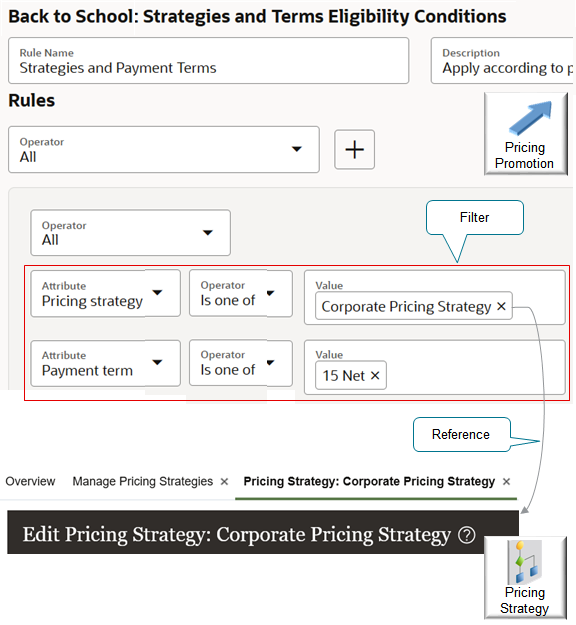

Apply Strategies and Payment Terms
Automatically match a promotion to your pricing strategy and payment term.
Create an eligibility rule that uses a pricing strategy or payment term to determine whether the order is eligible for a pricing promotion. Use the pricing strategy to automatically match the promotion to your pricing objective. As an alternative, add a payment term to your eligibility rule so you can reward each customer who agrees to the term that meets your strategy.
Try it:
  1. Create your promotion and promotion line, then add a benefit.
  2. Add an eligibility rule to the benefit and use it to specify which sales orders are eligible for promotion.
For example, filter eligibility where the pricing strategy is Corporate Pricing Strategy and the payment term is 15 NET:
strategy
Note
  • You can add a pricing strategy to an eligibility rule even if you haven't approved the strategy. This way you can set up and test your strategies and rules before you assign the strategy.
  • Select your payment term carefully. Payment terms use a variety of formats. For example, 2/10 Net 30 is a payment term, and so is 2/10, Net 30. If you need the one that has the comma, then search for 2/10, Net 30. You might also see duplicate values for the same term. To avoid this problem, we recommend that you use unique values in the Name attribute when you use the Manage Payment Terms task in the Setup and Maintenance work area to create your payment terms.
