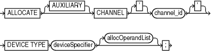

Semantics
Syntax Element Description
AUXILIARY
Specifies a connection between RMAN and an auxiliary database instance.
An auxiliary instance is used when executing the DUPLICATE or TRANSPORT TABLESPACE command, and when performing TSPITR with RECOVER TABLESPACE (see Example 2-8). When specifying this option, the auxiliary instance must be started but not mounted.
See Also: DUPLICATE to learn how to duplicate a database, and CONNECT to learn how to connect to a duplicate database instance
CHANNEL channel_id
Specifies a connection between RMAN and the target database instance. The channel_id is the case-sensitive name of the channel. The database uses the channel_id to report I/O errors.
Each connection initiates a database server session on the target or auxiliary instance: this session performs the work of backing up, restoring, or recovering RMAN backups. You cannot make a connection to a shared server session.
Whether ALLOCATE CHANNEL allocates operating system resources immediately depends on the operating system. On some platforms, operating system resources are allocated at the time the command is issued. On other platforms, operating system resources are not allocated until you open a file for reading or writing.
Each channel operates on one backup set or image copy at a time. RMAN automatically releases the channel at the end of the job.
Note: You cannot prefix ORA_ to a channel name. RMAN reserves channel names beginning with the ORA_ prefix for its own use.
DEVICE TYPE deviceSpecifier
Specifies the type of storage for a backup. Query the V$BACKUP_DEVICE view for information about available device types and names.
Note: When you specify DEVICE TYPE DISK, no operating system resources are allocated other than for the creation of the server session.
See Also: deviceSpecifier
   allocOperandList
Specifies control options for the allocated channel. The channel parameters for sequential I/O devices are platform-specific (see Example 2-5).
See Also: allocOperandList
