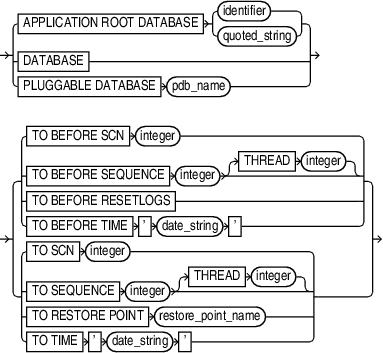

Syntax
flashback::=
flashbackObject::=
Semantics
flashback::=
| Syntax Element | Description |
Allocates automatic channels for the specified device type only. For example, if you configure automatic disk and tape channels, and issue See Also: |
flashbackObject::=
Rewinds the entire CDB, including the root and all PDBs. |
Rewinds the specified PDB. All other PDBs can be open and operational, but the specified PDB must be closed. When the CDB uses shared undo, an auxiliary destination is used to store temporary files used during the flashback operation. The default auxiliary destination is the fast recovery area. You can use the |
Returns the database to its state just before the specified SCN. Any changes at an SCN lower than that specified are applied, but if there is a change associated with the specified SCN it is not applied. By default, the provided SCN resolves to the current or ancestor incarnation. You can override the default by using the Query |
Specifies a redo log sequence number and thread as an upper limit. RMAN applies changes up to (but not including) the last change in the log with the specified sequence and thread number. |
Returns the database to its state including all changes up to the SCN of the most recent Note: For PDBs, the Flashback Operation must return the PDB to its state including all changes up to the most recent |
TO BEFORE TIME 'date_string' |
Returns the database to its state including all changes up to but not including changes at the specified time. Query |
Returns the database to the point up to (and including) the specified SCN. By default, the provided SCN resolves to the current or ancestor incarnation. You can override the default by using the RMAN Query |
Specifies a redo log sequence number and thread as an upper limit. RMAN applies changes up to (and including) the last change in the log with the specified sequence and thread number. |
TO RESTORE POINT restore_point_name |
Returns the database to the SCN associated with the specified restore point. This can be an ordinary restore point or a guaranteed restore point. For CDBs, you must specify a CDB restore point. The entire CDB is returned to the SCN associated with the specified CDB restore point. For PDBs, you can specify either a CDB restore point, PDB restore point, or a clean PDB restore point. RMAN returns the PDB to the SCN associated with the specified restore point. The remaining PDBs in the CDB are not impacted by a flashback operation on a particular PDB. |
Returns the database to its state at the specified time. You can use any SQL Query Note:
AUXILIARY DESTINATION ’location' |
Specifies the location where temporary database files used during flashback database operations in a multitenant environment are stored. When a CDB uses shared undo, you must specify an auxiliary destination. For CDBs that use local undo, specifying an auxiliary destination is optional. |
