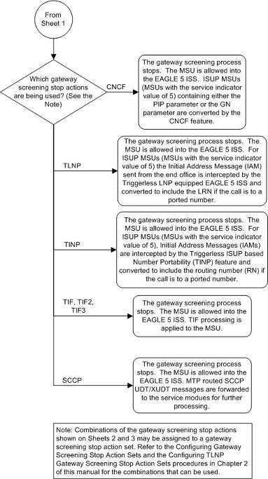

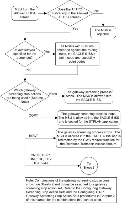

Gateway Screening Actions
The Gateway Screening process stops with this screen. The nsfi parameter value can only be stop.
If a match is not found, the message is discarded.
If a match is found, the message is processed. If a gateway screening stop action set is specified with the screen, shown by the actname parameter value, the message is processed according to the gateway screening stop actions that are assigned to the gateway screening stop action set.
  • If the rdct (redirect) gateway screening stop action is specified, the message is diverted from the original destination and sent to another destination with the Database Transport Access feature, specified by global title translation, for further processing.
  • If the cncf gateway screening stop action is specified, the PIP parameter in the incoming ISUP IAM message is converted to the GN parameter. The GN parameter in the incoming ISUP IAM message is converted to the PIP parameter. The message is then sent to the node specified by the DPC in the routing label in the message. For more information on the Calling Name Conversion Facility feature, see Calling Name Conversion Facility (CNCF) Configuration.
  • If the tlnp gateway screening stop action is specified, ISUP IAMs that pass gateway screening are processed either by the ISUP NP with EPAP feature (if the ISUP NP with EPAP feature is enabled and turned on) or by the Triggerless LNP feature (if the Triggerless LNP feature is turned on). The ISUP NP with EPAP feature is discussed in more detail in G-Port User's Guide. The Triggerless LNP feature is discussed in more detail in ELAP Administration and LNP Feature Activation Guide.
  • If the tinp gateway screening stop action is specified, ISUP IAMs that pass gateway screening are intercepted by the Triggerless ISUP based Number Portability (TINP) feature and converted to include the routing number (RN) if the call is to a ported number. The TINP feature is discussed in more detail in G-Port User's Guide.
  • If the tif, tif2, or tif3 gateway screening stop actions are specified, TIF processing is applied to the message.
  • If the sccp gateway screening stop action is specified, MTP routed SCCP UDT/XUDT are forwarded to the service modules for further processing.
Allowed AFTPC Screening Actions
Figure 3-1 and Figure 3-2 show the screening actions of the allowed AFTPC screen.
Figure 3-1 Allowed AFTPC Screening Actions - Sheet 1 of 2
img/allowed-aftpc-01-140964.jpg

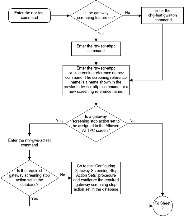

  1. Verify that the gateway screening feature is on, by entering the rtrv-feat command.
    If the gateway screening feature is on, the GWS field is set to on.
    Thertrv-feat command output contains other fields that are not used by this procedure. If you wish to see all the fields displayed by thertrv-feat command, see thertrv-feat command description inCommands User's Guide.
    If the gateway screening feature is on, shown by the entry GWS = on in the rtrv-feat command output, skip step 2, and go to step 3.
  2. Turn the gateway screening feature on by entering this command.
    chg-feat:gws=on
    Once the gateway screening feature is turned on with thechg-feat command, it cannot be turned off.
    The gateway screening feature must be purchased before you turn this feature on with the chg-feat command. If you are not sure if you have purchased the gateway screening feature, contact your Oracle Sales Representative or Account Representative.
    When the chg-feat has successfully completed, this message should appear.
    rlghncxa03w 06-10-28 11:43:04 GMT EAGLE5 36.0.0
    CHG-FEAT: MASP A - COMPLTD
  3. Display all allowed AFTPC screens in the database using the rtrv-scr-aftpc command.

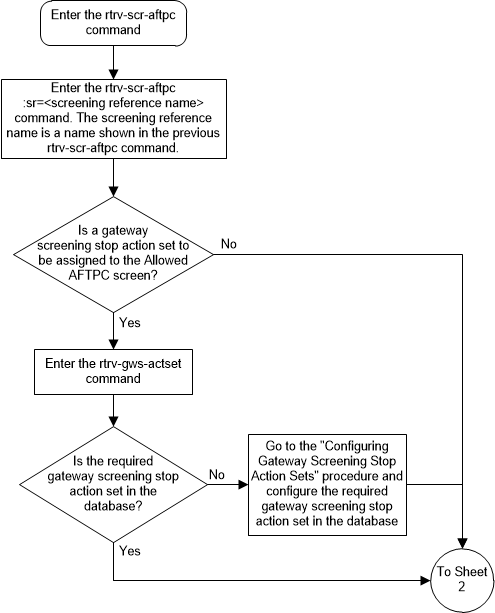

    If a gateway screening stop action set is to be assigned to the allowed AFTPC screen being added to the database, go to step 4. Otherwise, go to step 5.
  4. Display the gateway screening stop action sets in the database with the rtrv-gws-actset command.
    This is an example of the possible output.
    rlghncxa03w 06-10-25 15:26:30 GMT EAGLE5 36.0.0
    ACT  ACT    ACT  ACT  ACT  ACT  ACT  ACT  ACT  ACT  ACT  ACT
    ID   NAME   1    2    3    4    5    6    7    8    9    10
    1    copy   copy
    2    rdct   rdct
    3    cr     copy rdct
    4    cncf   cncf
    5    cpcncf copy cncf
    6    cncfrd cncf rdct
    7    cpcfrd copy cncf rdct
    GWS action set table is (7 of 16) 44% full
    If the required gateway screening stop action set is not in the database, perform the Configuring Gateway Screening Stop Action Sets procedure to configure the required gateway screening stop action set.

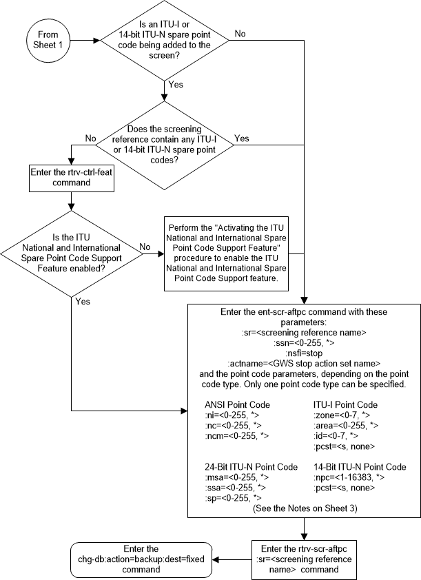

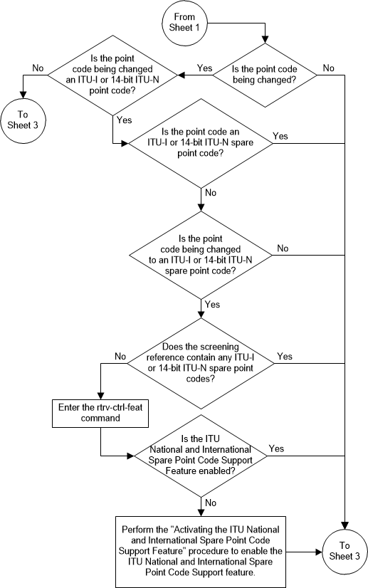

    If the point code being added in this procedure is not an ITU-I or 14-bit ITU-N spare point code, skip step 5 and to step 6.
    If the point code being added in this procedure is an ITU-I or 14-bit ITU-N spare point code and the screening reference contains ITU-I or 14-bit ITU-N spare point codes, skip step 5 and go to step 6.
  5. Display the status of the ITU National and International Spare Point Code Support feature by entering the rtrv-ctrl-feat command with the ITU National and International Spare Point Code Support feature part number.
    Enter this command.
    rtrv-ctrl-feat:partnum=893013601
    rlghncxa03w 06-10-25 15:25:30 GMT EAGLE5 36.0.0
    The following features have been permanently enabled:
    Feature Name              Partnum   Status Quantity
    Spare Point Code Support  893013601 on     ----
    The following features have been temporarily enabled:
    Feature Name              Partnum   Status Quantity   Trial Period Left
    Zero entries found.
    The following features have expired temporary keys:
    Zero entries found.
    If the ITU National and International Spare Point Code Support feature is enabled, go to step 6.
    If the ITU National and International Spare Point Code Support feature is not enabled, perform the “Activating the ITU National and International Spare Point Code Support Feature” procedure in Database Administration - SS7 User's Guide to enable the ITU National and International Spare Point Code Support feature as required. After the feature has been enabled, go to step 6.
  6. Add the new allowed AFTPC screen to the database using the ent-scr-aftpc command.
    Caution:
    TheEAGLE does not support redirecting MSUs for the DTA feature or intercepting ISUP IAM messages for the Calling Name Conversion Facility feature from the allowed AFTPC screen. Gateway screening stop action sets containing either the RDCT (redirect) or CNCF (calling name conversion facility) stop actions should not be assigned to the allowed AFTPC screen. If a gateway screening stop action set containing the RDCT or CNCF stop actions is specified with the ent-scr-aftpc command, unsolicited information message (UIM) 1127 is generated when the attempt is made to redirect MSUs from the allowed AFTPC screen. Unsolicited information message (UIM) 1217 is generated when ISUP IAM MSUs are intercepted from the allowed AFTPC screen. For more information on UIMs 1127 and 1217, go to Unsolicited Alarm and Information Messages Reference.
    If a gateway screening stop action is to be assigned to the allowed AFTPC screen being changed, enter the ent-scr-aftpc command with the nsfi=stop parameter and the actname parameter with the name of a gateway screening stop action set shown in the output of the rtrv-gws-actset command executed in step 4.
    The following list contains the values for ni, nc, ncm, zone, area, id, npc, msa, ssa, sp, and ssn parameters:
    • ni – 0 - 255 or an asterisk (*)
    • nc – 0 - 255 or an asterisk (*)
    • ncm – 0 - 255 or an asterisk (*)
    • zone – 0 - 7 or an asterisk (*)
    • area – 0 - 255 or an asterisk (*)
    • id – 0 - 7 or an asterisk (*)
    • npc – 1 - 16383 or an asterisk (*)
    • msa – 0 - 255 or an asterisk (*)
    • ssa – 0 - 255 or an asterisk (*)
    • sp – 0 - 255 or an asterisk (*)
    • ssn – 0 - 255 or an asterisk (*)
    A range of values can be specified for the ni, nc, and ncm parameters. See the Specifying a Range of Values section for more information on how the asterisk and a range of values are used for the ni, nc, and ncm parameters.
    To add a spare point code to the allowed AFTPC screen, the pcst=s parameter must be specified. To add a non-spare point code to the allowed AFTPC screen, the pcst parameter does not have to be specified. If the pcst parameter is specified for a screen containing an ITU-I or 14-bit ITU-N non-spare point code, the value must be none. For this example, enter these commands.
    ent-scr-aftpc:sr=gw20:ni=008:nc=008:ncm=008:ssn=250:nsfi=stop :actname=copy
    A message similar to the following should appear.
    rlghncxa03w 06-10-25 15:27:30 GMT  EAGLE5 36.0.0
    ENT-SCR-AFTPC: SCREEN SET AFFECTED - GW20  1% FULL
    ENT-SCR-AFTPC: MASP A - COMPLTD
    ent-scr-aftpc:sr=ls04:ni=010:nc=010:ncm=010:ssn=015:nsfi=stop :actname=copy
    rlghncxa03w 06-10-25 15:28:30 GMT  EAGLE5 36.0.0
    ENT-SCR-AFTPC: SCREEN SET AFFECTED - LS04  1% FULL

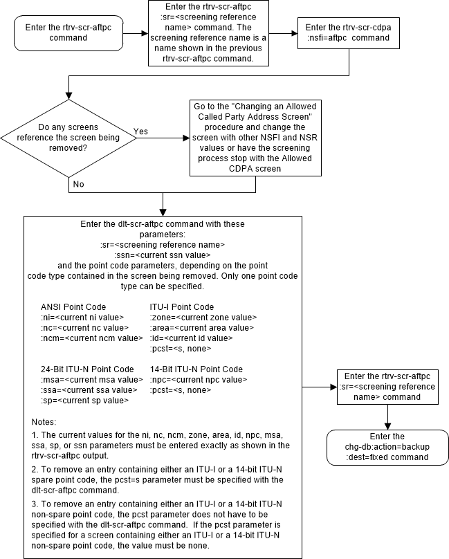

Removing an Allowed Affected Point Code Screen
This procedure is used to remove an allowed affected point code (AFTPC) screen from the database using the dlt-scr-aftpc command. The parameters used by the dlt-scr-aftpc command are shown in the Gateway Screening Attributes section. The general rules that apply to configuring gateway screening entities are shown in the Gateway Screening Configuration section.
The example in this procedure removes the allowed AFTPC screen wrd0 from the database.
If you using multiple-part ITU national point codes with gateway screening, see the 14-Bit ITU National Point Code Formats section.
  1. Display the allowed AFTPC screens in the database using the rtrv-scr-aftpc command.
    The following is an example of the possible output.
    SCREEN = ALLOWED AFTPC
    SR    REF  RULES
    GW20  YES     1
    IEC   YES     2
    LS04  YES     1
    WRD0  YES     1
    WRD2  YES     1
    WRD4  YES     9
    From the rtrv-scr-aftpc output, display the allowed AFTPC screen you wish to remove using the rtrv-scr-aftpc command with the screening reference name. For this example, enter the rtrv-scr-aftpc:sr=wrd0 command. The following is an example of the possible output.
    SR      ZONE   AREA     ID       SSN      NSFI    NSR/ACT
    WRD0    1      004      6        023      STOP    ------
  2. An allowed AFTPC screen can only be referenced by an allowed CDPA screen.
    Verify any references to the allowed AFTPC screen being removed from the database using the rtrv-scr-cdpa:nsfi=aftpc command. The following is an example of the possible output.

    If the screen being removed is referenced by any CDPA screens, perform the Changing an Allowed Called Party Address Screen procedure to change the NSFI of those CDPA screens to reference other AFTPC screens or change the NSFI of these screens to STOP.
  3. Remove the allowed AFTPC screen from the database using the dlt-scr-aftpc command with the screening reference name shown in the rtrv-scr-aftpc output in step 1 and with the point code parameter values (ni, nc, ncm, or zone, area, id, or npc, or msa, ssa, sp) and the ssn parameter value of the screen being removed from the database.
    The values for these parameters must be entered exactly as shown in the rtrv-scr-aftpc output.
    To remove an entry containing either an ITU-I or a 14-bit ITU-N spare point code, the pcst=s parameter must be specified with the dlt-scr-aftpc command.
    To remove an entry containing either an ITU-I or a 14-bit ITU-N non-spare point code, the pcst parameter does not have to be specified with the dlt-scr-aftpc command. If the pcst parameter is specified, the value must be none.
    For this example, enter this command.
    dlt-scr-aftpc:sr=wrd0:zone=1:area=004:id=6:ssn=023
    rlghncxa03w 06-10-25 15:29:30 GMT  EAGLE5 36.0.0
    DLT-SCR-AFTPC: SCREEN SET AFFECTED - WRD0  0% FULL
    DLT-SCR-AFTPC: MASP A - COMPLTD
  4. Verify the changes using the rtrv-scr-aftpc command with screening reference name used in step 3.
    The following message should appear.
    E2573 Cmd Rej: SR or NSR does not reference an existing SR
    This message shows that the specified screening reference name is not in the database and the action of the dlt-scr-aftpc command in step 5 was successful. If the specified screening reference name contained more than one entry when the dlt-scr-aftpc command was executed in step 4, the rtrv-scr-aftpc:sr= command output would show the remaining entries in the screening reference instead of error message E2573.
  5. Backup the new changes using the chg-db:action=backup:dest=fixed command.
    The following messages should appear, the active Maintenance and Administration Subsystem Processor (MASP) appears first.
    BACKUP (FIXED) : MASP A - Backup starts on active MASP.
    BACKUP (FIXED) : MASP A - Backup on active MASP to fixed disk complete.
    BACKUP (FIXED) : MASP A - Backup starts on standby MASP.
    BACKUP (FIXED) : MASP A - Backup on standby MASP to fixed disk complete.
Figure 3-7 Remove an Allowed Affected Point Code Screen
    SR    REF  RULES
    GW20  YES     1
    GW21  YES     1
    IEC   YES     2
    LS04  YES     1
    WRD0  YES     1
    WRD2  YES     1
    WRD4  YES     9
    From the rtrv-scr-aftpc output, display the allowed AFTPC screen you wish to change using the rtrv-scr-aftpc command with the screening reference name. For this example, enter this command.
    rtrv-scr-aftpc:sr=gw21
    SR    NI       NC       NCM      SSN      NSFI    NSR/ACT
    GW21  009      009      009      253      STOP    ------
    If a gateway screening stop action set is to be assigned to the allowed AFTPC screen being changed in this procedure, go to step 2. Otherwise, skip step 2 and go to step 3.
  2. Display the gateway screening stop action sets in the database with the rtrv-gws-actset command.
    1    copy   copy
    2    rdct   rdct
    3    cr     copy rdct
    4    cncf   cncf
    5    cpcncf copy cncf
    6    cncfrd cncf rdct
  3. Display the status of the ITU National and International Spare Point Code Support feature by entering the rtrv-ctrl-feat command with the ITU National and International Spare Point Code Support feature part number.
    If any of these conditions apply to this procedure, skip this step and go to step 4:
    • The point code in the screen is not being changed.
    • The screen being changed contains either an ANSI or 24-bit ITU-N point code.
    • The ITU-I or 14-bit ITU-N non-spare point code in the screen is not being changed to an ITU-I or 14-bit ITU-N spare point code.
    • The point code in the screen is an ITU-I or 14-bit ITU-N spare point code or the screening reference contains other screens with ITU-I or 14-bit ITU-N spare point codes.
    Enter this command.
    Zero entries found.
    Zero entries found.
    If the ITU National and International Spare Point Code Support feature is enabled, go to step 4.
    If the ITU National and International Spare Point Code Support feature is not enabled, perform the “Activating the ITU National and International Spare Point Code Support Feature” procedure in Database Administration - SS7 User's Guide to enable the ITU National and International Spare Point Code Support feature as required. After the feature has been enabled, go to step 4.

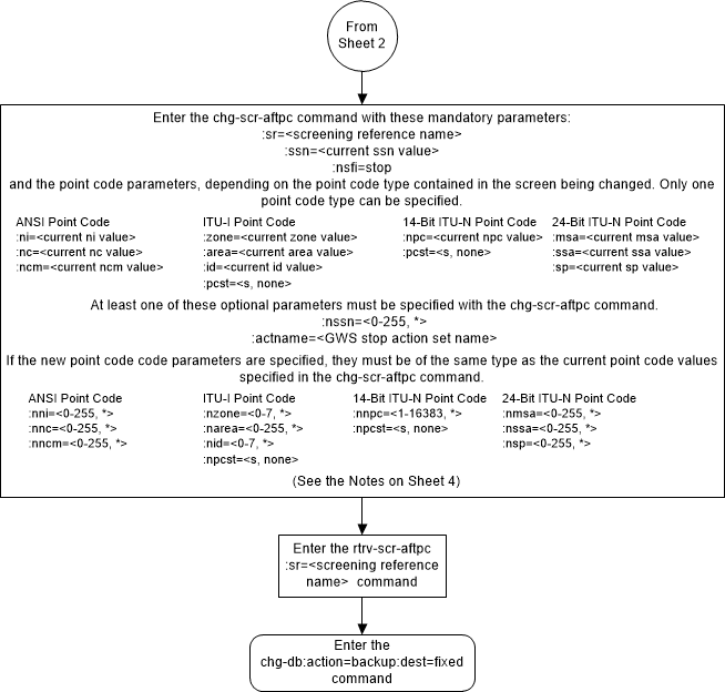

  4. Change the attributes of an allowed AFTPC screen using the chg-scr-aftpc command.
    If a gateway screening stop action is to be assigned to the allowed AFTPC screen being changed, enter the chg-scr-aftpc command with the nsfi=stop parameter and the actname parameter with the name of a gateway screening stop action set shown in the output of the rtrv-gws-actset command executed in step 2.
    The current values for the ni, nc, ncm, zone, area, id, npc, msa, ssa, sp, and ssn parameters must be entered exactly as shown in the rtrv-scr-aftpc output in step 1.
    The following list contains the values for the nni, nnc, nncm, nzone, narea, nid, nnpc, nmsa, nssa, nsp, and nssn parameters:
    • nni - 0-255 or an asterisk (*)
    • nnc - 0-255 or an asterisk (*)
    • nncm - 0-255 or an asterisk (*)
    • nzone - 0-7 or an asterisk (*)
    • narea - 0-255 or an asterisk (*)
    • nid - 0-7 or an asterisk (*)
    • nnpc - 1 - 16383 or an asterisk (*)
    • nmsa - 0-255 or an asterisk (*)
    • nssa - 0-255 or an asterisk (*)
    • nsp - 0-255 or an asterisk (*)
    • nssn – 0 - 255 or an asterisk (*)
    A range of values can be specified for the nni, nnc, and nncm parameters. See the “Specifying a Range of Values” section for more information on how the asterisk and a range of values are used for the nni, nnc, and nncm parameters.
    To change an ITU-I or 14-bit ITU-N spare point code to a non-spare point code, both the pcst=s and npcst=none parameters must be specified with the chg-scr-aftpc command.
    To change an ITU-I or 14-bit ITU-N non-spare point code to a spare point code, the npcst=s parameter must be specified with the chg-scr-aftpc command. The pcst parameter does not have to be specified.
    If the current point code in the screen being changed is either an ITU-I or 14-bit ITU-N spare point code, the pcst=s parameter must be specified with the chg-scr-aftpc command.
    If the current point code in the screen being changed is either an ITU-I or 14-bit ITU-N non-spare point code, the pcst parameter does not have to be specified with the chg-scr-aftpc command. If the pcst parameter is specified for a screen containing either an ITU-I or 14-bit ITU-N non-spare point code, the pcst parameter value must be none.
    chg-scr-aftpc:sr=gw21:ni=009:nc=009:ncm=009:ssn=253:nni=100 :nnc=100:nncm=100:nssn=150

Figure 3-8 Change an Allowed Affected Point Code Screen - Sheet 1 of 4
img/chg-scr-aftpc-01-300.bmp
