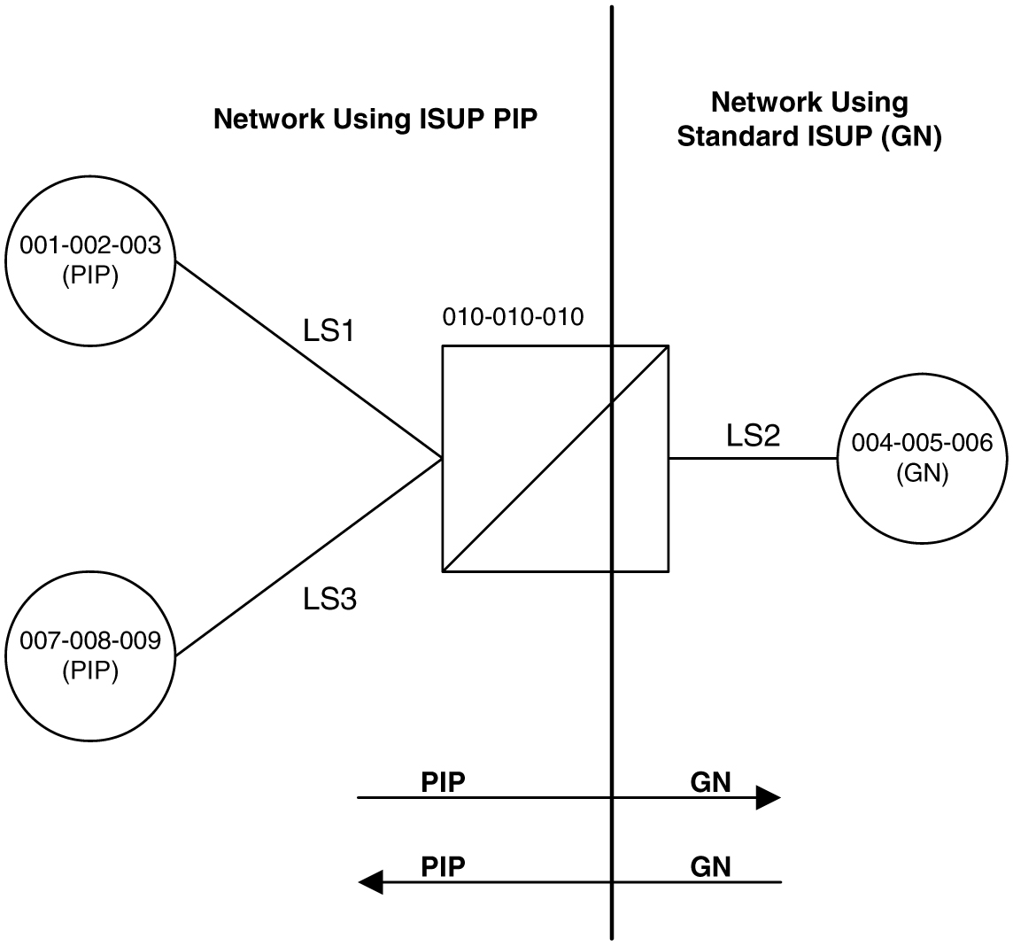

Figure 14-1 shows an example network which contains these two separate ISUP versions. Based on this example, Table 14-1 shows when the ISUP IAM message conversion by the CNCF feature occurs.
Figure 14-1 PIP/GN Parameter Conversion
img/c-introduction-12-dbags-fig1.jpg
Table 14-1 ISUP IAM Message Conversion Examples
Origination Point Code Destination Point Code ISUP IAM Message Conversion
001-002-003 004-005-006 Yes
001-002-003 007-008-009 No
004-005-006 001-002-003 Yes
004-005-006 007-008-009 Yes
007-008-009 001-002-003 No
007-008-009 004-005-006 Yes

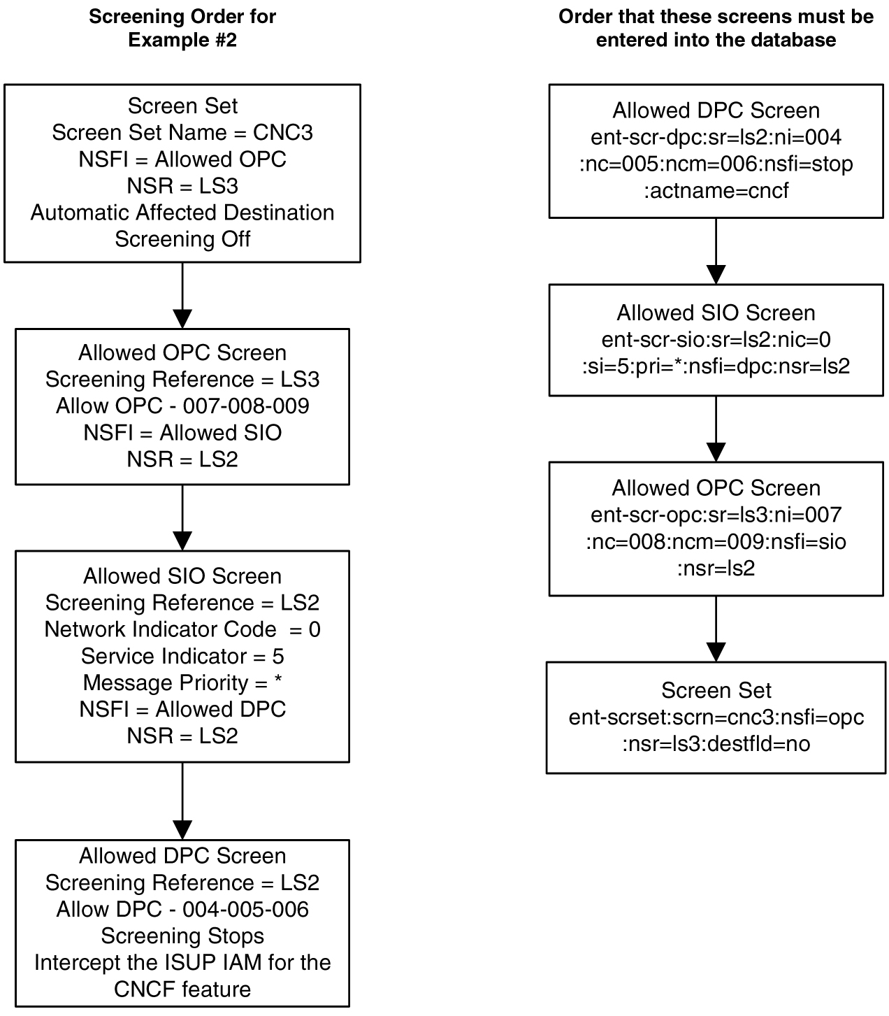

The examples in this procedure are based on these figures and tables.

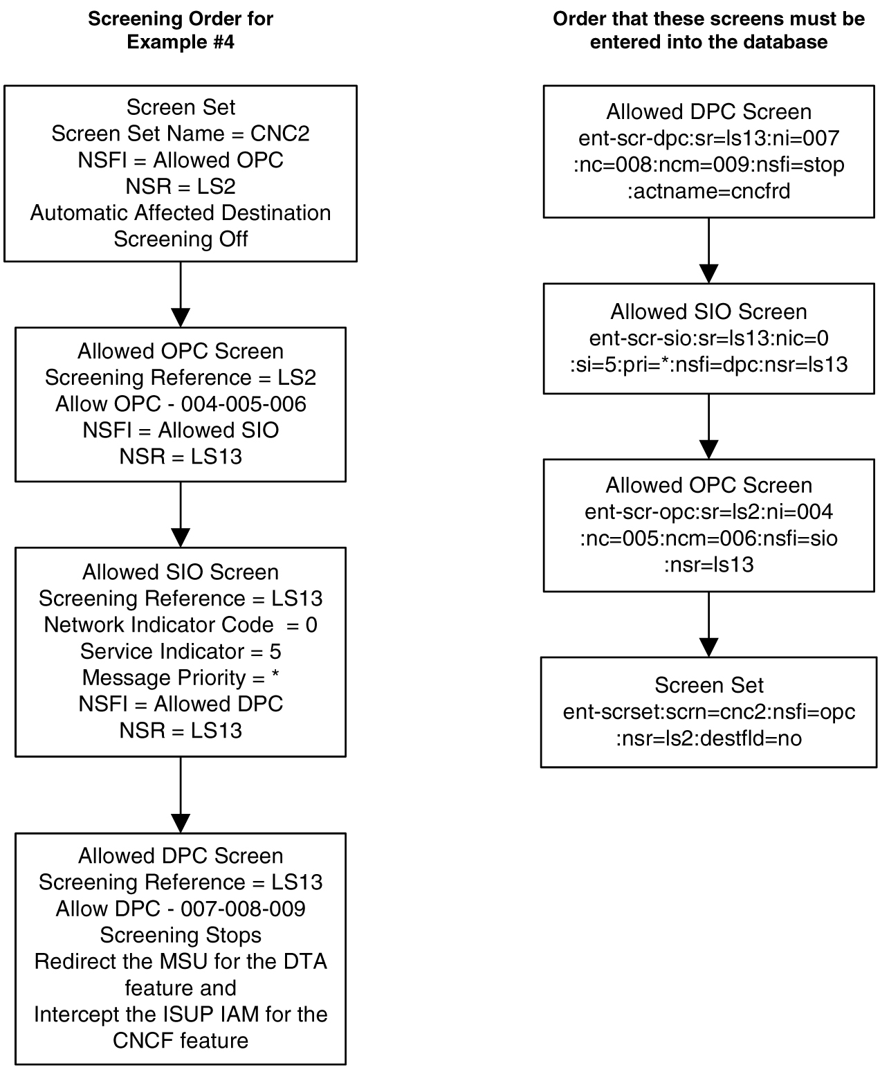

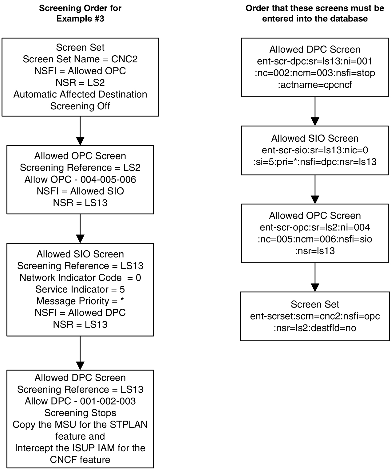

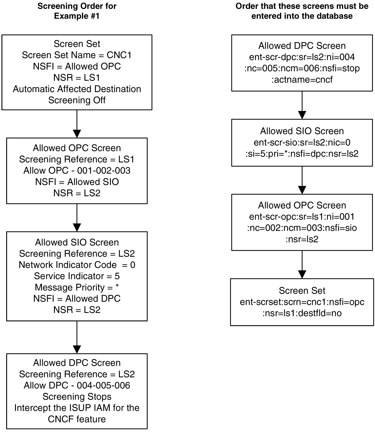

Figure 14-2 CNCF Gateway Screening Configuration - Example 1
img/r-configuring-eagle-5-iss-cncf-feature-dbags-fig1.jpg
Figure 14-3 CNCF Gateway Screening Configuration - Example 2
img/r-configuring-eagle-5-iss-cncf-feature-dbags-fig2.jpg
Figure 14-4 CNCF Gateway Screening Configuration - Example 3
img/r-configuring-eagle-5-iss-cncf-feature-dbags-fig3.jpg
Figure 14-5 CNCF Gateway Screening Configuration - Example 4
img/r-configuring-eagle-5-iss-cncf-feature-dbags-fig4.jpg

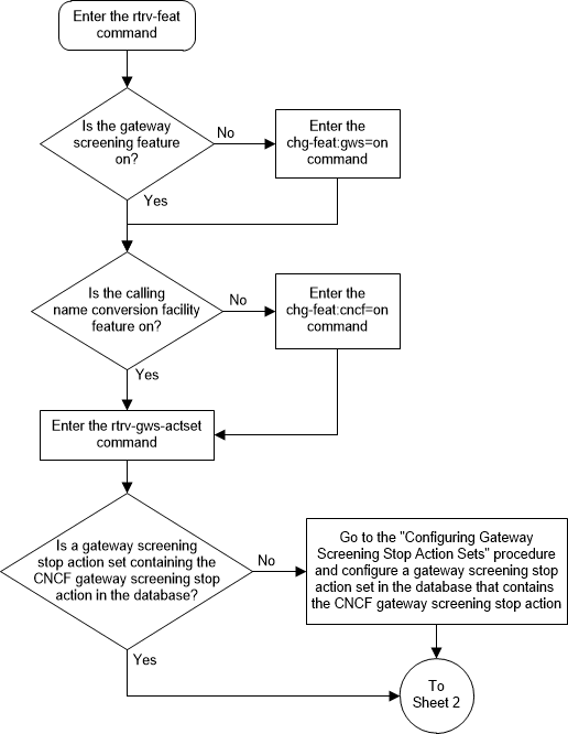

  1. Verify that the gateway screening and the calling name conversion facility features are on, by entering the rtrv-feat command.
    If the gateway screening feature is on, the GWS field should be set to on. If the calling name conversion facility feature is on, the CNCF field should be set to on. For this example, the gateway screening and the calling name conversion facility features are off.
    Thertrv-feat command output contains other fields that are not used by this procedure. If you wish to see all the fields displayed by thertrv-feat command, see thertrv-feat command description inCommands User's Guide.
    If both features are on, go to step 4. If the gateway screening feature is on, but the calling name conversion facility feature is off, go to step 3. If the gateway screening feature is off, go to step 2.
  2. If the gateway screening feature is not on, shown by the GWS = off entry in the rtrv-feat command output in step 1, turn the gateway screening feature on by entering this command.
    chg-feat:gws=on
    Once the gateway screening feature is turned on with thechg-feat command, it cannot be turned off.
    When the chg-feat has successfully completed, this message should appear.
    rlghncxa03w 06-10-25 15:26:30 GMT EAGLE5 36.0.0
    CHG-FEAT: MASP A - COMPLTD
  3. If the calling name conversion facility feature is not on, shown by the CNCF = off entry in the rtrv-feat command output in step 1, turn the calling name conversion facility feature on by entering this command.
    chg-feat:cncf=on
    Once the calling name conversion facility feature is turned on with thechg-feat command, it cannot be turned off.
    rlghncxa03w 06-10-25 15:27:30 GMT EAGLE5 36.0.0

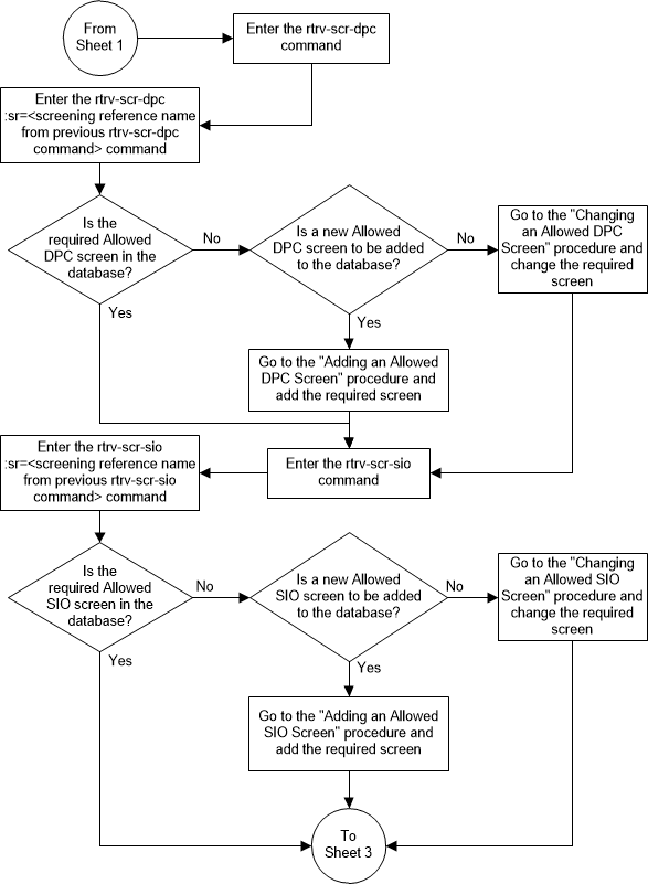

  4. Display the gateway screening stop action sets in the database with the rtrv-gws-actset command.
    This is an example of the possible output.
    rlghncxa03w 06-10-25 15:28:30 GMT EAGLE5 36.0.0
    ACT  ACT    ACT  ACT  ACT  ACT  ACT  ACT  ACT  ACT  ACT  ACT
    ID   NAME   1    2    3    4    5    6    7    8    9    10
    1    copy   copy
    2    rdct   rdct
    3    cr     copy rdct
    4    cncf   cncf
    5    cpcncf copy cncf
    6    cncfrd cncf rdct
    7    cpcfrd copy cncf rdct
    GWS action set table is (7 of 16) 44% full
    If the cncf gateway screening stop action is not shown in the rtrv-gws-actset command output, perform the Configuring Gateway Screening Stop Action Sets procedure to create a new gateway screening stop action set containing the cncf gateway screening stop action, or change an existing gateway screening stop action set to contain the cncf gateway screening stop action.
  5. Display all allowed DPC screens in the database using the rtrv-scr-dpc command.
    The following is an example of the possible output.
    rlghncxa03w 06-10-25 15:29:30 GMT EAGLE5 36.0.0
    SCREEN = ALLOWED DPC
    SR    REF  RULES
    IEC   YES     2
    WRD2  YES     1
    WRD4  YES     9
    If the necessary screening reference name is shown in the rtrv-scr-dpc command output, make sure the screening data you wish to enter is not already in the database by entering the rtrv-scr-dpc command with the screening reference name. For example, enter the rtrv-scr-dpc:sr=iec command.
    rlghncxa03w 06-10-25 15:30:30 GMT  EAGLE5 36.0.0
    SR    NI       NC       NCM      NSFI    NSR/ACT
    IEC   240      001      010      STOP    ------
    IEC   241      010      *        CGPA    cg04
    SR      NPC                      NSFI    NSR/ACT
    IEC     00235                    CGPA    cg04
    IEC     00240                    CGPA    cg01
    SR      ZONE   AREA     ID       NSFI    NSR/ACT
    IEC     1      003      4        BLKDPC  blk1
    IEC     1      003      5        STOP    ------
  6. If the required screen is not in the database, perform the Adding an Allowed DPC Screen procedure to add the required allowed DPC screen.
    For this example, enter the screening information in Table 14-2.
    Table 14-2 Example Gateway Screening Allowed DPC Configuration Table for the CNCF Feature
    Screening Reference NI NC NCM NSFI ACTNAME*
    ls2 004 005 006 Stop CNCF
    ls13 001 002 003 Stop CPCNCF
    ls13 007 008 009 Stop CNCFRD
    * The value of the actname parameter is shown in the rtrv-gws-actset command output example shown in step 4.
    If you wish to change an existing allowed DPC screen, instead of adding a new allowed DPC screen, perform the Changing an Allowed DPC Screen procedure to change an existing allowed DPC screen. For this example, change the screens with the screening information in Table 14-2.
  7. Display all allowed SIO screens in the database using the rtrv-scr-sio command.
    rlghncxa03w 06-10-25 15:31:30 GMT EAGLE5 36.0.0
    SCREEN = ALLOWED SIO
    SR    REF  RULES
    IEC   YES     2
    WRD2  YES     1
    WRD4  YES     9
    If the necessary screening reference name is shown in the rtrv-scr-sio command output, make sure the screening data you wish to enter is not already in the database by entering the rtrv-scr-sio command with the screening reference name. For example, enter the rtrv-scr-sio:sr=iec command.
    rlghncxa03w 06-10-25 15:32:30 GMT  EAGLE5 36.0.0
    SR    NIC  PRI  SI  H0     H1     NSFI    NSR/ACT
    IEC   2    0&&3 0   0      0      BLKDPC  WDB2
    IEC   2    0&&2 0   1      1      DPC     WDB3
    IEC   2    0&&1 0   2      2      STOP    ------
    IEC   2    0&&3 4   --     --     STOP    ------
    IEC   2    0&&2 1   *      *      DPC     WDB3
  8. If the required screen is not in the database, perform the Adding an Allowed SIO Screen procedure to add the required allowed SIO screen.
    For this example, enter the screening information in Table 14-3.
    Table 14-3 Example Gateway Screening Allowed SIO Configuration Table for the CNCF Feature
    Screening Reference NIC SI H0 H1 PRI NSFI NSR
    ls2 0 5 -- -- * dpc ls2
    ls13 0 5 -- -- * dpc ls13
    If you wish to change an existing allowed SIO screen, instead of adding a new allowed SIO screen, perform the Changing an Allowed SIO Screen procedure to change an existing allowed SIO screen. For this example, change the screens with the screening information in Table 14-3.
  9. Display all allowed OPC screens in the database using the rtrv-scr-opc command.
    rlghncxa03w 06-10-25 15:33:30 GMT EAGLE5 36.0.0
    SCREEN = ALLOWED OPC
    SR    REF  RULES
    IEC   YES     2
    WRD2  YES     1
    WRD4  YES     9
    If the necessary screening reference name is shown in the rtrv-scr-opc command output, make sure the screening data you wish to enter is not already in the database by entering the rtrv-scr-opc command with the screening reference name. For example, enter the rtrv-scr-opc:sr=iec command.
    rlghncxa03w 06-10-25 15:34:30 GMT  EAGLE5 36.0.0
    SR      NPC                      NSFI    NSR/ACT
    IEC     00235                    CGPA    cg04
    IEC     00240                    CGPA    cg01
    IEC     1      003      4        BLKOPC  blk1
  10. If the required screen is not in the database, perform the Adding an Allowed OPC Screen procedure to add the required allowed OPC screen.
    For this example, enter the screening information in Table 14-4.
    Table 14-4 Example Gateway Screening Allowed OPC Configuration Table for the CNCF Feature
    Screening Reference NI NC NCM NSFI NSR
    ls1 001 002 003 sio ls2
    ls2 004 005 006 sio ls13
    ls3 007 008 009 sio ls2
    If you wish to change an existing allowed OPC screen, instead of adding a new allowed OPC screen, perform the Changing an Allowed OPC Screen procedure to change an existing allowed OPC screen. For this example, change the screens with the screening information in Table 14-4.

  12. If the required screen set is not in the database, perform the Adding a Screen Set procedure to add the required screen set.
    For this example, enter the screening information in Table 14-5.
    Table 14-5 Example Gateway Screening Screen Set Configuration Table for the CNCF Feature
    Screen Set Name Next Screening Function Identifier Next Screening Reference DESTFLD
    cnc1 opc ls1 No
    cnc2 opc ls2 No
    cnc3 opc ls3 No

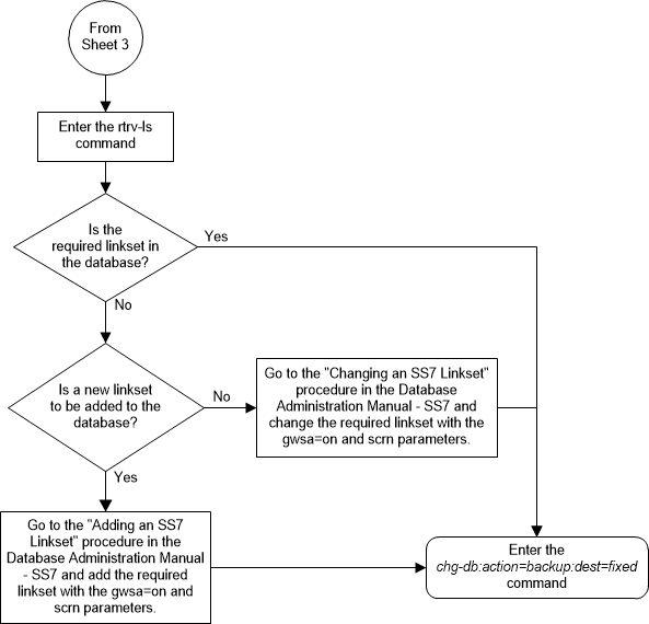

  13. Display the current linkset configuration using the rtrv-ls command.

  14. If the required linkset is not in the database, perform the Adding an SS7 Linkset in Database Administration - SS7 User's Guide to add the required linkset.
    For this example, enter the linkset information in Table 14-6.
    Table 14-6 Linkset Configuration Table for the CNCF Feature
    Linkset Name Linkset APC # LINKS LST GWSA GWSM SCRN
    ls1 001-002-003 2 B on off cnc1
    ls2 004-005-006 2 B on off cnc2
    ls3 007-008-009 2 B on off cnc3
    If you wish to change an existing linkset, instead of adding a new linkset, perform the Changing an SS7 Linkset procedure in Database Administration - SS7 User's Guide to change an existing linkset. For this example, change the linksets with the information in Table 14-6.
  15. Backup the new changes using the chg-db:action=backup:dest=fixed command.
    The following messages should appear, the active Maintenance and Administration Subsystem Processor (MASP) appears first.
    BACKUP (FIXED) : MASP A - Backup starts on active MASP.
    BACKUP (FIXED) : MASP A - Backup on active MASP to fixed disk complete.
    BACKUP (FIXED) : MASP A - Backup starts on standby MASP.
    BACKUP (FIXED) : MASP A - Backup on standby MASP to fixed disk complete.
Figure 14-6 Calling Name Conversion Facility Configuration - Sheet 1 of 4
img/cncf-configuration-1-240.png
Figure 14-7 Calling Name Conversion Facility Configuration - Sheet 2 of 4
img/cncf-configuration-2-300.png
Figure 14-8 Calling Name Conversion Facility Configuration - Sheet 3 of 4
img/cncf-configuration-3-300.png
Figure 14-9 Calling Name Conversion Facility Configuration - Sheet 4 of 4
img/cncf-configuration-4-300.png
