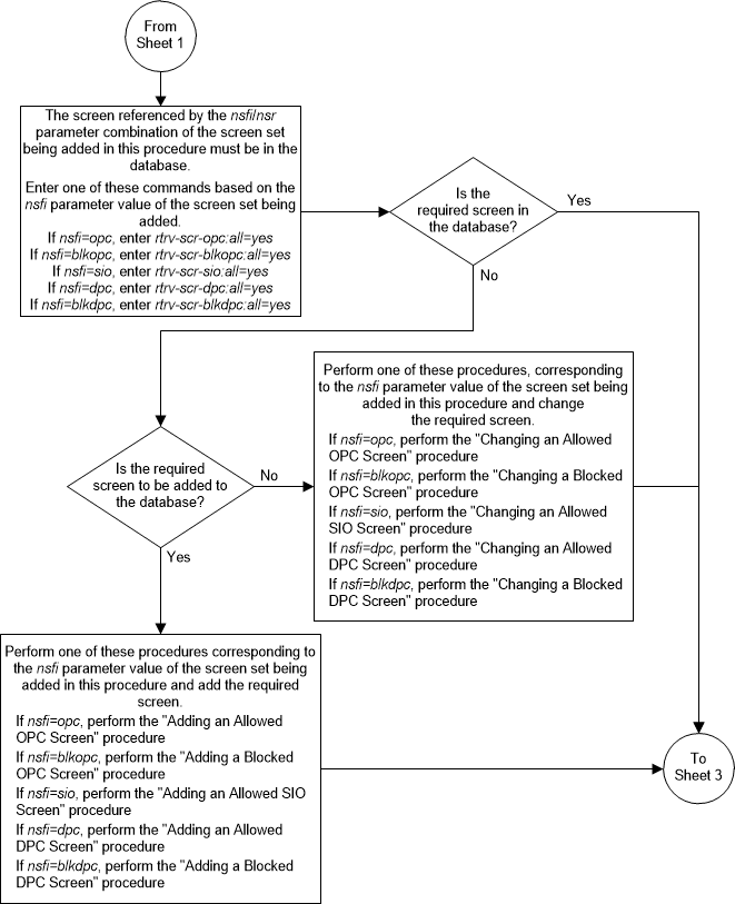

Verifying the Gateway Screening Configuration
Enter the following commands to verify that these screens are in the database.
  • rtrv-scr-opc:all=yes
  • rtrv-scr-blkopc:all=yes
  • rtrv-scr-sio:all=yes
  • rtrv-scr-dpc:all=yes
  • rtrv-scr-blkdpc:all=yes
Gateway Screening Configuration Procedures
If the desired screen is not in the database, perform one of these procedures to add the desired screen to the database or change an existing screen in the database.

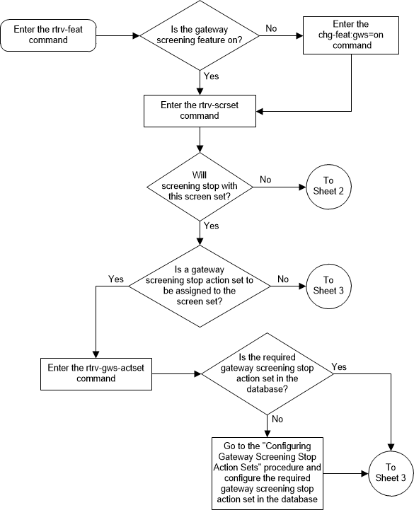

  1. Verify that the gateway screening feature is on, by entering the rtrv-feat command.
    If the gateway screening feature is on, the GWS field is set to on.
    The rtrv-feat command output contains other fields that are not used by this procedure. If you wish to see all the fields displayed by the rtrv-feat command, see the rtrv-feat command description in Commands User's Guide.
    If the gateway screening feature is on, shown by the entry GWS = on in the rtrv-feat command output, skip step 2, and go to step 3.
  2. Turn the gateway screening feature on by entering this command.
    chg-feat:gws=on
    Once the gateway screening feature is turned on with the chg-feat command, it cannot be turned off.
    The gateway screening feature must be purchased before you turn this feature on with the chg-feat command. If you are not sure if you have purchased the gateway screening feature, contact your Oracle Sales Representative or Account Representative.
    When the chg-feat has successfully completed, this message should appear.

  3. Display all the screen sets in the database using the rtrv-scrset command.
    The following is an example of the possible output.

    If a gateway screening stop action set is to be assigned to the screen set being added to the database, go to step 4.
    Step 4 verifies the gateway screening stop action set names in the database. The gateway screening stop action set names are assigned only if the NSFI of the screen set being added in this procedure is STOP. If the NSFI of the new screen set will be STOP, but a gateway screening stop action set name will not be assigned to the new screen set, skip steps 4 and 5 and go to step 6. If the NSFI of the new screen set is not STOP, skip step 4 and go to step 5.
  4. Display the gateway screening stop action sets in the database with the rtrv-gws-actset command.

    If the required gateway screening stop action set is not in the database, perform the Configuring Gateway Screening Stop Action Sets procedure to configure the required gateway screening stop action set.
    If the NSFI of the screen set being added in this procedure is STOP, skip step 5 and go to step 6.
  5. Enter the commands in the Verifying the Gateway Screening Configuration section to verify that the screen that will be specified by the NSFI/NSR parameter combination in step 6 is in the database.
    If the desired screen is not in the database, perform one of the procedures shown in the Gateway Screening Configuration Procedures section to add the desired screen to the database or change an existing screen in the database.

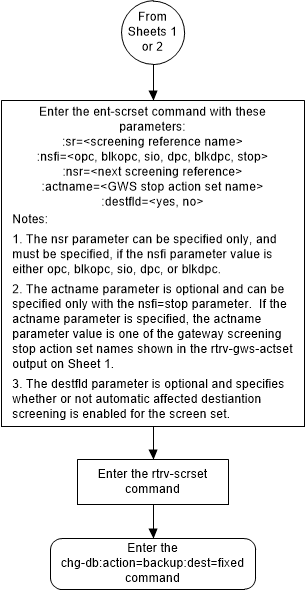

  6. Add a new screen set to the database using the ent-scrset command.
    If a gateway screening stop action is to be assigned to the screen set being added, enter the ent-scrset command with the nsfi=stop parameter and the actname parameter with the name of a gateway screening stop action set shown in the output of the rtrv-gws-actset command executed in step 4.
    For this example, enter these commands.
    ent-scrset:scrn=gws1:nsfi=opc:nsr=gws4:destfld=no
    A message similar to the following should appear.
    rlghncxa03w 06-10-25 15:27:30 GMT EAGLE5 36.0.0
    ENT-SCRSET: SCREEN SET AFFECTED - GWS1  1% FULL
    ENT-SCRSET: MASP A - COMPLTD

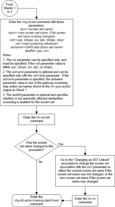

  8. Backup the new changes using the chg-db:action=backup:dest=fixed command.
    The following messages should appear, the active Maintenance and Administration Subsystem Processor (MASP) appears first.
    BACKUP (FIXED) : MASP A - Backup starts on active MASP.
    BACKUP (FIXED) : MASP A - Backup on active MASP to fixed disk complete.
    BACKUP (FIXED) : MASP A - Backup starts on standby MASP.
    BACKUP (FIXED) : MASP A - Backup on standby MASP to fixed disk complete.
Figure 13-1 Add a Screen Set - Sheet 1 of 3
img/ent-scrset-01-310.png
Figure 13-2 Add a Screen Set - Sheet 2 of 3
img/ent-scrset-02-310.png
Figure 13-3 Add a Screen Set - Sheet 2 of 3
img/ent-scrset-03-310.png

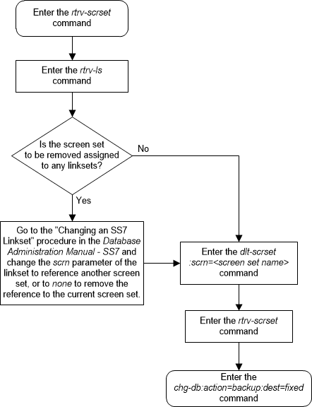

  2. The screen set to be removed cannot be referenced by a linkset.
    To verify this, enter the rtrv-ls command. If the output shows a reference to the screen set to be removed, perform the Changing an SS7 Linkset procedure in the Database Administration Manual – SS7 and change the scrn parameter to reference another screen set, or to none to remove the reference to the screen set.
  3. Remove the screen set from the database using the dlt-scrset command.
    For this example, enter this command.
    dlt-scrset:scrn=gws1

Figure 13-4 Remove a Screen Set
img/dlt-scrset-132578.png

  1. Display all screen sets in the database using the rtrv-scrset command.
    rlghncxa03w 06-10-25 15:25:30 GMT EAGLE5 36.0.0
    ENTIRE GWS DATABASE IS 1% FULL
    CDPA + AFTPC TABLES ARE 1% FULL
    THERE ARE 242 SCREEN SETS AVAILABLE
    THE FOLLOWING ARE OVER 80% FULL:
    SCRN  NSFI    NSR/ACT  FULL  RULES  TABLES  DESTFLD
    fld1  OPC     fld2       1%     5   4       NO
    gws1  OPC     gws4       1%     9   7       NO
    gws2  BLKOPC  gws5       1%     5   4       NO
    isp1  OPC     isp1       1%     6   4       NO
    ls01  SIO     ls02       1%     3   3       YES
    ss01  OPC     opc1      51%  2075   22      YES
    ss02  OPC     opc2       2%    75   22      YES
    ss03  OPC     opc3       2%    75   22      YES
    ss04  OPC     opc1      51%  2075   22      NO
    ss07  OPC     opc1      51%  2075   22      YES
    ss09  OPC     opc1      51%  2075   22      NO
    ss28  OPC     opc1      51%  2075   22      YES
    tup1  OPC     tup1       1%     8   5       NO
    wrd1  DPC     iec        1%     6   5       YES
  2. The screen set being changed cannot be referenced by a linkset.
    To verify this, enter the rtrv-ls command. If the output shows a reference to the screen set to be removed, perform the Changing an SS7 Linkset procedure in Database Administration - SS7 User's Guide and change the scrn parameter to reference another screen set, or to none to remove the reference to the screen set.
    If a new gateway screening stop action set will not be assigned to the screen set being changed, skip step 3 and go to step 4.
  3. Display the gateway screening stop action sets in the database with the rtrv-gws-actset command.
    This is an example of the possible output.
    rlghncxa03w 06-10-25 15:26:30 GMT EAGLE5 36.0.0
    ACT  ACT    ACT  ACT  ACT  ACT  ACT  ACT  ACT  ACT  ACT  ACT
    ID   NAME   1    2    3    4    5    6    7    8    9    10
    1    copy   copy
    2    rdct   rdct
    3    cr     copy rdct
    4    cncf   cncf
    5    cpcncf copy cncf
    6    cncfrd cncf rdct
    7    cpcfrd copy cncf rdct
    GWS action set table is (7 of 16) 44% full
    If the required gateway screening stop action set is not in the database, go to the Configuring Gateway Screening Stop Action Sets procedure and configure the required gateway screening stop action set.
    If the NSFI of the screen set being changed in this procedure will be STOP, or if the NSFI of the screen set is not being changed, skip step 4 and go to step 5.
  4. Enter the commands in the Verifying the Gateway Screening Configuration section to verify that the screen that will be specified by the NSFI/NSR parameter combination in step 5 is in the database.
  5. Change the attributes of a screen set using the chg-scrset command.
    If a gateway screening stop action is to be assigned to the screen set being changed, enter the chg-scrset command with the nsfi=stop parameter and the actname parameter with the name of a gateway screening stop action set shown in the output of the rtrv-gws-actset command executed in step 2.
    chg-scrset:scrn=ls01:nscrn=ls05:nsfi=blkopc:nsr=ls08
    CHG-SCRSET: SCREEN SET AFFECTED - LS01  1% FULL
    CHG-SCRSET: MASP A - COMPLTD
  6. Verify the changes using the rtrv-scrset command.
    rlghncxa03w 06-10-25 15:28:30 GMT EAGLE5 36.0.0
    ls05  BLKOPC  ls08       3%    45   14      YES
  7. Backup the new changes using the chg-db:action=backup:dest=fixed command.

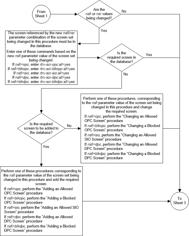

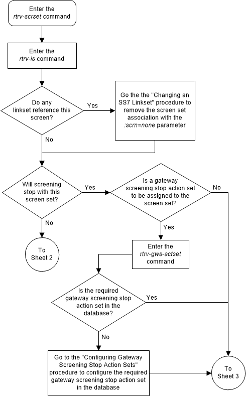

Figure 13-5 Change a Screen Set - Sheet 1 of 3
img/chg-scrset-01-db-manual-ref.png
Figure 13-6 Change a Screen Set - Sheet 2 of 3
img/chg-scrset-02-310.png
Figure 13-7 Change a Screen Set - Sheet 3 of 3
img/chg-scrset-03-db-manual-ref.png
