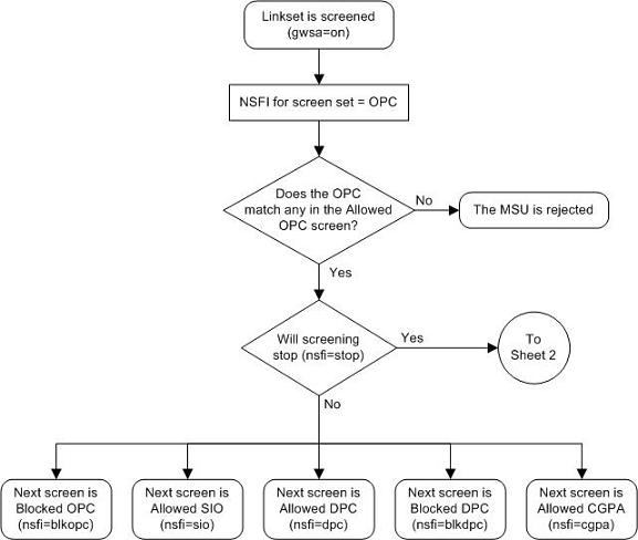

The allowed originating point code (OPC) screen identifies a set of OPC's that are allowed to send SS7 messages into the network. The gray shaded areas in Figure 12-4 shows the fields of the SS7 message that are checked by the allowed OPC screening function.
Gateway Screening Actions
If a match is not found, the message is discarded.
If a match is found, the nsfi is examined to determine the next step in the screening process. If the nsfi value is any value other than stop, the next screening reference (nsr) is identified and the screening process continues to the next screen identified by the nsfi and nsr parameter values.
If the nsfi is equal to stop, the screening process stops and the message is processed. If a gateway screening stop action set is specified with the screen, shown by the actname parameter value, the message is processed according to the gateway screening stop actions that are assigned to the gateway screening stop action set.

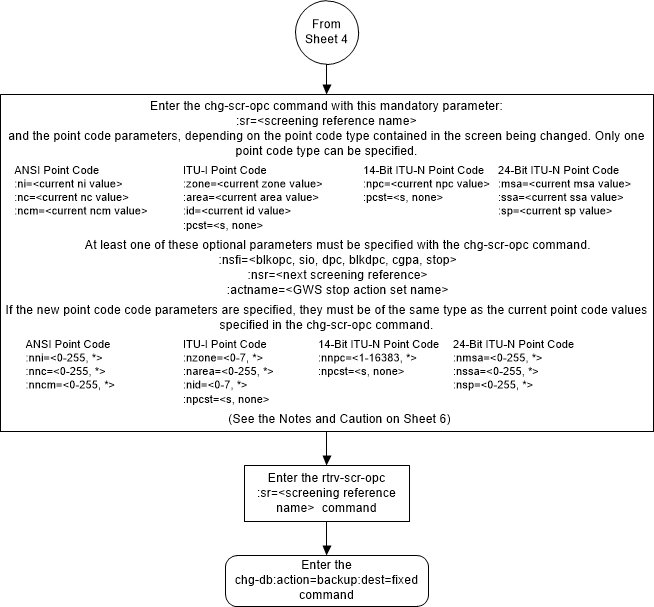

Allowed OPC Screening Actions

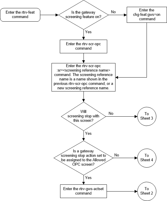

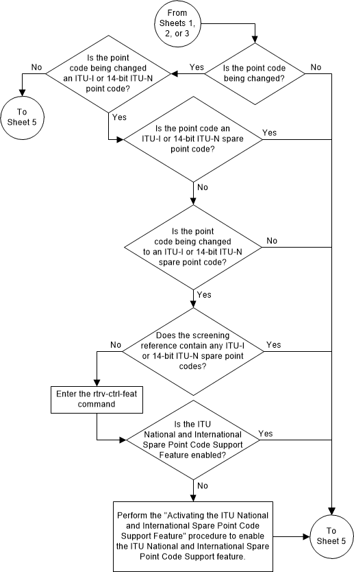

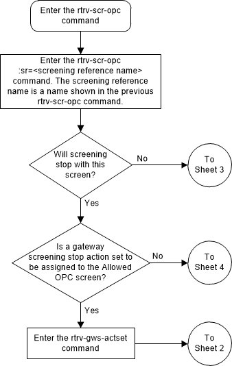

Figure 12-1 through Figure 12-3 show the screening actions of the allowed OPC screen.
Figure 12-1 Allowed OPC Screening Actions - Sheet 1 of 3
img/allowed-opc-1-231.jpg
Figure 12-2 Allowed OPC Screening Actions - Sheet 2 of 3
img/gws-stop-actions-01-140964.jpg
Figure 12-3 Allowed OPC Screening Actions - Sheet 3 of 3
img/gws-stop-actions-02-140964.jpg

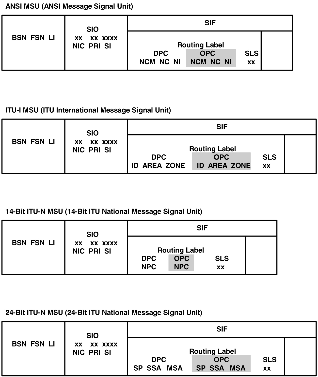

Figure 12-4 Allowed OPC Screening Functions
img/c-introduction-10-dbags-fig5.jpg

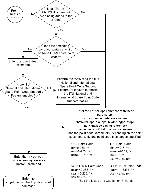

Adding an Allowed OPC Screen
This procedure is used to add an allowed originating point code (OPC) screen to the database using the ent-scr-opc command. The parameters used by the ent-scr-opc command are shown in the Gateway Screening Attributes section. The general rules that apply to configuring gateway screening entities are shown in the Gateway Screening Configuration section.
The examples in this procedure are used to add the allowed OPC screen data shown in Table 12-1 and based on the example configurations shown in Figure 2-3, Figure 2-7, and Figure 2-9.

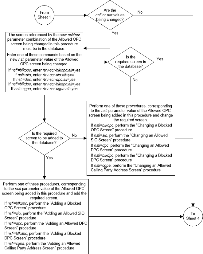

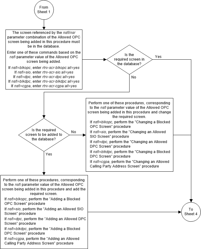

Verifying the Gateway Screening Configuration
Enter the following commands to verify that these screens are in the database.
  • rtrv-scr-blkopc:all=yes
  • rtrv-scr-sio:all=yes
  • rtrv-scr-dpc:all=yes
  • rtrv-scr-blkdpc:all=yes
  • rtrv-scr-cgpa:all=yes
Gateway Screening Configuration Procedures
If the desired screen is not in the database, perform one of these procedures to add the desired screen to the database or change an existing screen in the database.

  3. Display all allowed OPC screens in the database using the rtrv-scr-opc command.
    The following is an example of the possible output.

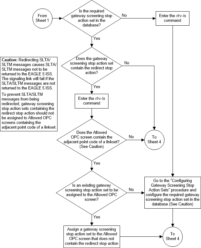

    If a gateway screening stop action set is to be assigned to the allowed OPC screen being added to the database, go to step 4.
    Step 4 verifies the gateway screening stop action set names in the database. The gateway screening stop action set names are assigned only if the NSFI of the screen being added in this procedure is STOP. If the NSFI of the new screen will be STOP, but a gateway screening stop action set name will not be assigned to the new screen, skip steps 4, 5, and 6, and go to step 7. If the NSFI of the new screen is not STOP, skip steps 4 and 5, and go to step 6.
  4. Display the gateway screening stop action sets in the database with the rtrv-gws-actset command.
    This is an example of the possible output.
    rlghncxa03w 06-10-25 15:27:30 GMT EAGLE5 36.0.0
    ACT  ACT    ACT  ACT  ACT  ACT  ACT  ACT  ACT  ACT  ACT  ACT
    ID   NAME   1    2    3    4    5    6    7    8    9    10
    1    copy   copy
    2    rdct   rdct
    3    cr     copy rdct
    4    cncf   cncf
    5    cpcncf copy cncf
    6    cncfrd cncf rdct
    7    cpcfrd copy cncf rdct
    GWS action set table is (7 of 16) 44% full
    If the required gateway screening stop action set is not in the database, perform the Configuring Gateway Screening Stop Action Sets procedure to configure the required gateway screening stop action set.
    If the gateway screening stop action set being assigned to theAllowed OPC screen does not contain the redirect stop action, skip step 5 and go to step 6.

    If the point code being added in this procedure is not an ITU-I or 14-bit ITU-N spare point code, skip step 7 and to step 8.
    If the point code being added in this procedure is an ITU-I or 14-bit ITU-N spare point code and the screening reference contains ITU-I or 14-bit ITU-N spare point codes, skip step 7 and go to step 8.
  7. Display the status of the ITU National and International Spare Point Code Support feature by entering the rtrv-ctrl-feat command with the ITU National and International Spare Point Code Support feature part number.
    Enter this command.
    rtrv-ctrl-feat:partnum=893013601
    rlghncxa03w 06-10-25 15:25:30 GMT EAGLE5 36.0.0
    The following features have been permanently enabled:
    Feature Name              Partnum   Status Quantity
    Spare Point Code Support  893013601 on     ----
    The following features have been temporarily enabled:
    Feature Name              Partnum   Status Quantity   Trial Period Left
    Zero entries found.
    The following features have expired temporary keys:
    Zero entries found.
    If the ITU National and International Spare Point Code Support feature is enabled, go to step 8.
    If the ITU National and International Spare Point Code Support feature is not enabled, perform the “Activating the ITU National and International Spare Point Code Support Feature” procedure in Database Administration - SS7 User's Guide to enable the ITU National and International Spare Point Code Support feature as required. After the feature has been enabled, go to step 8.
  8. Add a new allowed OPC screen to the database using the ent-scr-opc command.
    If a gateway screening stop action is to be assigned to the allowed OPC screen being changed, enter the ent-scr-opc command with the nsfi=stop parameter and the actname parameter with the name of a gateway screening stop action set shown in the output of the rtrv-gws-actset command executed in step 4.
    Caution:
    Redirecting SLTA/SLTM messages preventsSLTA/SLTM messages from being returned to the EAGLE. The signaling link carrying these messages will fail if these messages are not returned to the EAGLE. To prevent SLTA/SLTM messages from being redirected, gateway screening stop action sets containing the redirect stop action should not be assigned to Allowed OPC screens containing the adjacent point code of a linkset, shown in step 5.
    The following list contains the values for ni, nc, ncm, zone, area, id, npc, msa, ssa, and sp parameters:
    • ni – 0 - 255 or an asterisk (*)
    • nc – 0 - 255 or an asterisk (*)
    • ncm – 0 - 255 or an asterisk (*)
    • zone – 0 - 7 or an asterisk (*)
    • area – 0 - 255 or an asterisk (*)
    • id – 0 - 7 or an asterisk (*)
    • npc – 1 - 16383 or an asterisk (*)
    • msa – 0 - 255 or an asterisk (*)
    • ssa – 0 - 255 or an asterisk (*)
    • sp – 0 - 255 or an asterisk (*)
    A range of values can be specified for the ni, nc, and ncm parameters. See the “Specifying a Range of Values” section for more information on how the asterisk and a range of values are used for the ni, nc, and ncm parameters.
    To add a spare point code to the allowed OPC screen, the pcst=s parameter must be specified. To add a non-spare point code to the allowed OPC screen, the pcst parameter does not have to be specified. If the pcst parameter is specified for a screen containing an ITU-I or 14-bit ITU-N non-spare point code, the value must be none.
    For this example, enter these commands.
    ent-scr-opc:sr=gws4:ni=001:nc=001:ncm=001:nsfi=blkopc:nsr=gws3
    A message similar to the following should appear.
    rlghncxa03w 06-10-25 15:28:30 GMT  EAGLE5 36.0.0
    ENT-SCR-OPC: SCREEN SET AFFECTED - GWS4  1% FULL
    ENT-SCR-OPC: MASP A - COMPLTD

Figure 12-5 Add an Allowed OPC Screen - Sheet 1 of 5
img/ent-scr-opc-01-314.png
Figure 12-6 Add an Allowed OPC Screen - Sheet 2 of 5
img/ent-scr-opc-02-331.png
Figure 12-7 Add an Allowed OPC Screen - Sheet 3 of 5
img/ent-scr-opc-03-314.png
Figure 12-8 Add an Allowed OPC Screen - Sheet 4 of 5
img/ent-scr-opc-04-db-manual-ref.png
Figure 12-9 Add an Allowed OPC Screen - Sheet 5 of 5
img/ent-scr-opc-05-db-manual-ref.png

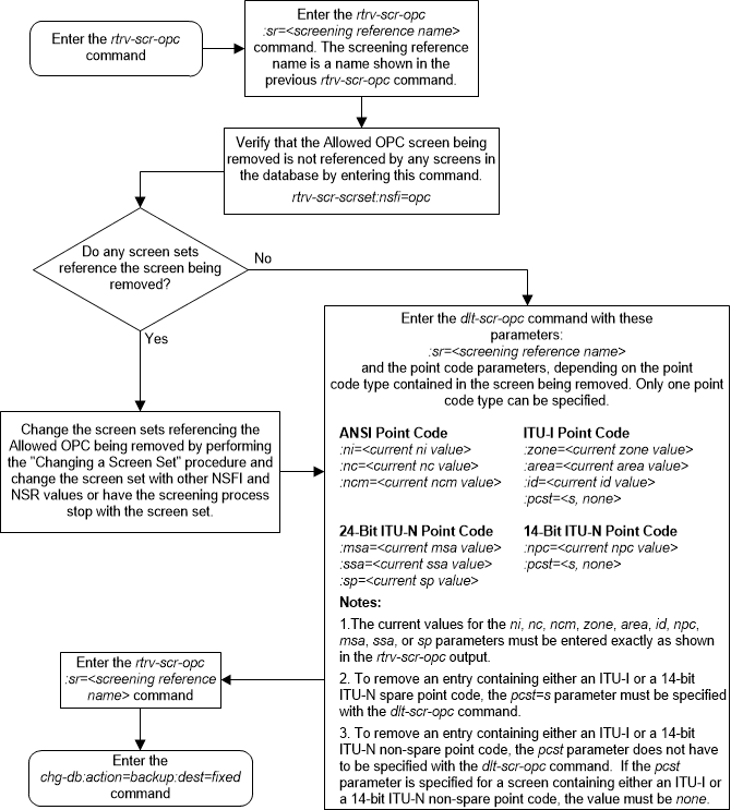

Removing an Allowed OPC Screen
This procedure is used to remove an allowed originating point code (OPC) screen from the database using the dlt-scr-opc command. The parameters used by the dlt-scr-opc command are shown in the Gateway Screening Attributes section. The general rules that apply to configuring gateway screening entities are shown in the Gateway Screening Configuration section.
The example in this procedure removes the allowed OPC screen gws4 from the database.
If you using multiple-part ITU national point codes with gateway screening, see the 14-Bit ITU National Point Code Formats section.
The allowed OPC screen can only be referenced by a screen set.
Enter the rtrv-scrset:nsfi=opc command to verify that none of the screen sets reference the allowed OPC screen being removed from the database.
To change the NSFI of any of the screen sets, perform the Changing a Screen Set procedure.
  1. Display the allowed OPC screens in the database using the rtrv-scr-opc command.
    SCREEN = ALLOWED OPC
    SR    REF  RULES
    GWS4  YES     1
    IEC   YES     6
    ISP1  YES     1
    TUP1  YES     1
    WRD2  YES     1
    WRD4  YES     9
    From the rtrv-scr-opc output, display the allowed OPC screen you wish to remove using the rtrv-scr-opc command with the screening reference name. For this example, enter this command.
    rtrv-scr-opc:sr=gws4
    SR    NI       NC       NCM      NSFI    NSR/ACT
    GWS4  001      001      001      BLKOPC  GWS7
  2. Enter the rtrv-scrset:nsfi=opc command to verify that none of the screen sets reference the allowed OPC screen being removed from the database.
  3. Remove the allowed OPC screen from the database using the dlt-scr-opc command with the screening reference name shown in the rtrv-scr-opc output in step 1 and with the point code parameter values (ni, nc, ncm, or zone, area, id, or npc, or msa, ssa, sp) of the screen being removed from the database. The values for these parameters must be entered exactly as shown in the rtrv-scr-opc output.
    To remove an entry containing either an ITU-I or a 14-bit ITU-N spare point code, the pcst=s parameter must be specified with the dlt-scr-opc command.
    To remove an entry containing either an ITU-I or a 14-bit ITU-N non-spare point code, the pcst parameter does not have to be specified with the dlt-scr-opc command. If the pcst parameter is specified, the value must be none.
    dlt-scr-opc:sr=gws4:ni=001:nc=001:ncm=001
    rlghncxa03w 06-10-25 15:26:30 GMT  EAGLE5 36.0.0
    DLT-SCR-OPC: SCREEN SET AFFECTED - GWS4  0% FULL
    DLT-SCR-OPC: MASP A - COMPLTD
  4. Verify the changes using the rtrv-scr-opc command with the screening reference name used in step 3.
    E2573 Cmd Rej: SR or NSR does not reference an existing SR
    This message shows that the specified screening reference name is not in the database and the action of the dlt-scr-opc command in step 3 was successful. If the specified screening reference name contained more than one entry when the dlt-scr-opc command was executed in step 3, the rtrv-scr-opc:sr= command output would show the remaining entries in the screening reference instead of error message E2573.
  5. Backup the new changes using the chg-db:action=backup:dest=fixed command.
    The following messages should appear, the active Maintenance and Administration Subsystem Processor (MASP) appears first.
    BACKUP (FIXED) : MASP A - Backup starts on active MASP.
    BACKUP (FIXED) : MASP A - Backup on active MASP to fixed disk complete.
    BACKUP (FIXED) : MASP A - Backup starts on standby MASP.
    BACKUP (FIXED) : MASP A - Backup on standby MASP to fixed disk complete.

    Caution:
    Redirecting SLTA/SLTM messages prevents SLTA/SLTM messages from being returned to the EAGLE. The signaling link carrying these messages will fail if these messages are not returned to the EAGLE. To prevent SLTA/SLTM messages from being redirected, gateway screening stop action sets containing the redirect stop action should not be assigned to Allowed OPC screens containing the adjacent point code of a linkset.

  4. Enter the commands in the Verifying the Gateway Screening Configuration section to verify that the screen that will be specified by the NSFI/NSR parameter combination in step 6 is in the database.
    If the desired screen is not in the database, perform one of the procedures shown in the Gateway Screening Configuration Procedures section to add the desired screen to the database or change an existing screen in the database.

  6. Change the attributes for the allowed OPC using the chg-scr-opc command.
    If a gateway screening stop action is to be assigned to the allowed OPC screen being changed, enter the chg-scr-opc command with the nsfi=stop parameter and the actname parameter with the name of a gateway screening stop action set shown in the output of the rtrv-gws-actset command executed in step 2.
    Caution:
    Redirecting SLTA/SLTM messages prevents SLTA/SLTM messages from being returned to the EAGLE. The signaling link carrying these messages will fail if these messages are not returned to the EAGLE. To prevent SLTA/SLTM messages from being redirected, gateway screening stop action sets containing the redirect stop action should not be assigned to Allowed OPC screens containing the adjacent point code of a linkset, shown in step 3.
    The current values for the ni, nc, ncm, zone, area, id, npc, msa, ssa, and sp parameters must be entered exactly as shown in the rtrv-scr-opc output in step 1.
    The following list contains the values for the nni, nnc, nncm, nzone, narea, nid, and nnpc parameters:
    • nni – 0 - 255 or an asterisk (*)
    • nnc – 0 - 255 or an asterisk (*)
    • nncm – 0 - 255 or an asterisk (*)
    • nzone – 0 - 7 or an asterisk (*)
    • narea – 0 - 255 or an asterisk (*)
    • nid – 0 - 7 or an asterisk (*)
    • nnpc – 1 - 16383 or an asterisk (*)
    • nmsa – 0 - 255 or an asterisk (*)
    • nssa – 0 - 255 or an asterisk (*)
    • nsp – 0 - 255 or an asterisk (*)
    A range of values can be specified for the nni, nnc, and nncm parameters. See the Specifying a Range of Values section for more information on how the asterisk and a range of values are used for the nni, nnc, and nncm parameters.
    To change an ITU-I or 14-bit ITU-N spare point code to a non-spare point code, both the pcst=s and npcst=none parameters must be specified with the chg-scr-opc command.
    To change an ITU-I or 14-bit ITU-N non-spare point code to a spare point code, the npcst=s parameter must be specified with the chg-scr-opc command. The pcst parameter does not have to be specified.
    If the current point code in the screen being changed is either an ITU-I or 14-bit ITU-N spare point code, the pcst=s parameter must be specified with the chg-scr-opc command.
    If the current point code in the screen being changed is either an ITU-I or 14-bit ITU-N non-spare point code, the pcst parameter does not have to be specified with the chg-scr-opc command. If the pcst parameter is specified for a screen containing either an ITU-I or 14-bit ITU-N non-spare point code, the pcst parameter value must be none.

Figure 12-11 Change an Allowed OPC Screen - Sheet 1 of 6
img/chg-scr-opc-01-314.png

Figure 12-13 Change an Allowed OPC Screen - Sheet 2 of 6
img/chg-scr-opc-03-314.png
Figure 12-14 Change an Allowed OPC Screen - Sheet 2 of 6
img/chg-scr-opc-04-db-manual-ref.png
Figure 12-15 Change an Allowed OPC Screen - Sheet 2 of 6
img/chg-scr-opc-05-318.png
