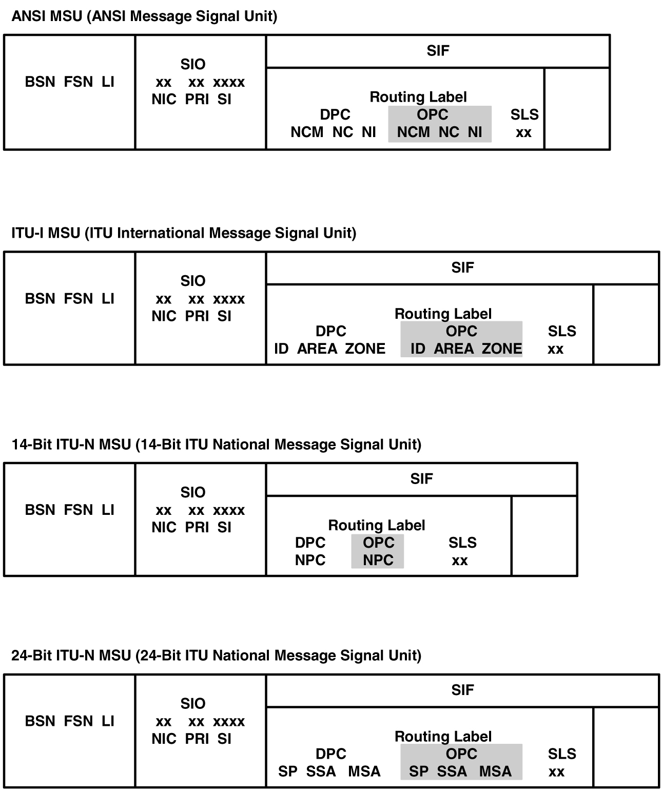

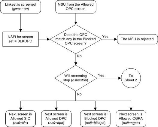

The blocked OPC screen identifies OPC's that are not allowed to send SS7 messages into the network. The gray shaded areas in Figure 11-4 shows the fields of the SS7 message that are checked by the blocked OPC screening function.
Gateway Screening Actions
If a match is found, the nsfi is equal to fail, the message is discarded and no further screening takes place.
If a match is not found, the nsfi is examined to determine the next step in the screening process. If the nsfi value is any value other than stop, the next screening reference (nsr) is identified and the screening process continues to the next screen identified by the nsfi and nsr parameter values.
If the nsfi is equal to stop, the screening process stops and the message is processed. If a gateway screening stop action set is specified with the screen, shown by the actname parameter value, the message is processed according to the gateway screening stop actions that are assigned to the gateway screening stop action set.

Blocked OPC Screening Actions
Figure 11-1 through Figure 11-3 show the screening actions of the blocked OPC screen.

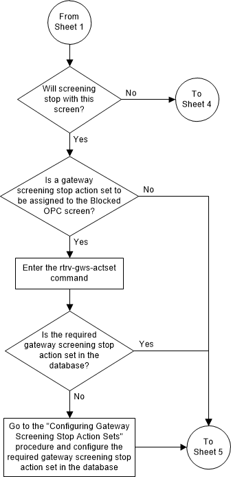

    If a gateway screening stop action set is to be assigned to the blocked OPC screen being added to the database, go to step 4.
    Step 4 verifies the gateway screening stop action set names in the database. The gateway screening stop action set names are assigned only if the NSFI of the screen being added in this procedure is STOP. If the NSFI of the new screen will be STOP, but a gateway screening stop action set name will not be assigned to the new screen, skip steps 4 and 5 and go to step 6. If the NSFI of the new screen is not STOP, skip step 4 and go to step 5.
  4. Display the gateway screening stop action sets in the database with the rtrv-gws-actset command.

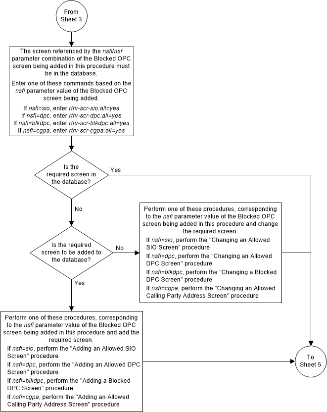

    If the required gateway screening stop action set is not in the database, perform the Configuring Gateway Screening Stop Action Sets procedure to configure the required gateway screening stop action set.
    If theNSFI of the screen being added in this procedure is STOP or FAIL, skip step 5 and go to step 6.
  5. Enter the commands in the Verifying the Gateway Screening Configuration section to verify that the screen that will be specified by the NSFI/NSR parameter combination in step 7 is in the database.
    If the desired screen is not in the database, perform one of the procedures shown in the Gateway Screening Configuration Procedures section to add the desired screen to the database or change an existing screen in the database.

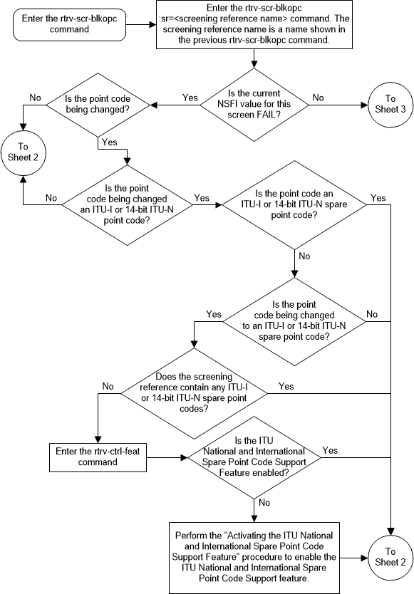

  6. Display the status of the ITU National and International Spare Point Code Support feature by entering the rtrv-ctrl-feat command with the ITU National and International Spare Point Code Support feature part number.
    If the point code being added in this procedure is not an ITU-I or 14-bit ITU-Nspare point code, skip this step and to step 7.
    If the point code being added in this procedure is an ITU-I or 14-bit ITU-N spare point code and the screening reference contains ITU-I or 14-bit ITU-N spare point codes, skip this step and go to step 7.
    Enter this command.
    rtrv-ctrl-feat:partnum=893013601
    This is an example of the possible output.
    rlghncxa03w 06-10-25 15:25:30 GMT EAGLE5 36.0.0
    The following features have been permanently enabled:
    Feature Name              Partnum   Status Quantity
    Spare Point Code Support  893013601 on     ----
    The following features have been temporarily enabled:
    Feature Name              Partnum   Status Quantity   Trial Period Left
    Zero entries found.
    The following features have expired temporary keys:
    Zero entries found.
    If the ITU National and International Spare Point Code Support feature is enabled, go to step 7.
    If the ITU National and International Spare Point Code Support feature is not enabled, perform the “Activating the ITU National and International Spare Point Code Support Feature” procedure in Database Administration - SS7 User's Guide to enable the ITU National and International Spare Point Code Support feature as required. After the feature has been enabled, go to step 7.

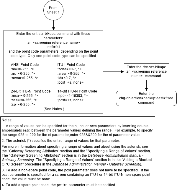

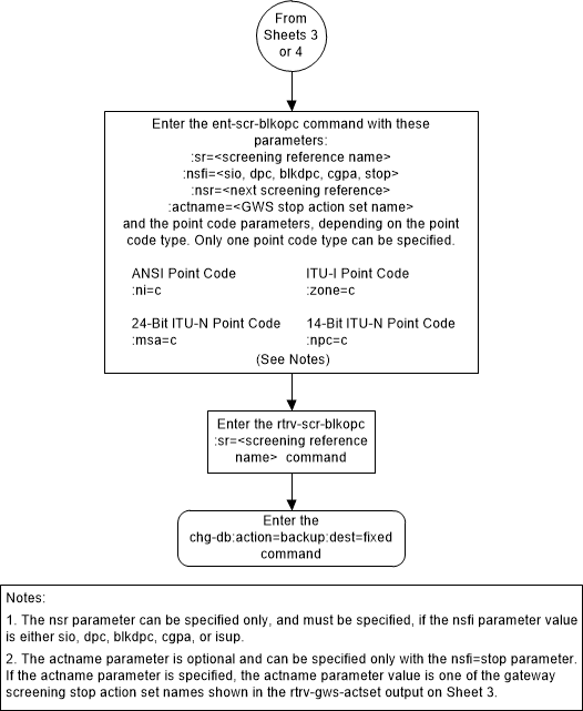

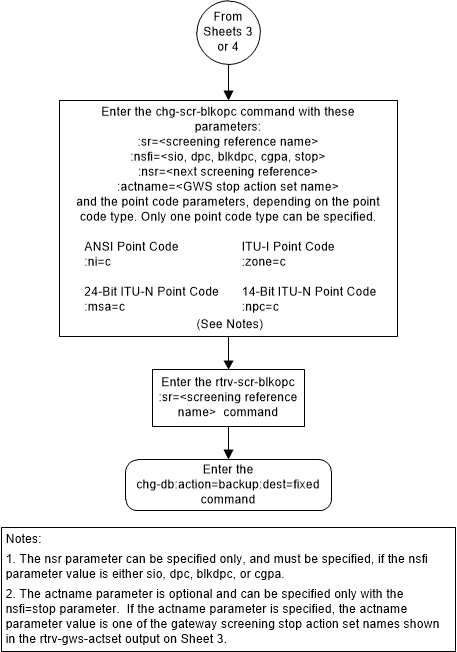

  7. Add a new blocked OPC screen to the database using the ent-scr-blkopc command.
    If a gateway screening stop action is to be assigned to the blocked OPC screen being changed, enter the ent-scr-blkopc command with the nsfi=stop parameter and the actname parameter with the name of a gateway screening stop action set shown in the output of the rtrv-gws-actset command executed in step 4. The following list contains the values for ni, nc, ncm, zone, area, id, npc, msa, ssa, and sp parameters:
    • ni – 0 - 255, c, or an asterisk (*)
    • nc – 0 - 255, c, or an asterisk (*)
    • ncm – 0 - 255, c, or an asterisk (*)
    • zone – 0 - 7, c, or an asterisk (*)
    • area – 0 - 255, c, or an asterisk (*)
    • id – 0 - 7, c, or an asterisk (*)
    • npc – 1 - 16383, c, or an asterisk (*)
    • msa – 0 - 255, c, or an asterisk (*)
    • ssa – 0 - 255, c, or an asterisk (*)
    • sp – 0 - 255, c, or an asterisk (*)
    A range of values can be specified for the ni, nc, and ncm parameters. See the “Specifying a Range of Values” section for more information on how the asterisk and a range of values are used for the ni, nc, and ncm parameters.
    To add a spare point code to the blocked OPC screen, the pcst=s parameter must be specified. To add a non-spare point code to the blocked OPC screen, the pcst parameter does not have to be specified. If the pcst parameter is specified for a screen containing an ITU-I or 14-bit ITU-N non-spare point code, the value must be none. The pcst parameter cannot be used with the zone=c or npc=c parameters.
    For this example, enter these commands.
    ent-scr-blkopc:sr=gws5:zone=c:area=c:id=c:nsfi=sio:nsr=iec

    A message similar to the following should appear.
    rlghncxa03w 06-10-25 15:34:30 GMT  EAGLE5 36.0.0
    ENT-SCR-BLKOPC: SCREEN SET AFFECTED - FLD3  1% FULL
    ENT-SCR-BLKOPC: MASP A - COMPLTD
    ent-scr-blkopc:sr=isp1:ni=c:nc=c:ncm=c:nsfi=sio:nsr=isp1
    rlghncxa03w 06-10-25 15:33:30 GMT  EAGLE5 36.0.0
    ENT-SCR-BLKOPC: SCREEN SET AFFECTED - ISP1  1% FULL
    ent-scr-blkopc:sr=isp1:ni=025:nc=025:ncm=025:nsfi=fail

Figure 11-5 Add a Blocked OPC Screen - Sheet 1 of 5
img/ent-scr-blkopc-01-db-manual-ref.png
Figure 11-6 Add a Blocked OPC Screen - Sheet 2 of 5
img/ent-scr-blkopc-02-db-manual-ref.bmp
Figure 11-7 Add a Blocked OPC Screen - Sheet 3 of 5
img/ent-scr-blkopc-03-318.png
Figure 11-8 Add a Blocked OPC Screen - Sheet 4 of 5
img/ent-scr-blkopc-04-318.png
Figure 11-9 Add a Blocked OPC Screen - Sheet 5 of 5
img/ent-scr-blkopc-05-318.png

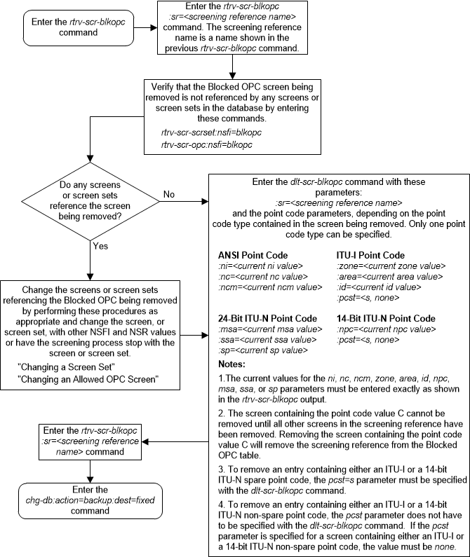

Removing a Blocked OPC Screen
This procedure is used to remove a blocked originating point code (OPC) screen from the database using the dlt-scr-blkopc command. The parameters used by the dlt-scr-blkopc command are shown in the Gateway Screening Attributes section. The general rules that apply to configuring gateway screening entities are shown in the Gateway Screening Configuration section.
The example in this procedure removes the blocked OPC screen iec with the point code 240-001-010 from the database.
If you using multiple-part ITU national point codes with gateway screening, see the 14-Bit ITU National Point Code Formats section.
The c-c-c entry cannot be removed from the blocked OPC screen unless all other entries in the blocked OPC screen have been removed. The c-c-c entry cannot be removed from the blocked OPC screen if other screens reference the blocked OPC screen. If the last entry (c-c-c) in the blocked OPC screen is removed, the blocked OPC screen is removed. The blocked OPC screen can be referenced by one of the following screens.
  • Screen Set
  • Allowed OPC
Enter the following commands to verify that none of these screens reference the blocked OPC screen being removed from the database.
  • rtrv-scrset:nsfi=blkopc
  • rtrv-scr-opc:nsfi=blkopc
To change the NSFI of any of these screens, perform one of these procedures.
  1. Display the blocked OPC screens in the database using the rtrv-scr-blkopc command.
    The following is an example of the possible output.
    SCREEN = BLOCKED DPC
    SR    REF  RULES
    IEC   YES     6
    ISP1  YES     2
    WRD2  YES     2
    WRD3  NO      4
    WRD4  YES     9
    From the rtrv-scr-blkopc output, display the blocked OPC screen you wish to remove using the rtrv-scr-blkopc command with the screening reference name. For this example, enter this command.
    rtrv-scr-blkopc:sr=iec
    SCREEN = BLOCKED OPC
    SR    NI       NC       NCM      NSFI    NSR/ACT
    IEC   240      001      010      FAIL    ------
    IEC   241      010      *        FAIL    ------
    SR      ZONE   AREA     ID       NSFI    NSR/ACT
    IEC     1      003      4        FAIL    ------
    IEC     1      003      5        FAIL    ------
    IEC   C        C        C        CGPA    cg01
    SR      NPC                      NSFI    NSR
    IEC     00235                    FAIL    ------
  2. Enter the commands in the Verifying the Gateway Screening Configuration section to verify that the screen being removed is not referenced by other screens in the database.
    If the screen being removed is referenced by other screens, perform the procedures shown in the Gateway Screening Configuration Procedures section to change the NSFI of those screens to reference other screens or change the NSFI of these screens to STOP.
  3. Remove the blocked OPC screen from the database using the dlt-scr-blkopc command with the screening reference name shown in the rtrv-scr-blkopc output in step 1 and with the point code parameter values (ni, nc, ncm, or zone, area, id, or npc, msa, ssa, sp) of the screen being removed from the database.
    The values for these parameters must be entered exactly as shown in the rtrv-scr-blkopc output.
    To remove an entry containing either an ITU-I or a 14-bit ITU-N spare point code, the pcst=s parameter must be specified with the dlt-scr-blkopc command.
    To remove an entry containing either an ITU-I or a 14-bit ITU-N non-spare point code, the pcst parameter does not have to be specified with the dlt-scr-blkopc command. If the pcst parameter is specified, the value must be none.
    The pcst parameter cannot be used with the zone=c or the npc=c parameters.
    dlt-scr-blkopc:sr=iec:ni=240:nc=001:ncm=010
    rlghncxa03w 06-10-25 15:26:30 GMT  EAGLE5 36.0.0
    DLT-SCR-BLKOPC: SCREEN SET AFFECTED - IEC   2% FULL
    DLT-SCR-BLKOPC: MASP A - COMPLTD
  4. Verify the changes using the rtrv-scr-blkopc command with the screening reference name used in step 3.
    rlghncxa03w 06-10-25 15:27:30 GMT EAGLE5 36.0.0
    IEC   C        C        C        CGPA    cg01
    SR      NPC                      NSFI    NSR
    If the screen removed in step 3 was the last screen contained in the specified screening reference, the screening reference is removed from the database. The following message is displayed.
    E2573 Cmd Rej: SR or NSR does not reference an existing SR
  5. Backup the new changes using the chg-db:action=backup:dest=fixed command.
    The following messages should appear, the active Maintenance and Administration Subsystem Processor (MASP) appears first.
    BACKUP (FIXED) : MASP A - Backup starts on active MASP.
    BACKUP (FIXED) : MASP A - Backup on active MASP to fixed disk complete.
    BACKUP (FIXED) : MASP A - Backup starts on standby MASP.
    BACKUP (FIXED) : MASP A - Backup on standby MASP to fixed disk complete.
Figure 11-10 Remove a Blocked OPC Screen

    If a gateway screening stop action set is to be assigned to the blocked OPC screen being changed in the database, go to step 2.
    Step 2 verifies the gateway screening stop action set names in the database. The gateway screening stop action set names are assigned only if the NSFI of the screen being changed in this procedure is STOP. If the NSFI of the screen will be changed to STOP, but a gateway screening stop action set name will not be assigned to the screen, skip steps 2 and 3 and go to step 4. If the NSFI of the screen will not be STOP, skip step 2 and go to step 3.
  2. Display the gateway screening stop action sets in the database with the rtrv-gws-actset command.
    ACT  ACT    ACT  ACT  ACT  ACT  ACT  ACT  ACT  ACT  ACT  ACT
    ID   NAME   1    2    3    4    5    6    7    8    9    10
    1    copy   copy
    2    rdct   rdct
    3    cr     copy rdct
    4    cncf   cncf
    5    cpcncf copy cncf
    6    cncfrd cncf rdct
    7    cpcfrd copy cncf rdct
    GWS action set table is (7 of 16) 44% full

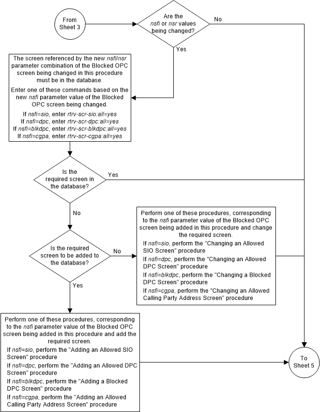

    If the NSFI of the screen being changed in this procedure will be STOP or FAIL, or if the NSFI of the screen is not being changed, skip step 3 and go to step 4.
  3. Enter the commands in the Verifying the Gateway Screening Configuration section to verify that the screen that will be specified by the NSFI/NSR parameter combination in step 5 is in the database.
    If any of these conditions apply to this procedure, skip this step and go to step 5:

  4. Display the status of the ITU National and International Spare Point Code Support feature by entering the rtrv-ctrl-feat command with the ITU National and International Spare Point Code Support feature part number.
    Enter this command.
    Zero entries found.
    Zero entries found.
    If the ITU National and International Spare Point Code Support feature is enabled, go to step 5.
    If the ITU National and International Spare Point Code Support feature is not enabled, perform the “Activating the ITU National and International Spare Point Code Support Feature” procedure in Database Administration - SS7 User's Guide to enable the ITU National and International Spare Point Code Support feature as required. After the feature has been enabled, go to step 5.

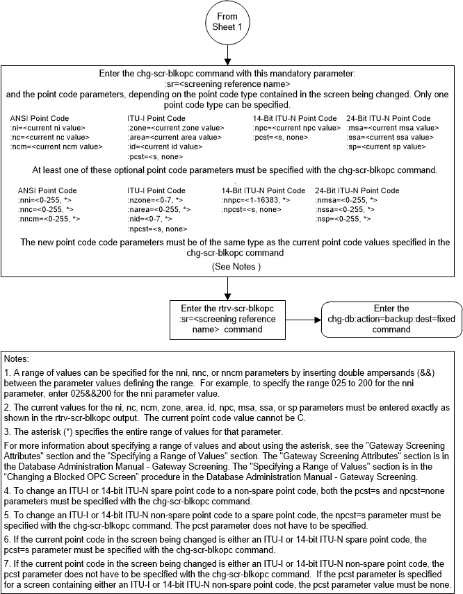

  5. Change the attributes of the blocked OPC screen using the chg-scr-blkopc command.
    If a gateway screening stop action is to be assigned to the blocked OPC screen being changed, enter the chg-scr-blkopc command with the nsfi=stop parameter and the actname parameter with the name of a gateway screening stop action set shown in the output of the rtrv-gws-actset command executed in step 2.
    The current values for the ni, nc, ncm, zone, area, id, npc, msa, ssa, and sp parameters must be entered exactly as shown in the rtrv-scr-blkopc output in step 1.
    The following list contains the values for the nni, nnc, nncm, nzone, narea, nid, nnpc, nmsa, nssa, and nsp parameters:
    • nni – 0 - 255, c, or an asterisk (*)
    • nnc – 0 - 255, c, or an asterisk (*)
    • nncm – 0 - 255, c, or an asterisk (*)
    • nzone – 0 - 7, c, or an asterisk (*)
    • narea – 0 - 255, c, or an asterisk (*)
    • nid – 0 - 7, c, or an asterisk (*)
    • nnpc – 1 - 16383, c, or an asterisk (*)
    • nmsa – 0 - 255, c, or an asterisk (*)
    • nssa – 0 - 255, c, or an asterisk (*)
    • nsp – 0 - 255, c, or an asterisk (*)
    A range of values can be specified for the nni, nnc, and nncm parameters. See the “Specifying a Range of Values” section for more information on how the asterisk and a range of values are used for the nni, nnc, and nncm parameters.
    To change an ITU-I or 14-bit ITU-N spare point code to a non-spare point code, both the pcst=s and npcst=none parameters must be specified with the chg-scr-blkopc command.
    To change an ITU-I or 14-bit ITU-N non-spare point code to a spare point code, the npcst=s parameter must be specified with the chg-scr-blkopc command. The pcst parameter does not have to be specified.
    If the current point code in the screen being changed is either an ITU-I or 14-bit ITU-N spare point code, the pcst=s parameter must be specified with the chg-scr-blkopc command.
    If the current point code in the screen being changed is either an ITU-I or 14-bit ITU-N non-spare point code, the pcst parameter does not have to be specified with the chg-scr-blkopc command. If the pcst parameter is specified for a screen containing either an ITU-I or 14-bit ITU-N non-spare point code, the pcst parameter value must be none.
    The pcst or npcst parameters cannot be used with the zone=c or npc=c parameters.
    chg-scr-blkopc:sr=gws7:ni=002:nc=002:ncm=002:nni=230:nnc=230 :nncm=230
    The following messages appear.
    CHG-SCR-BLKOPC: SCREEN SET AFFECTED - GWS7  1% FULL
    CHG-SCR-BLKOPC: MASP A - COMPLTD
    Verify the changes using thertrv-scr-blkopc command with the screening reference name used in step 5. For this example, enter this command.
    rtrv-scr-blkopc:sr=gws7
    rlghncxa03w 06-10-25 15:28:30 GMT  EAGLE5 36.0.0
    GWS7  230      230      230      FAIL    ------
    GWS7  C        C        C        DPC     GWS9
  6. Backup the new changes using the chg-db:action=backup:dest=fixed command.
Figure 11-11 Change a Blocked OPC Screen - Sheet 1 of 5
img/chg-scr-blkopc-01-db-manual-ref.png
Figure 11-12 Change a Blocked OPC Screen - Sheet 2 of 5
img/chg-scr-blkopc-02-db-manual-ref.png
Figure 11-13 Change a Blocked OPC Screen - Sheet 3 of 5
img/chg-scr-blkopc-03-318.png
Figure 11-14 Change a Blocked OPC Screen - Sheet 4 of 5
img/chg-scr-blkopc-04-318.png
Figure 11-15 Change a Blocked OPC Screen - Sheet 5 of 5
img/chg-scr-blkopc-05-318.png
