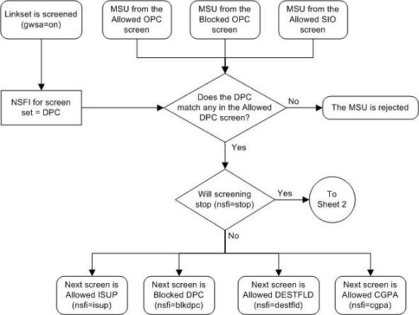

The allowed destination point code (DPC) screen identifies a set of DPC's that are allowed to receive SS7 messages from another network. The gray shaded areas in Figure 9-4 shows the fields of the SS7 message that are checked by the allowed DPC screening function.
Gateway Screening Actions
If a match is not found, the message is discarded.
If a match is found, the nsfi is examined to determine the next step in the screening process. If the nsfi value is any value other than stop, the next screening reference (nsr) is identified and the screening process continues to the next screen identified by the nsfi and nsr parameter values.
If the nsfi is equal to stop, the screening process stops and the message is processed. If a gateway screening stop action set is specified with the screen, shown by the actname parameter value, the message is processed according to the gateway screening stop actions that are assigned to the gateway screening stop action set.

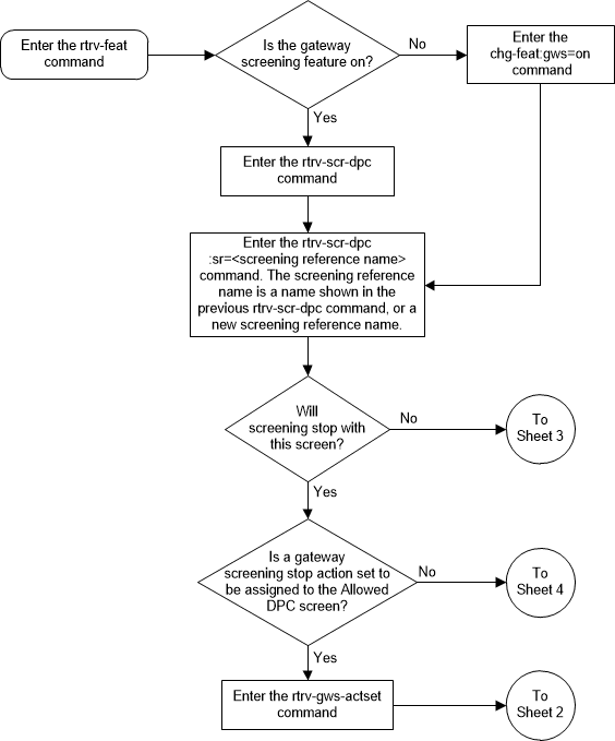

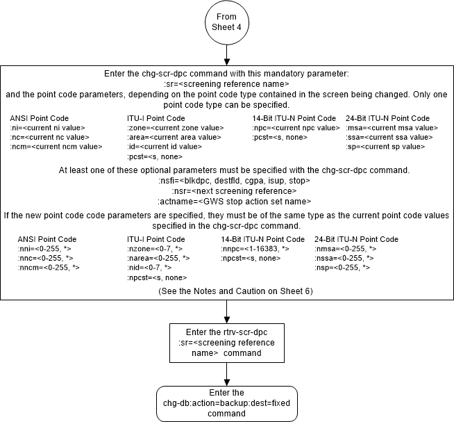

Allowed DPC Screening Actions

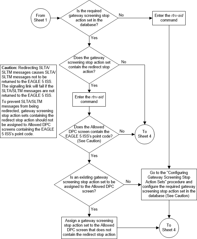

Figure 9-1 through Figure 9-3 show the screening actions of the allowed DPC screen.
Figure 9-1 Allowed DPC Screening Actions - Sheet 1 of 3
img/allowed-dpc-1-300.jpg
Figure 9-2 Allowed DPC Screening Actions - Sheet 2 of 3
img/gws-stop-actions-01-140964.jpg
Figure 9-3 Allowed DPC Screening Actions - Sheet 3 of 3
img/gws-stop-actions-02-140964.jpg

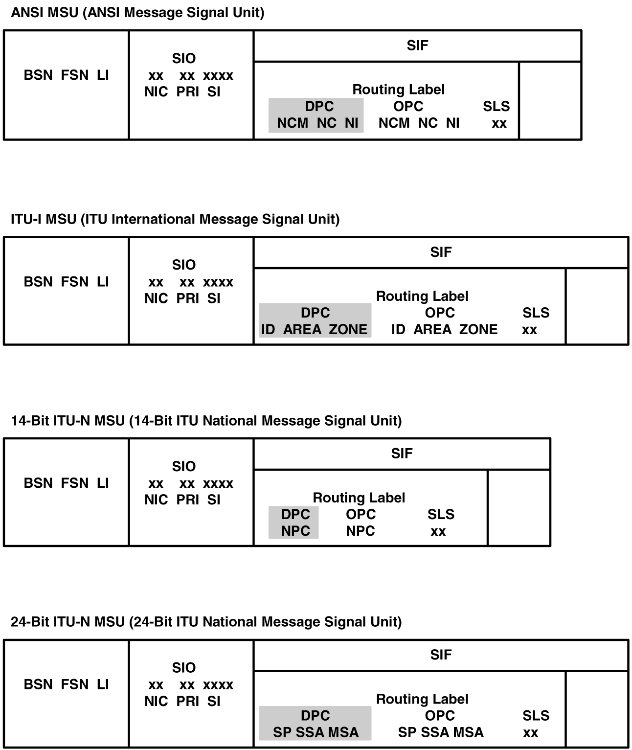

Figure 9-4 Allowed DPC Screening Functions
img/c-introduction-7-dbags-fig5.jpg

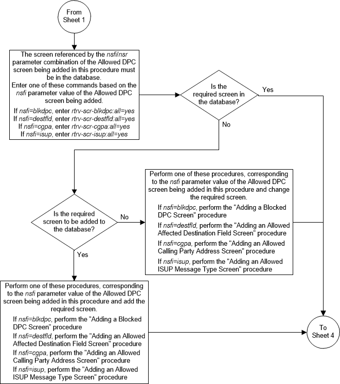

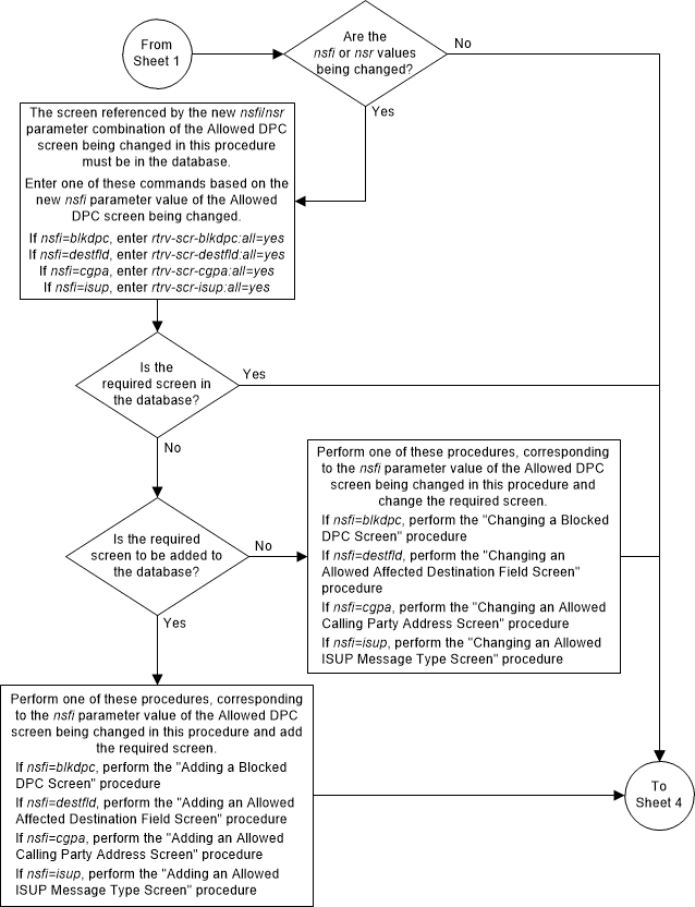

The allowed DPC screen can reference one of the following screens.
  • Blocked DPC
  • Allowed Affected Destination Field
  • Allowed CGPA
  • Allowed ISUP
Verifying the Gateway Screening Configuration
Enter the following commands to verify that these screens are in the database.
  • rtrv-scr-blkdpc:all=yes
  • rtrv-scr-destfld:all=yes
  • rtrv-scr-cgpa:all=yes
  • rtrv-scr-isup:all=yes
Gateway Screening Configuration Procedures
If the desired screen is not in the database, perform one of these procedures to add the desired screen to the database or change an existing screen in the database.

  1. Verify that the gateway screening feature is on, by entering the rtrv-feat command.
    If the gateway screening feature is on, the GWS field is set to on.
    The rtrv-feat command output contains other fields that are not used by this procedure. If you wish to see all the fields displayed by the rtrv-feat command, see the rtrv-feat command description inCommands User's Guide.
    If the gateway screening feature is on, shown by the entry GWS = on in the rtrv-feat command output, skip step 2, and go to step 3.
  2. Turn the gateway screening feature on by entering this command.
    chg-feat:gws=on
    Once the gateway screening feature is turned on with the chg-feat command, it cannot be turned off.
    The gateway screening feature must be purchased before you turn this feature on with the chg-feat command. If you are not sure if you have purchased the gateway screening feature, contact your Oracle Sales Representative or Account Representative.
    When the chg-feat has successfully completed, this message should appear.
    rlghncxa03w 06-10-28 11:43:04 GMT EAGLE5 36.0.0
    CHG-FEAT: MASP A - COMPLTD
  3. Display all allowed DPC screens in the database using the rtrv-scr-dpc command.

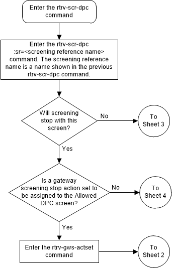

    If a gateway screening stop action set is to be assigned to the allowed DPC screen being added to the database, go to step 4.
    Step 4 verifies the gateway screening stop action set names in the database. The gateway screening stop action set names are assigned only if the NSFI of the screen being added in this procedure is STOP. If the NSFI of the new screen will be STOP, but a gateway screening stop action set name will not be assigned to the new screen, skip steps 4, 5, and 6 and go to step 7. If the NSFI of the new screen is not STOP, skip step 4 and 5, and go to step 6.
  4. Display the gateway screening stop action sets in the database with the rtrv-gws-actset command.
    This is an example of the possible output.
    rlghncxa03w 06-10-25 15:27:30 GMT EAGLE5 36.0.0
    ACT  ACT    ACT  ACT  ACT  ACT  ACT  ACT  ACT  ACT  ACT  ACT
    ID   NAME   1    2    3    4    5    6    7    8    9    10
    1    copy   copy
    2    rdct   rdct
    3    cr     copy rdct
    4    cncf   cncf
    5    cpcncf copy cncf
    6    cncfrd cncf rdct
    7    cpcfrd copy cncf rdct
    GWS action set table is (7 of 16) 44% full
    If the required gateway screening stop action set is not in the database, perform the Configuring Gateway Screening Stop Action Sets procedure to configure the required gateway screening stop action set.
    If the gateway screening stop action set being assigned to theAllowed DPC screen does not contain the redirect stop action, skip step 5 and go to step 6.

    If the NSFI of the screen being added in this procedure is STOP, skip step 6 and go to step 7.
  6. Enter the commands in the Verifying the Gateway Screening Configuration section to verify that the screen that will be specified by the NSFI/NSR parameter combination in step 8 is in the database.
    If the desired screen is not in the database, perform one of the procedures shown in the Gateway Screening Configuration Procedures section to add the desired screen to the database or change an existing screen in the database.

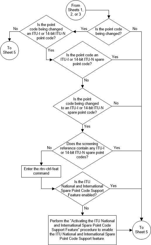

    If the point code being added in this procedure is not an ITU-I or 14-bit ITU-N spare point code, continue the procedure with step 8.
    If the point code being added in this procedure is an ITU-I or 14-bit ITU-N spare point code and the screening reference contains ITU-I or 14-bit ITU-N spare point codes, continue the procedure with step 8.
  7. Display the status of the ITU National and International Spare Point Code Support feature by entering the rtrv-ctrl-feat command with the ITU National and International Spare Point Code Support feature part number.
    Enter this command.
    rtrv-ctrl-feat:partnum=893013601
    rlghncxa03w 06-10-25 15:25:30 GMT EAGLE5 36.0.0
    The following features have been permanently enabled:
    Feature Name              Partnum   Status Quantity
    Spare Point Code Support  893013601 on     ----
    The following features have been temporarily enabled:
    Feature Name              Partnum   Status Quantity   Trial Period Left
    Zero entries found.
    The following features have expired temporary keys:
    Zero entries found.
    If the ITU National and International Spare Point Code Support feature is enabled, go to step 8.
    If the ITU National and International Spare Point Code Support feature is not enabled, perform the “Activating the ITU National and International Spare Point Code Support Feature” procedure in Database Administration - SS7 User's Guide to enable the ITU National and International Spare Point Code Support feature as required. After the feature has been enabled, go to step 8.

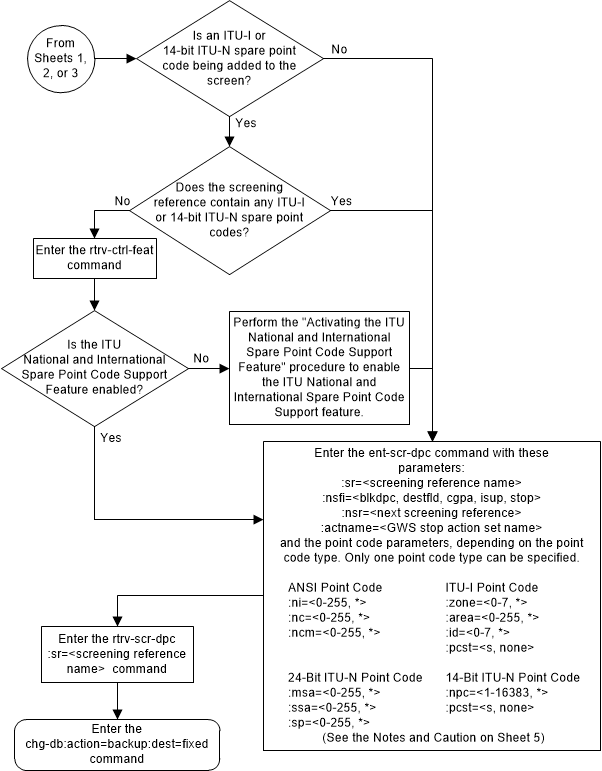

  8. Add a new allowed DPC screen to the database using the ent-scr-dpc command.
    If a gateway screening stop action is to be assigned to the allowed DPC screen being added, enter the ent-scr-dpc command with the nsfi=stop parameter and the actname parameter with the name of a gateway screening stop action set shown in the output of the rtrv-gws-actset command executed in step 4.
    Caution:
    Redirecting SLTA/SLTM messages prevents SLTA/ SLTM messages from being returned to the EAGLE. The signaling link carrying these messages will fail if these messages are not returned to the EAGLE. To prevent SLTA/SLTM messages from being redirected, gateway screening stop action sets containing the redirect stop action should not be assigned to Allowed DPC screens containing the EAGLE’s point code, shown in step 5.
    The following list contains the values for ni, nc, ncm, zone, area, id, npc, msa, ssa, and sp parameters:
    • ni – 0 - 255 or an asterisk (*)
    • nc – 0 - 255 or an asterisk (*)
    • ncm – 0 - 255 or an asterisk (*)
    • zone – 0 - 7 or an asterisk (*)
    • area – 0 - 255 or an asterisk (*)
    • id – 0 - 7 or an asterisk (*)
    • npc – 1 - 16383 or an asterisk (*)
    • msa – 0 - 255 or an asterisk (*)
    • ssa – 0 - 255 or an asterisk (*)
    • sp – 0 - 255 or an asterisk (*)
    A range of values can be specified for the ni, nc, and ncm parameters. See the Specifying a Range of Values section for more information on how the asterisk and a range of values are used for the ni, nc, and ncm parameters. To add a spare point code to the allowed DPC screen, the pcst=s parameter must be specified.
    To add a non-spare point code to the allowed DPC screen, the pcst parameter does not have to be specified. If the pcst parameter is specified for a screen containing an ITU-I or 14-bit ITU-N non-spare point code, the value must be none.
    For this example, enter these commands.
    ent-scr-dpc:sr=gws9:ni=003:nc=003:ncm=003:nsfi=blkdpc:nsr=gw12
    A message similar to the following should appear.
    rlghncxa03w 06-10-25 15:28:30 GMT  EAGLE5 36.0.0
    ENT-SCR-DPC:  SCREEN SET AFFECTED - GWS9  1% FULL
    ENT-SCR-DPC:  MASP A - COMPLTD
    ent-scr-dpc:sr=isp2:ni=073:nc=200:ncm=059:nsfi=isup:nsr=isp2
    rlghncxa03w 06-10-25 15:29:30 GMT  EAGLE5 36.0.0
    ENT-SCR-DPC:  SCREEN SET AFFECTED - ISP2  1% FULL
    ent-scr-dpc:sr=tup1:ni=050:nc=034:ncm=059:nsfi=isup:nsr=tup1
    ENT-SCR-DPC:  SCREEN SET AFFECTED - TUP1  1% FULL
    ent-scr-dpc:sr=iec:ni=070:nc=070:ncm=025&&135:nsfi=blkdpc :nsr=gws9

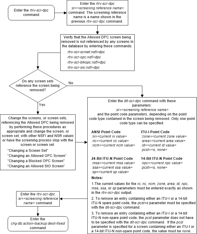

Figure 9-10 Remove an Allowed DPC Screen
img/dlt-scr-dpc-318.png

  6. Change the attributes of an allowed DPC screen using the chg-scr-dpc command.
    If a gateway screening stop action is to be assigned to the allowed DPC screen being changed, enter the chg-scr-dpc command with the nsfi=stop parameter and the actname parameter with the name of a gateway screening stop action set shown in the output of the rtrv-gws-actset command executed in step 2.
    Caution:
    Redirecting SLTA/SLTM messages prevents SLTA/SLTM messages from being returned to the EAGLE. The signaling link carrying these messages will fail if these messages are not returned to the EAGLE. To prevent SLTA/ SLTMmessages from being redirected, gateway screening stop action sets containing the redirect stop action should not be assigned to Allowed DPC screens containing the EAGLE’s point code, shown in step 3.
    The current values for the ni, nc, ncm, zone, area, id, npc, msa, ssa, and sp parameters must be entered exactly as shown in the rtrv-scr-dpc output in step 1.
    The following list contains the values for the nni, nnc, nncm, nzone, narea, nid, nnpc, nmsa, nssa, and nsp parameters:
    • nni - 0-255 or an asterisk (*)
    • nnc - 0-255 or an asterisk (*)
    • nncm - 0-255 or an asterisk (*)
    • nzone - 0-7 or an asterisk (*)
    • narea - 0-255 or an asterisk (*)
    • nid - 0-7 or an asterisk (*)
    • nnpc - 1 - 16383 or an asterisk (*)
    • nmsa - 0-255 or an asterisk (*)
    • nssa - 0-255 or an asterisk (*)
    • nsp - 0-255 or an asterisk (*)
    A range of values can be specified for the nni, nnc, and nncm parameters. See the “Specifying a Range of Values” section for more information on how the asterisk and a range of values are used for the nni, nnc, and nncm parameters.
    To change an ITU-I or 14-bit ITU-N spare point code to a non-spare point code, both the pcst=s and npcst=none parameters must be specified with the chg-scr-dpc command.
    To change an ITU-I or 14-bit ITU-N non-spare point code to a spare point code, the npcst=s parameter must be specified with the chg-scr-dpc command. The pcst parameter does not have to be specified.
    If the current point code in the screen being changed is either an ITU-I or 14-bit ITU-N spare point code, the pcst=s parameter must be specified with the chg-scr-dpc command.
    If the current point code in the screen being changed is either an ITU-I or 14-bit ITU-N non-spare point code, the pcst parameter does not have to be specified with the chg-scr-dpc command. If the pcst parameter is specified for a screen containing either an ITU-I or 14-bit ITU-N non-spare point code, the pcst parameter value must be none.
    For this example, enter this command.
    chg-scr-dpc:sr=gws9:ni=003:nc=003:ncm=003:nni=009:nnc=009 :nncm=009:nsfi=stop

Figure 9-11 Change an Allowed DPC Screen - Sheet 1 of 6
img/chg-scr-dpc-01-314.png
Figure 9-12 Change an Allowed DPC Screen - Sheet 2 of 6
img/chg-scr-dpc-02-331.png
Figure 9-13 Change an Allowed DPC Screen - Sheet 3 of 6
img/chg-scr-dpc-03-314.png
Figure 9-14 Change an Allowed DPC Screen - Sheet 4 of 6
img/chg-scr-dpc-04-db-manual-ref.png
Figure 9-15 Change an Allowed DPC Screen - Sheet 5 of 6
img/chg-scr-dpc-05-318.png
Figure 9-16 Change an Allowed DPC Screen - Sheet 6 of 6
img/chg-scr-dpc-06-db-manual-ref.png
