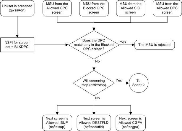

The blocked DPC screen identifies DPC's that are not allowed to receive SS7 messages from another network. The gray shaded areas in Figure 8-4 shows the fields of the SS7 message that are checked by the blocked DPC screening function.
Gateway Screening Actions
If a match is found, the nsfi is equal to fail, the message is discarded and no further screening takes place.
If a match is not found, the nsfi is examined to determine the next step in the screening process. If the nsfi value is any value other than stop, the next screening reference (nsr) is identified and the screening process continues to the next screen identified by the nsfi and nsr parameter values.
If the nsfi is equal to stop, the screening process stops and the message is processed. If a gateway screening stop action set is specified with the screen, shown by the actname parameter value, the message is processed according to the gateway screening stop actions that are assigned to the gateway screening stop action set.

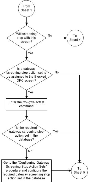

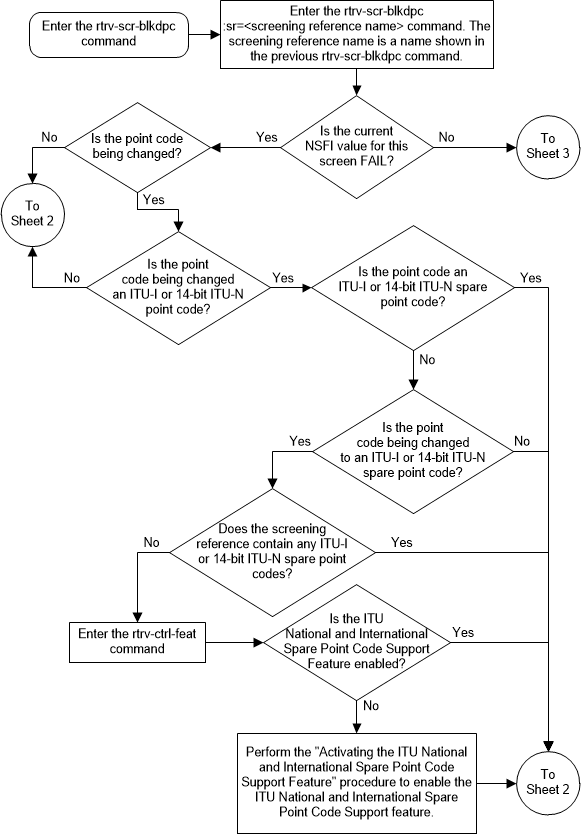

Blocked DPC Screening Actions

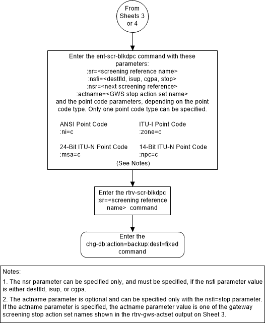

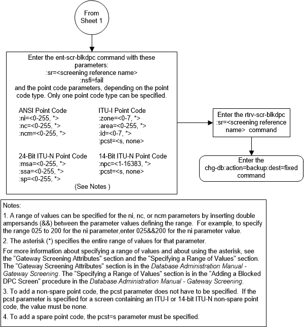

Figure 8-1 through Figure 8-3 show the screening actions of the blocked DPC screen.
Figure 8-1 Blocked DPC Screening Actions - Sheet 1 of 3
img/blocked-dpc-1-300.jpg
Figure 8-2 Blocked DPC Screening Actions - Sheet 2 of 3
img/gws-stop-actions-01-140964.jpg
Figure 8-3 Blocked DPC Screening Actions - Sheet 3 of 3
img/gws-stop-actions-02-140964.jpg

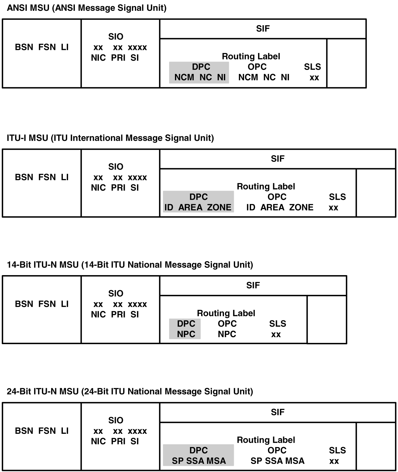

Figure 8-4 Blocked DPC Screening Functions
img/c-introduction-6-dbags-fig5.jpg
Adding a Blocked DPC Screen
This procedure is used to add a blocked destination point code (DPC) screen to the database using the ent-scr-blkdpc command. The parameters used by the ent-scr-blkdpc command are shown in the Gateway Screening Attributes section. The general rules that apply to configuring gateway screening entities are shown in the Gateway Screening Configuration section.
The examples in this procedure are used to add the blocked DPC screen data shown in Table 8-1 and based on the example configurations shown in Figure 2-3 and Figure 2-5.

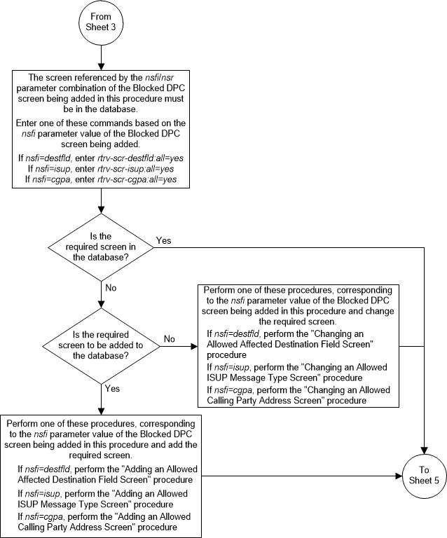

Verifying Gateway Screening Configuration
Enter the following commands to verify that these screens are in the database.
  • rtrv-scr-destfld:all=yes
  • rtrv-scr-cgpa:all=yes
  • rtrv-scr-isup:all=yes
Gateway Screening Configuration Procedures
If the desired screen is not in the database, perform one of the following procedures to add the desired screen to the database or change an existing screen in the database.

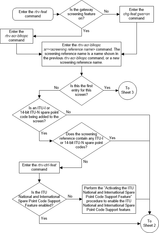

  1. Verify that the gateway screening feature is on, by entering the rtrv-feat command.
    If the gateway screening feature is on, the GWS field is set to on.
    Thertrv-feat command output contains other fields that are not used by this procedure. If you wish to see all the fields displayed by thertrv-feat command, see thertrv-feat command description inCommands User's Guide.
    If the gateway screening feature is on, shown by the entry GWS = on in the rtrv-feat command output, skip step 2, and go to step 3.
  2. Turn the gateway screening feature on by entering this command.
    chg-feat:gws=on
    Once the gateway screening feature is turned on with thechg-feat command, it cannot be turned off.
    The gateway screening feature must be purchased before you turn this feature on with the chg-feat command. If you are not sure if you have purchased the gateway screening feature, contact your Oracle Sales Representative or Account Representative.
    When the chg-feat has successfully completed, this message should appear.
    rlghncxa03w 06-10-28 11:43:04 GMT EAGLE5 36.0.0
    CHG-FEAT: MASP A - COMPLTD

    If the required gateway screening stop action set is not in the database, perform the Configuring Gateway Screening Stop Action Sets procedure to configure the required gateway screening stop action set.
    If the NSFI of the screen being added in this procedure is STOP or FAIL, skip step 5 and go to step 6.
  5. Enter the commands in the Verifying the Gateway Screening Configuration section to verify that the screen that will be specified by the NSFI/NSR parameter combination in step 7 is in the database.
    If the desired screen is not in the database, perform one of the procedures shown in the Gateway Screening Configuration Procedures section to add the desired screen to the database or change an existing screen in the database.
    If the point code being added in this procedure is not an ITU-I or 14-bit ITU-N spare point code, skip this step and to step 7.
    If the point code being added in this procedure is an ITU-I or 14-bit ITU-N spare point code and the screening reference contains ITU-I or 14-bit ITU-N spare point codes, skip this step and go to step 7.
  6. Display the status of the ITU National and International Spare Point Code Support feature by entering the rtrv-ctrl-feat command with the ITU National and International Spare Point Code Support feature part number.
    Enter this command.
    rtrv-ctrl-feat:partnum=893013601
    This is an example of the possible output.
    rlghncxa03w 06-10-25 15:25:30 GMT EAGLE5 36.0.0
    The following features have been permanently enabled:
    Feature Name              Partnum   Status Quantity
    Spare Point Code Support  893013601 on     ----
    The following features have been temporarily enabled:
    Feature Name              Partnum   Status Quantity   Trial Period Left
    Zero entries found.
    The following features have expired temporary keys:
    Zero entries found.
    If the ITU National and International Spare Point Code Support feature is enabled, go to step 7.
    If the ITU National and International Spare Point Code Support feature is not enabled, perform the “Activating the ITU National and International Spare Point Code Support Feature” procedure in Database Administration - SS7 User's Guide to enable the ITU National and International Spare Point Code Support feature as required. After the feature has been enabled, go to step 7.

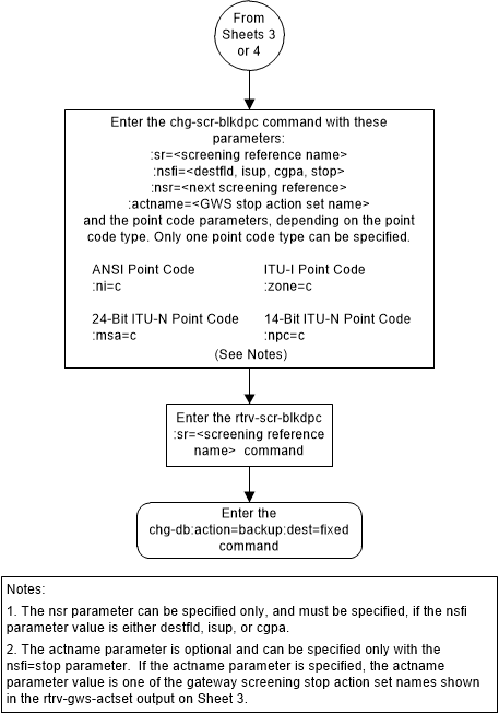

  7. Add a new blocked DPC screen to the database using the ent-scr-blkdpc command.
    If a gateway screening stop action is to be assigned to the blocked DPC screen being added, enter the ent-scr-blkdpc command with the nsfi=stop parameter and the actname parameter with the name of a gateway screening stop action set shown in the output of the rtrv-gws-actset command executed in step 4.
    The following list contains the values for ni, nc, ncm, zone, area, id, npc, msa, ssa, and sp parameters:
    • ni - 0-255, c, or an asterisk (*)
    • nc - 0-255, c, or an asterisk (*)
    • ncm - 0-255, c, or an asterisk (*)
    • zone - 0-7, c, or an asterisk (*)
    • area - 0-255, c, or an asterisk (*)
    • id - 0-7, c, or an asterisk (*)
    • npc - 1 - 16383, c, or an asterisk (*)
    • msa - 0-255, c, or an asterisk (*)
    • ssa - 0-255, c, or an asterisk (*)
    • sp - 0-255, c, or an asterisk (*)
    A range of values can be specified for the ni, nc, and ncm parameters. See the “Specifying a Range of Values” section for more information on how the asterisk and a range of values are used for the ni, nc, and ncm parameters.
    To add a spare point code to the blocked DPC screen, the pcst=s parameter must be specified. To add a non-spare point code to the blocked DPC screen, the pcst parameter does not have to be specified. If the pcst parameter is specified for a screen containing an ITU-I or 14-bit ITU-N non-spare point code, the value must be none. The pcst parameter cannot be used with the zone=c or npc=c parameters.
    For this example, enter these commands.
    ent-scr-blkdpc:sr=gws9:ni=c:nc=c:ncm=c:nsfi=cgpa:nsr=gw13
    A message similar to the following should appear.
    rlghncxa03w 06-10-25 15:28:30 GMT  EAGLE5 36.0.0
    ENT-SCR-BLKDPC: SCREEN SET AFFECTED - GWS9  1% FULL
    ENT-SCR-BLKDPC: MASP A - COMPLTD
    ent-scr-blkdpc:sr=gws9:ni=005:nc=005:ncm=005:nsfi=fail
    rlghncxa03w 06-10-25 15:29:30 GMT  EAGLE5 36.0.0
    ent-scr-blkdpc:sr=gw12:ni=c:nc=c:ncm=c:nsfi=cgpa:nsr=gw14
    rlghncxa03w 06-10-25 15:30:30 GMT  EAGLE5 36.0.0
    ENT-SCR-BLKDPC: SCREEN SET AFFECTED - GW12  1% FULL
    ent-scr-blkdpc:sr=gw12:ni=004:nc=004:ncm=004:nsfi=fail
    rlghncxa03w 06-10-25 15:31:30 GMT  EAGLE5 36.0.0

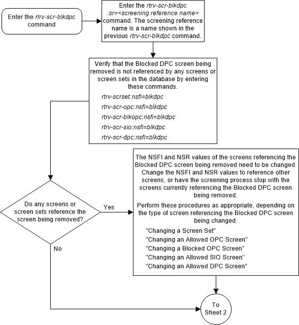

Enter the following commands to verify that none of these screens reference the blocked DPC screen being removed from the database.
  • rtrv-scrset:nsfi=blkdpc
  • rtrv-scr-opc:nsfi=blkdpc
  • rtrv-scr-blkopc:nsfi=blkdpc
  • rtrv-scr-sio:nsfi=blkdpc
  • rtrv-scr-dpc:nsfi=blkdpc

  2. Enter the commands in the Verifying the Gateway Screening Configuration section to verify that the screen being removed is not referenced by other screens in the database.
    If the screen being removed is referenced by other screens, perform the procedures shown in the Gateway Screening Configuration Procedures section to change the NSFI of those screens to reference other screens or change the NSFI of these screens to STOP.

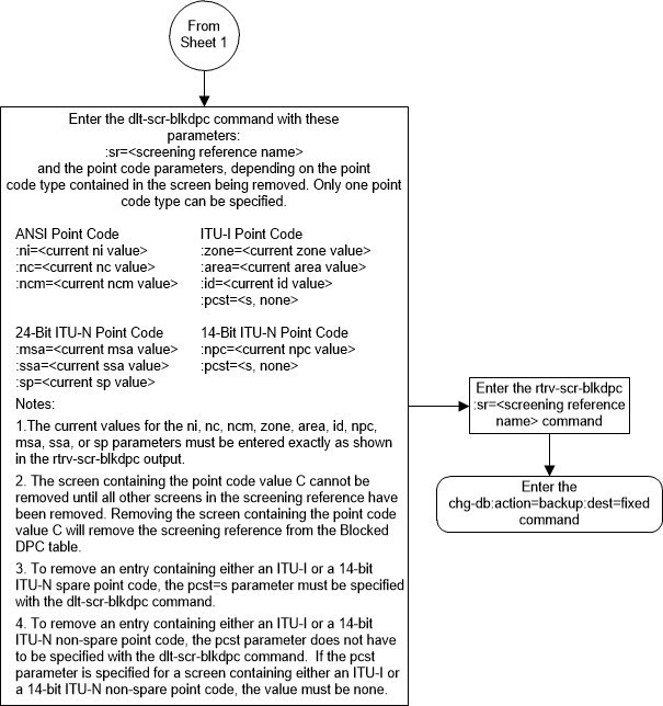

  3. Remove the blocked DPC screen from the database using the dlt-scr-blkdpc command with the screening reference name shown in the rtrv-scr-blkdpc output in step 1 and with the point code parameter values (ni, nc, ncm, or zone, area, id, npc, msa, ssa, or sp) of the screen being removed from the database. The values for these parameters must be entered exactly as shown in the rtrv-scr-blkdpc output.
    To remove an entry containing either an ITU-I or a 14-bit ITU-N spare point code, the pcst=s parameter must be specified with the dlt-scr-blkdpc command.
    To remove an entry containing either an ITU-I or a 14-bit ITU-N non-spare point code, the pcst parameter does not have to be specified with the dlt-scr-blkdpc command. If the pcst parameter is specified, the value must be none.
    The pcst parameter cannot be used with the zone=c or the npc=c parameters.
    For this example, enter this command.
    dlt-scr-blkdpc:sr=iec:ni=240:nc=001:ncm=010
    rlghncxa03w 06-10-25 15:26:30 GMT  EAGLE5 36.0.0
    DLT-SCR-BLKDPC: SCREEN SET AFFECTED - IEC 25% FULL
    DLT-SCR-BLKDPC: MASP A - COMPLTD

Changing a Blocked DPC Screen
This procedure is used to change the attributes of a blocked destination point code (DPC) screen in the database using the chg-scr-blkdpc command. The parameters used by the chg-scr-blkdpc command are shown in the Gateway Screening Attributes section. The general rules that apply to configuring gateway screening entities are shown in the Gateway Screening Configuration section.
The example in this procedure is used to change the point code 003-003-003 for the blocked DPC screen gw12 to 230-230-230.
If you using multiple-part ITU national point codes with gateway screening, see the 14-Bit ITU National Point Code Formats section.
If the current ni, nc, and ncm are equal to the character c, only the next screening function identifier and next screening reference can be changed. The next screening function identifier cannot be equal to fail. If the next screening function identifier is not equal to stop, the next screening reference must be specified. Otherwise, only the blocked DPC can be changed.
The blocked DPC screen can reference one of the following screens.

  1. Display the blocked DPC screens in the database using the rtrv-scr-blkdpc command.
    The following is an example of the possible output.

    From the rtrv-scr-blkdpc output, display the blocked DPC screen you wish to change using the rtrv-scr-blkdpc command with the screening reference name. For this example, enter this command.
    rtrv-scr-blkdpc:sr=gw12

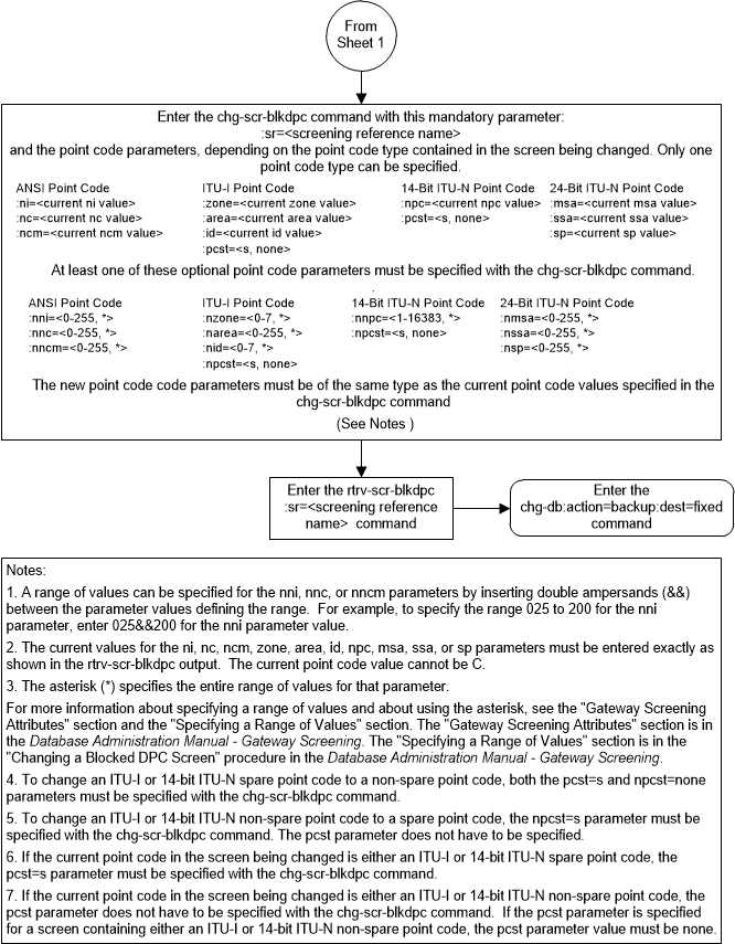

  5. Change the attributes of a blocked DPC screen using the chg-scr-blkdpc command.
    If a gateway screening stop action is to be assigned to the blocked DPC screen being changed, enter the chg-scr-blkdpc command with the nsfi=stop parameter and the actname parameter with the name of a gateway screening stop action set shown in the output of the rtrv-gws-actset command executed in step 2.
    The current values for the ni, nc, ncm, zone, area, id, npc, msa, ssa, and sp parameters must be entered exactly as shown in the rtrv-scr-blkdpc output in step 1.
    The following list contains the values for the nni, nnc, nncm, nzone, narea, nid, nnpc, nmsa, nssa, and nsp parameters:
    • nni – 0 - 255, c, or an asterisk (*)
    • nnc – 0 - 255, c, or an asterisk (*)
    • nncm – 0 - 255, c, or an asterisk (*)
    • nzone – 0 - 7, c, or an asterisk (*)
    • narea – 0 - 255, c, or an asterisk (*)
    • nid – 0 - 7, c, or an asterisk (*)
    • nnpc – 1 - 16383, c, or an asterisk (*)
    • nmsa – 0 - 255, c, or an asterisk (*)
    • nssa – 0 - 255, c, or an asterisk (*)
    • nsp – 0 - 255, c, or an asterisk (*)
    A range of values can be specified for the nni, nnc, and nncm parameters. See the “Specifying a Range of Values” section for more information on how the asterisk and a range of values are used for the nni, nnc, and nncm parameters.
    To change an ITU-I or 14-bit ITU-N spare point code to a non-spare point code, both the pcst=s and npcst=none parameters must be specified with the chg-scr-blkdpc command.
    To change an ITU-I or 14-bit ITU-N non-spare point code to a spare point code, the npcst=s parameter must be specified with the chg-scr-blkdpc command. The pcst parameter does not have to be specified.
    If the current point code in the screen being changed is either an ITU-I or 14-bit ITU-N spare point code, the pcst=s parameter must be specified with the chg-scr-blkdpc command.
    If the current point code in the screen being changed is either an ITU-I or 14-bit ITU-N non-spare point code, the pcst parameter does not have to be specified with the chg-scr-blkdpc command. If the pcst parameter is specified for a screen containing either an ITU-I or 14-bit ITU-N non-spare point code, the pcst parameter value must be none.
    The pcst or npcst parameters cannot be used with the zone=c or npc=c parameters.
    chg-scr-blkdpc:sr=gw12:ni=003:nc=003:ncm=003:nni=230:nnc=230 :nncm=230
    The following message appears.
    rlghncxa03w 06-10-25 15:27:30 GMT  EAGLE5 36.0.0
    CHG-SCR-BLKDPC: SCREEN SET AFFECTED - GW12  1% FULL
    CHG-SCR-BLKDPC: MASP A - COMPLTD
