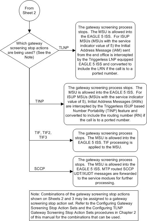

Gateway Screening Actions
If a match is not found, the message is discarded.
If a match is found, the nsfi is examined to determine the next step in the screening process. If the nsfi value is any value other than stop, the next screening reference (nsr) is identified and the screening process continues to the next screen identified by the nsfi and nsr parameter values.
If the nsfi is equal to stop, the screening process stops and the message is processed. If a gateway screening stop action set is specified with the screen, shown by the actname parameter value, the message is processed according to the gateway screening stop actions that are assigned to the gateway screening stop action set.
  • If the rdct (redirect) gateway screening stop action is specified,the message is diverted from the original destination and sent to another destination with the Database Transport Access feature, specified by global title translation, for further processing.
  • If the cncf gateway screening stop action is specified, the PIP parameter in the incoming ISUP IAM message is converted to the GN parameter. The GN parameter in the incoming ISUP IAM message is converted to the PIP parameter. The message is then sent to the node specified by the DPC in the routing label in the message. For more information on the Calling Name Conversion Facility feature, see Calling Name Conversion Facility (CNCF) Configuration.
  • If the tlnp gateway screening stop action is specified, ISUP IAMs that pass gateway screening are processed either by the ISUP NP with EPAP feature (if the ISUP NP with EPAP feature is enabled and turned on) or by the Triggerless LNP feature (if the Triggerless LNP feature is turned on). The ISUP NP with EPAP feature is discussed in more detail in G-Port User's Guide. The Triggerless LNP feature is discussed in more detail in ELAP Administration and LNP Feature Activation Guide.
  • If the tinp gateway screening stop action is specified, ISUP IAMs that pass gateway screening are intercepted by the Triggerless ISUP based Number Portability (TINP) feature and converted to include the routing number (RN) if the call is to a ported number. The TINP feature is discussed in more detail in G-Port User's Guide.
  • If the tif, tif2, or tif3 gateway screening stop actions are specified, TIF processing is applied to the message.
  • If the sccp gateway screening stop action is specified, MTP routed SCCP UDT/XUDT are forwarded to the service modules for further processing.

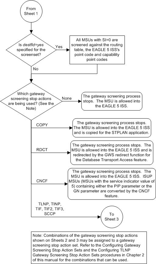

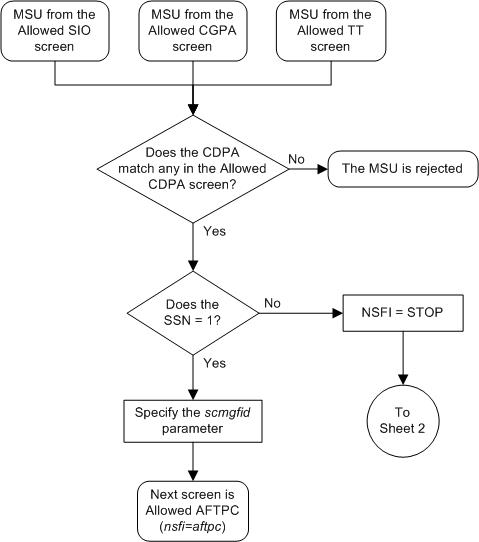

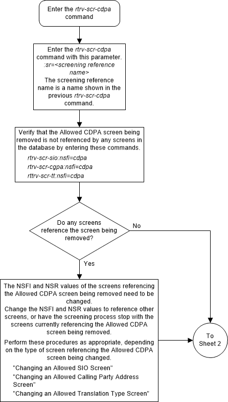

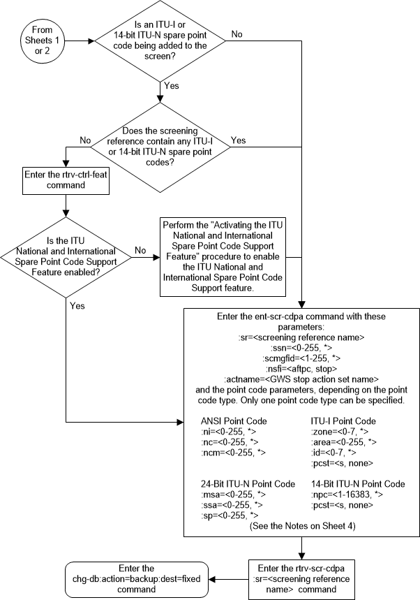

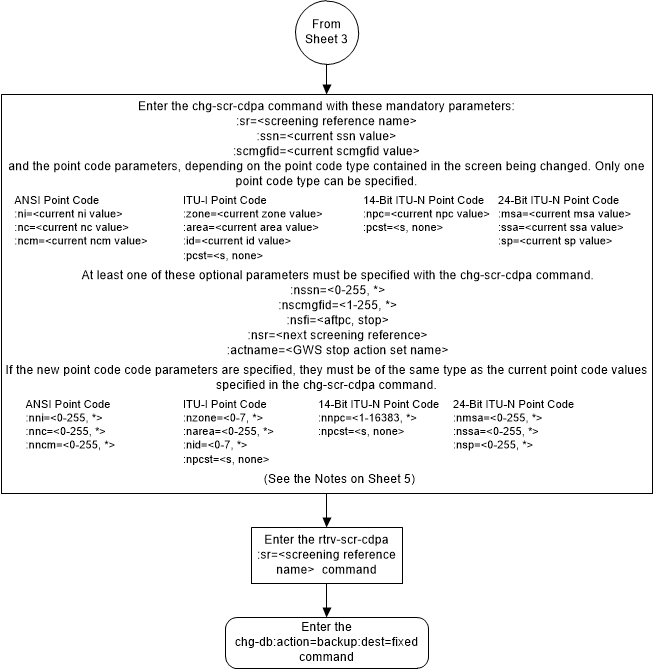

Allowed CDPA Screening Actions
Figure 4-1 through Figure 4-3 show the screening actions of the allowed CDPA screen.
Figure 4-1 Allowed CDPA Screening Actions - Sheet 1 of 3
img/allowed-cdpa-01-116768.jpg
Figure 4-2 Allowed CDPA Screening Actions - Sheet 2 of 3
img/gws-stop-actions-01-140964.jpg
Figure 4-3 Allowed CDPA Screening Actions - Sheet 3 of 3
img/gws-stop-actions-02-140964.jpg

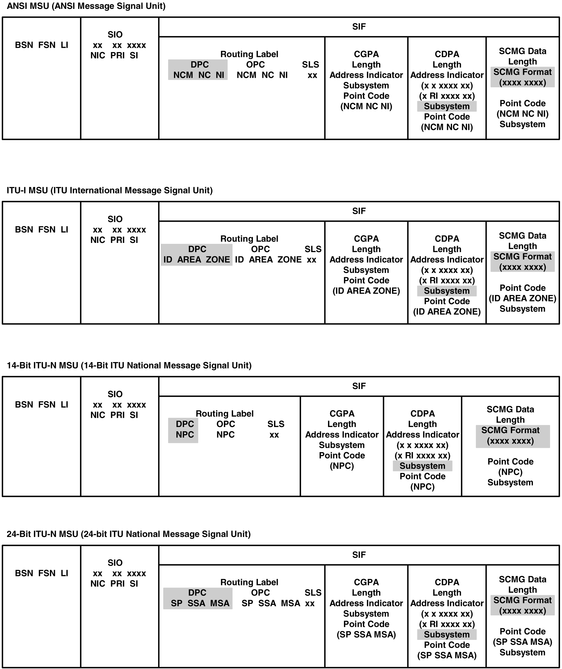

Figure 4-4 Allowed Called Party Address Screening Function
img/c-introduction-3-dbags-fig2.jpg

The allowed CDPA screen can only reference an allowed AFTPC screen and the allowed AFTPC screen being referenced must be in the database. This can be verified using the rtrv-scr-aftpc:all=yes command. If the desired allowed AFTPC screen is not in the database, perform one of these procedures to add the required screen to the database or change an existing screen in the database.

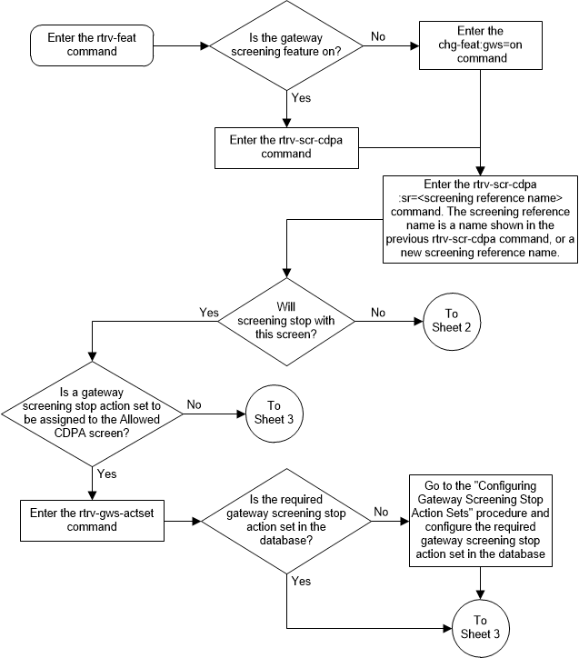

  1. Verify that the gateway screening feature is on, by entering the rtrv-feat command.
    If the gateway screening feature is on, the GWS field is set to on.
    Thertrv-feat command output contains other fields that are not used by this procedure. If you wish to see all the fields displayed by thertrv-feat command, see thertrv-feat command description inCommands User's Guide.
    If the gateway screening feature is on, shown by the entry GWS = on in the rtrv-feat command output, skip step 2, and go to step 3.
  2. Turn the gateway screening feature on by entering this command.
    chg-feat:gws=on
    Once the gateway screening feature is turned on with thechg-feat command, it cannot be turned off.
    The gateway screening feature must be purchased before you turn this feature on with the chg-feat command. If you are not sure if you have purchased the gateway screening feature, contact your Oracle Sales Representative or Account Representative.
    When the chg-feat has successfully completed, this message should appear.
    rlghncxa03w 06-10-28 11:43:04 GMT EAGLE5 36.0.0
    CHG-FEAT: MASP A - COMPLTD
  3. Display all allowed CDPA screens in the database using the rtrv-scr-cdpa command.
    The following is an example of the possible output.
    rlghncxa03w 06-10-25 15:25:30 GMT  EAGLE5 36.0.0
    SCREEN = ALLOWED CDPA
    SR    REF  RULES
    IEC   YES     2
    WRD2  YES     1
    WRD4  YES     9
    If the screening reference names that you wish to add with this procedure are not shown in the rtrv-scr-cdpa command output, go to step 4. For this example, the screening reference names are not shown. If these screening reference names are shown in the rtrv-scr-cdpa command output, make sure the screening data you wish to enter is not already in the database by entering the rtrv-scr-cdpa command with the screening reference name. For example, enter the rtrv-scr-cdpa:sr=iec command.
    rlghncxa03w 06-10-25 15:26:30 GMT  EAGLE5 36.0.0
    SR    NI       NC      NCM       SSN      SCMGFID  NSFI    NSR/ACT
    IEC   240      001     010       012      ------   STOP    ------
    SR      ZONE   AREA    ID        SSN      SCMGFID  NSFI    NSR/ACT
    IEC     1      134     *         001      002      AFTPC   IEC

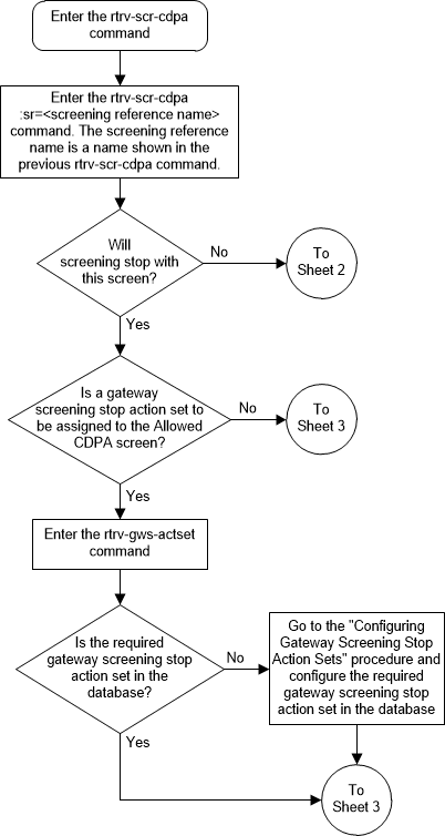

    If a gateway screening stop action set is to be assigned to the allowed CDPA screen being added to the database, go to step 4.
    Step 4 verifies the gateway screening stop action set names in the database. The gateway screening stop action set names are assigned only if the NSFI of the screen being added in this procedure is STOP. If the NSFI of the new screen will be STOP, but a gateway screening stop action set name will not be assigned to the new screen, skip steps 4 and 5 and go to step 6. If the NSFI of the new screen is AFTPC, skip step 4 and go to step 5.
  4. Display the gateway screening stop action sets in the database with the rtrv-gws-actset command.
    This is an example of the possible output.
    rlghncxa03w 06-10-25 15:27:30 GMT EAGLE5 36.0.0
    ACT  ACT    ACT  ACT  ACT  ACT  ACT  ACT  ACT  ACT  ACT  ACT
    ID   NAME   1    2    3    4    5    6    7    8    9    10
    1    copy   copy
    2    rdct   rdct
    3    cr     copy rdct
    4    cncf   cncf
    5    cpcncf copy cncf
    6    cncfrd cncf rdct
    7    cpcfrd copy cncf rdct
    GWS action set table is (7 of 16) 44% full
    If the required gateway screening stop action set is not in the database, perform the Configuring Gateway Screening Stop Action Sets procedure to configure the required gateway screening stop action set.
    If theNSFI of the screen being added in this procedure is STOP, skip step 5 and go to step 6.

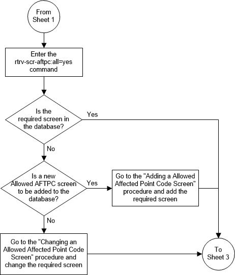

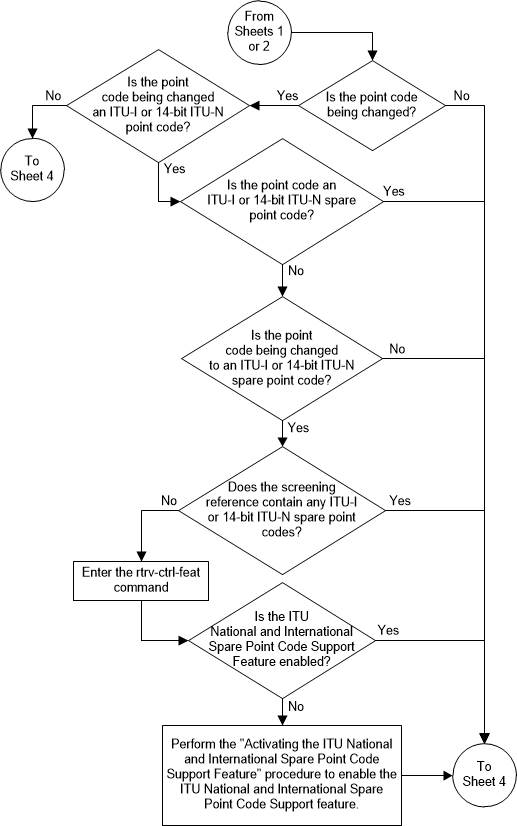

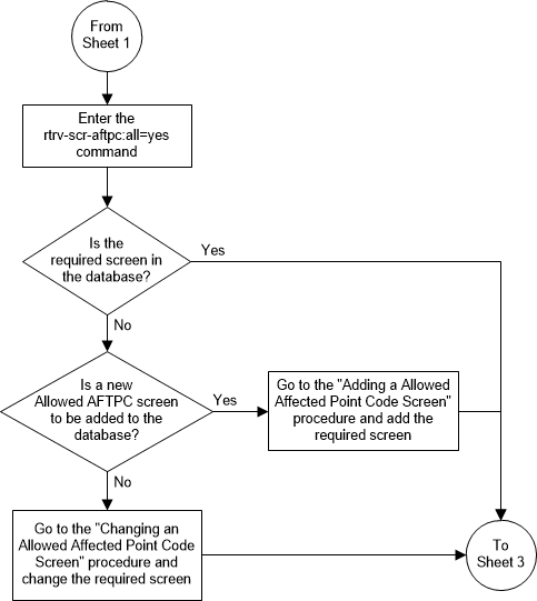

  5. Enter the rtrv-scr-aftpc command to verify that the screen that will be specified by the NSFI/NSR parameter combination in step 7 is in the database.
    If the desired screen is not in the database, perform one of these procedures to add the desired screen to the database or change an existing screen in the database.
    If the point code being added in this procedure is not an ITU-I or 14-bit ITU-N spare point code, skip step 6 and to step 7.
    If the point code being added in this procedure is an ITU-I or 14-bit ITU-N spare point code and the screening reference contains ITU-I or 14-bit ITU-N spare point codes, skip step 6 and go to step 7.

  7. Add a new allowed CDPA screen to the database using the ent-scr-cdpa command.
    If a gateway screening stop action is to be assigned to the allowed CDPA screen being added to the database, enter the ent-scr-cdpa command with the nsfi=stop parameter and the actname parameter with the name of a gateway screening stop action set shown in the output of the rtrv-gws-actset command executed in step 4.
    Caution:
    The EAGLE does not support redirecting MSUs for the DTA feature or intercepting ISUP IAM messages for the Calling Name Conversion Facility feature from the allowed CDPA screen. Gateway screening stop action sets containing either the RDCT (redirect) orCNCF (calling name conversion facility) stop actions should not be assigned to the allowed CDPA screen. If a gateway screening stop action set containing the RDCT or CNCF stop actions is specified with the ent-scr-cdpa command, unsolicited information message (UIM) 1125 is generated when the attempt is made to redirect MSUs from the allowed CDPA screen. Unsolicited information message (UIM) 1215 is generated when ISUP IAM MSUs are intercepted from the allowed CDPA screen. For more information on UIMs 1125 and 1215, go to the Unsolicited Alarm and Information Messages Reference.
    The following list contains the values for ni, nc, ncm, zone, area, id, npc, msa, ssa, sp, ssn, and scmgfid parameters:
    • ni – 0 - 255 or an asterisk (*)
    • nc – 0 - 255 or an asterisk (*)
    • ncm – 0 - 255 or an asterisk (*)
    • zone – 0 - 7 or an asterisk (*)
    • area – 0 - 255 or an asterisk (*)
    • id – 0 - 7 or an asterisk (*)
    • npc – 1 - 16383 or an asterisk (*)
    • msa – 0 - 255 or an asterisk (*)
    • ssa – 0 - 255 or an asterisk (*)
    • sp – 0 - 255 or an asterisk (*)
    • ssn – 0 - 255 or an asterisk (*)
    • scmgfid – 1 - 255 or an asterisk (*)
    Thescmgfid,ssn,nsfi, andnsr parameters can be specified only as shown inTable 4-5.
    Table 4-5 CDPA Parameter Combinations
    1 1 - 255, * AFTPC Must be specified
    0, 2-255, * Cannot be specified STOP Cannot be specified
    A range of values can be specified for the ni, nc, and ncm parameters. See the Specifying a Range of Values section for more information on how the asterisk and a range of values are used for the ni, nc, and ncm parameters.
    To add a spare point code to the allowed CDPA screen, the pcst=s parameter must be specified. To add a non-spare point code to the allowed CDPA screen, the pcst parameter does not have to be specified. If the pcst parameter is specified for a screen containing an ITU-I or 14-bit ITU-N non-spare point code, the value must be none.
    For this example, enter these commands.
    ent-scr-cdpa:sr=gw15:zone=5:area=117:id=2:ssn=254:nsfi=stop
    A message similar to the following should appear.
    rlghncxa03w 06-10-25 15:28:30 GMT  EAGLE5 36.0.0
    ENT-SCR-CDPA: SCREEN SET AFFECTED - GW15  1% FULL
    ENT-SCR-CDPA: MASP A - COMPLTD
    ent-scr-cdpa:sr=gw17:ni=003:nc=003:ncm=003:ssn=001:scmgfid=050 :nsfi=aftpc:nsr=gw20
    rlghncxa03w 06-10-25 15:29:30 GMT  EAGLE5 36.0.0
    ENT-SCR-CDPA: SCREEN SET AFFECTED - GW17  1% FULL
    ent-scr-cdpa:sr=gw18:ni=006:nc=006:ncm=006:ssn=253:nsfi=stop
    rlghncxa03w 06-10-25 15:30:30 GMT  EAGLE5 36.0.0
    ENT-SCR-CDPA: SCREEN SET AFFECTED - GW18  1% FULL
    ent-scr-cdpa:sr=ls03:ni=007:nc=007:ncm=007:ssn=001:scmgfid=100 :nsfi=aftpc:nsr=ls04
    rlghncxa03w 06-10-25 15:31:30 GMT  EAGLE5 36.0.0
    ENT-SCR-CDPA: SCREEN SET AFFECTED - LS03  1% FULL

Figure 4-5 Add an Allowed Called Party Address Screen - Sheet 1 of 4
img/ent-scr-cdpa-01-310.png
Figure 4-6 Add an Allowed Called Party Address Screen - Sheet 2 of 4
img/ent-scr-cdpa-02-310.png
Figure 4-7 Add an Allowed Called Party Address Screen - Sheet 3 of 4
img/ent-scr-cdpa-03-db-manual-ref.png
Figure 4-8 Add an Allowed Called Party Address Screen - Sheet 4 of 4
img/ent-scr-cdpa-04-db-manual-ref.png
Removing an Allowed Called Party Address Screen
This procedure is used to remove an allowed called party address (CDPA) screen from the database using the dlt-scr-cdpa command. The parameters used by the dlt-scr-cdpa command are shown in the Gateway Screening Attributes section. The general rules that apply to configuring gateway screening entities are shown in the Gateway Screening Configuration section.
The example in this procedure removes the allowed CDPA screen gw17 from the database.
If you using multiple-part ITU national point codes with gateway screening, see the 14-Bit ITU National Point Code Formats section.
The allowed CDPA screen can be referenced by one of the following screens.
  • Allowed SIO
  • Allowed CGPA
  • Allowed TT
Verifying the Gateway Screening Configuration
Enter the following commands to verify that none of these screens reference the allowed CDPA screen being removed from the database.
  • rtrv-scr-sio:nsfi=cdpa
  • rtrv-scr-cgpa:nsfi=cdpa
  • rtrv-scr-tt:nsfi=cdpa
Gateway Screening Configuration Procedures
To change the NSFI of any of these screens, preform one of these procedures.
  1. Display the allowed CDPA screens in the database using the rtrv-scr-cdpa command.
    SR    REF  RULES
    GW15  YES     1
    GW17  YES     1
    GW18  YES     1
    IEC   YES     2
    LS03  YES     1
    WRD2  YES     1
    WRD4  YES     9
    From the rtrv-scr-cdpa output, display the allowed CDPA screen you wish to remove using the rtrv-scr-cdpa command with the screening reference name. For this example, enter the rtrv-scr-cdpa:sr=gw17 command. The following is an example of the possible output.
    GW17  003      003     003       001      050      AFTPC   GW20
  2. Enter the commands in the Verifying the Gateway Screening Configuration section to verify that the screen being removed is not referenced by other screens in the database.
    If the screen being removed is referenced by other screens, perform the procedures shown in the Gateway Screening Configuration Procedures section to change the NSFI of those screens to reference other screens or change the NSFI of these screens to STOP.

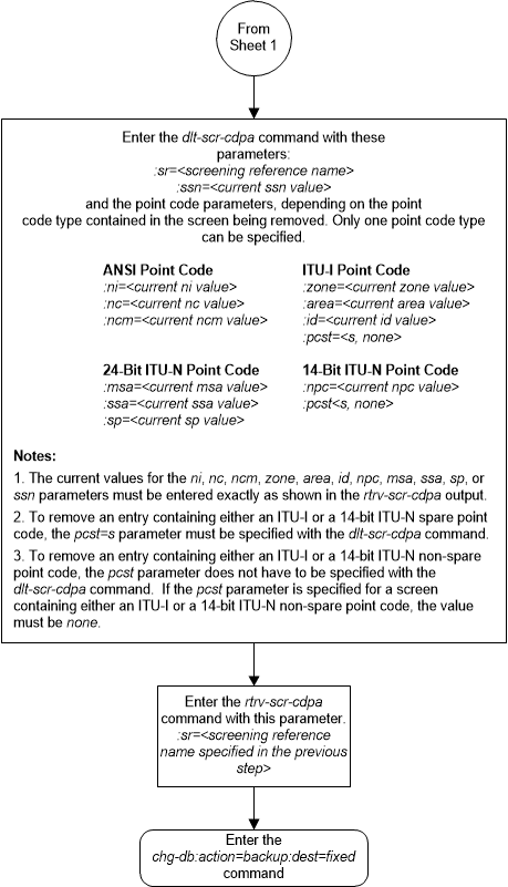

  3. Remove the allowed CDPA screen from the database using the dlt-scr-cdpa command.
    The current values for the ni, nc, ncm, zone, area, id, npc, msa, ssa, sp, and ssn parameters must be entered exactly as shown in the rtrv-scr-cdpa output in 1.
    To remove an entry containing either an ITU-I or a 14-bit ITU-N spare point code, the pcst=s parameter must be specified with the dlt-scr-cdpa command.
    To remove an entry containing either an ITU-I or a 14-bit ITU-N non-spare point code, the pcst parameter does not have to be specified with the dlt-scr-cdpa command. If the pcst parameter is specified, the value must be none.
    For this command, enter this command:
    dlt-scr-cdpa:sr=gw17:ni=003:nc=003:ncm=003:ssn=001
    DLT-SCR-CDPA: SCREEN SET AFFECTED - GW17  0% FULL
    DLT-SCR-CDPA: MASP A - COMPLTD
  4. Verify the changes using the rtrv-scr-cdpa command with the screening reference name used in 3 .
    For this example, enter this command.
    E2573 Cmd Rej: SR or NSR does not reference an existing SR
    This message shows that the specified screening reference name is not in the database and the action of the dlt-scr-cdpa command in 3 was successful. If the specified screening reference name contained more than one entry when the dlt-scr-cdpa command was executed in 3 , the rtrv-scr-cdpa:sr= command output would show the remaining entries in the screening reference instead of error message E2573.
  5. Backup the new changes using the chg-db:action=backup:dest=fixed command.
    The following messages should appear, the active Maintenance and Administration Subsystem Processor (MASP) appears first.
    BACKUP (FIXED) : MASP A - Backup starts on active MASP.
    BACKUP (FIXED) : MASP A - Backup on active MASP to fixed disk complete.
    BACKUP (FIXED) : MASP A - Backup starts on standby MASP.
    BACKUP (FIXED) : MASP A - Backup on standby MASP to fixed disk complete.
Figure 4-9 Remove an Allowed Called Party Address Screen - Sheet 1 of 2
img/dlt-scr-cdpa-01-118242.png
Figure 4-10 Remove an Allowed Called Party Address Screen - Sheet 2 of 2
img/dlt-scr-cdpa-02-118242.png

    GW15    5      117     2         254      ------   STOP    ------
    If a gateway screening stop action set is to be assigned to the allowed CDPA screen being changed in this procedure, go to step 2.
    Step 2 verifies the gateway screening stop action set names in the database. The gateway screening stop action set names are assigned only if the NSFI of the screen being changed in this procedure is STOP. If the NSFI of the screen will be changed to STOP, but a gateway screening stop action set name will not be assigned to the screen, skip steps 2 and 3 and go to step 4. If the NSFI of the screen will not be STOP, skip step 2 and go to step 3.
  2. Display the gateway screening stop action sets in the database with the rtrv-gws-actset command.
    1    copy   copy
    2    rdct   rdct
    3    cr     copy rdct
    4    cncf   cncf
    5    cpcncf copy cncf
    6    cncfrd cncf rdct
    If the required gateway screening stop action set is not in the database, perform the Configuring Gateway Screening Stop Action Sets procedure and configure the required gateway screening stop action set.
    If theNSFI of the screen being added in this procedure isSTOP, skip step 3 and go to step 4.
  3. Enter the rtrv-scr-aftpc command to verify that the screen that will be specified by the NSFI/NSR parameter combination in step 5 is in the database.
    If any of these conditions apply to this procedure, skip step 4 and go to step 5:
    • The point code in the screen is not being changed.
    • The screen being changed contains either an ANSI or 24-bit ITU-N point code.
    • The ITU-I or 14-bit ITU-N non-spare point code in the screen is not being changed to an ITU-I or 14-bit ITU-N spare point code.
    • The point code in the screen is an ITU-I or 14-bit ITU-N spare point code or the screening reference contains other screens with ITU-I or 14-bit ITU-N spare point codes.
  4. Display the status of the ITU National and International Spare Point Code Support feature by entering the rtrv-ctrl-feat command with the ITU National and International Spare Point Code Support feature part number.
    Enter this command.
    rtrv-ctrl-feat:partnum=893013601
    The following features have been permanently enabled:
    Feature Name              Partnum   Status Quantity
    Spare Point Code Support  893013601 on     ----
    The following features have been temporarily enabled:
    Feature Name              Partnum   Status Quantity   Trial Period Left
    Zero entries found.
    The following features have expired temporary keys:
    Zero entries found.
    If the ITU National and International Spare Point Code Support feature is enabled, go to step 5.
    If the ITU National and International Spare Point Code Support feature is not enabled, perform the “Activating the ITU National and International Spare Point Code Support Feature” procedure in Database Administration - SS7 User's Guide to enable the ITU National and International Spare Point Code Support feature as required. After the feature has been enabled, go to step 5.
  5. Change the attributes for the allowed CDPA screen using the chg-scr-cdpa command.
    If a gateway screening stop action is to be assigned to the allowed CDPA screen being changed, enter the chg-scr-cdpa command with the nsfi=stop parameter and the actname parameter with the name of a gateway screening stop action set shown in the output of the rtrv-gws-actset command executed in step 2.
    Caution:
    The EAGLE does not support redirecting MSUs for the DTA feature or intercepting ISUP IAM messages for the Calling Name Conversion Facility feature from the allowed CDPA screen. Gateway screening stop action sets containing either the RDCT (redirect) or CNCF (calling name conversion facility) stop actions should not be assigned to the allowed CDPA screen. If a gateway screening stop action set containing the RDCT or CNCF stop actions is specified with the chg-scr-cdpa command, unsolicited information message (UIM) 1125 is generated when the attempt is made to redirect MSUs from the allowed CDPA screen. Unsolicited information message (UIM) 1215 is generated when ISUP IAM MSUs are intercepted from the allowed CDPA screen. For more information on UIMs 1125 and 1215, go to Unsolicited Alarm and Information Messages Reference.
    The current values for the ni, nc, ncm, zone, area, id, npc, msa, ssa, and sp, ssn, and scmgfid parameters must be entered exactly as shown in the rtrv-scr-cdpa output in step 1. If the scmgfid value is shown as dashes, the scmgfid parameter cannot be specified.
    The following list contains the values for nni, nnc, nncm, nzone, narea, nid, nnpc, nmsa, nssa, nsp, nssn, and nscmgfid parameters:
    • nni – 0 - 255 or an asterisk (*)
    • nnc – 0 - 255 or an asterisk (*)
    • nncm – 0 - 255 or an asterisk (*)
    • nzone – 0 - 7 or an asterisk (*)
    • narea – 0 - 255 or an asterisk (*)
    • nid – 0 - 7 or an asterisk (*)
    • nnpc – 1 - 16383 or an asterisk (*)
    • nmsa – 0 - 255 or an asterisk (*)
    • nssa – 0 - 255 or an asterisk (*)
    • nsp – 0 - 255 or an asterisk (*)
    • nssn – 0 - 255 or an asterisk (*)
    • nscmgfid – 1 - 255 or an asterisk (*)
    Thensfi=aftpc parameter can be specified only if thessn value (new or current) is 1. Table 4-9shows the valid parameter combinations for thessn,scmgfid,nsfi, andnsr parameter values.
    Table 4-9 CDPA Parameter Combinations
    New or Current SSN Value New or Current SCMGFID Value NSFI NSR
    1 1 - 255, * AFTPC or STOP Must be specified if NSFI=AFTPC
    A range of values can be specified for the nni, nnc, and nncm parameters. See the “Specifying a Range of Values” section for more information on how the asterisk and a range of values are used for the nni, nnc, and nncm parameters.
    To change an ITU-I or 14-bit ITU-N spare point code to a non-spare point code, both the pcst=s and npcst=none parameters must be specified with the chg-scr-cdpa command.
    To change an ITU-I or 14-bit ITU-N non-spare point code to a spare point code, the npcst=s parameter must be specified with the chg-scr-cdpa command. The pcst parameter does not have to be specified.
    If the current point code in the screen being changed is either an ITU-I or 14-bit ITU-N spare point code, the pcst=s parameter must be specified with the chg-scr-cdpa command.
    If the current point code in the screen being changed is either an ITU-I or 14-bit ITU-N non-spare point code, the pcst parameter does not have to be specified with the chg-scr-cdpa command. If the pcst parameter is specified for a screen containing either an ITU-I or 14-bit ITU-N non-spare point code, the pcst parameter value must be none.
    chg-scr-cdpa:sr=gw15:zone=5:area=117:id=2:ssn=254:nzone=2 :narea=230:nid=7:nssn=001:nscmgfid=150:nsfi=aftpc:nsr=itu1
    CHG-SCR-CDPA: SCREEN SET AFFECTED - GW15  1% FULL
    CHG-SCR-CDPA: MASP A - COMPLTD
  6. Verify the changes using the rtrv-scr-cdpa command with the screening reference name used in step 5.
    rtrv-scr-cdpa:sr=gw15
    GW15    2      230     7         001      150      AFTPC   ITU1
  7. Backup the new changes using the chg-db:action=backup:dest=fixed command.

Figure 4-11 Change an Allowed Called Party Address Screen - Sheet 1 of 5
img/chg-scr-cdpa-01-310.png
Figure 4-12 Change an Allowed Called Party Address Screen - Sheet 2 of 5
img/chg-scr-cdpa-02-310.png
Figure 4-13 Change an Allowed Called Party Address Screen - Sheet 3 of 5
img/chg-scr-cdpa-03-db-manual-ref.png
Figure 4-14 Change an Allowed Called Party Address Screen - Sheet 4 of 5
img/chg-scr-cdpa-04-318.png
Figure 4-15 Change an Allowed Called Party Address Screen - Sheet 5 of 5
img/chg-scr-cdpa-05-db-manual-ref.png
