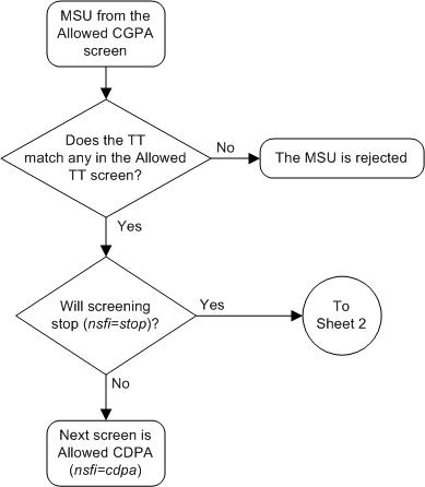

The allowed translation type (TT) screen is used to screen all SCCP messages which have the specified translation type value in the called party address. The gray shaded areas in Figure 5-4 shows the fields of the SS7 message that are checked by the TT screening function.
Gateway Screening Actions
If a match is not found, the message is discarded.
If a match is found, the nsfi is examined to determine the next step in the screening process. If the nsfi value is any value other than stop, the next screening reference (nsr) is identified and the screening process continues to the next screen identified by the nsfi and nsr parameter values.
If the nsfi is equal to stop, the screening process stops and the message is processed. If a gateway screening stop action set is specified with the screen, shown by the actname parameter value, the message is processed according to the gateway screening stop actions that are assigned to the gateway screening stop action set.

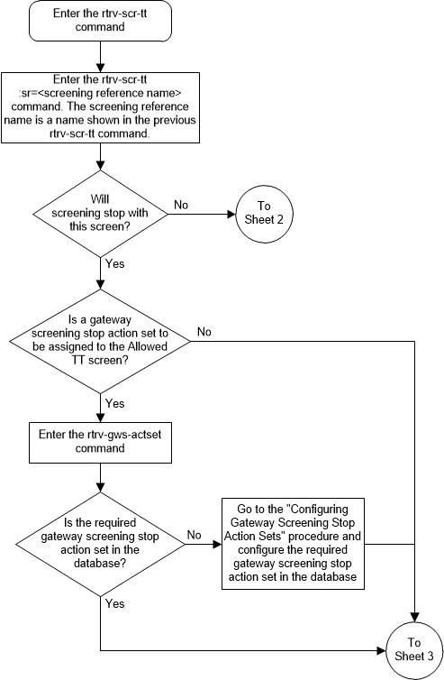

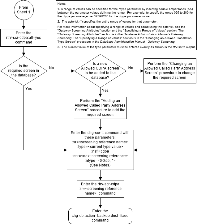

Allowed TT Screening Actions
Figure 5-1 through Figure 5-3 show the screening actions of the allowed TT screen.
Figure 5-1 Allowed TT Screening Actions - Sheet 1 of 3
img/allowed-tt-01-116768.jpg
Figure 5-2 Allowed TT Screening Actions - Sheet 2 of 3
img/gws-stop-actions-01-140964.jpg

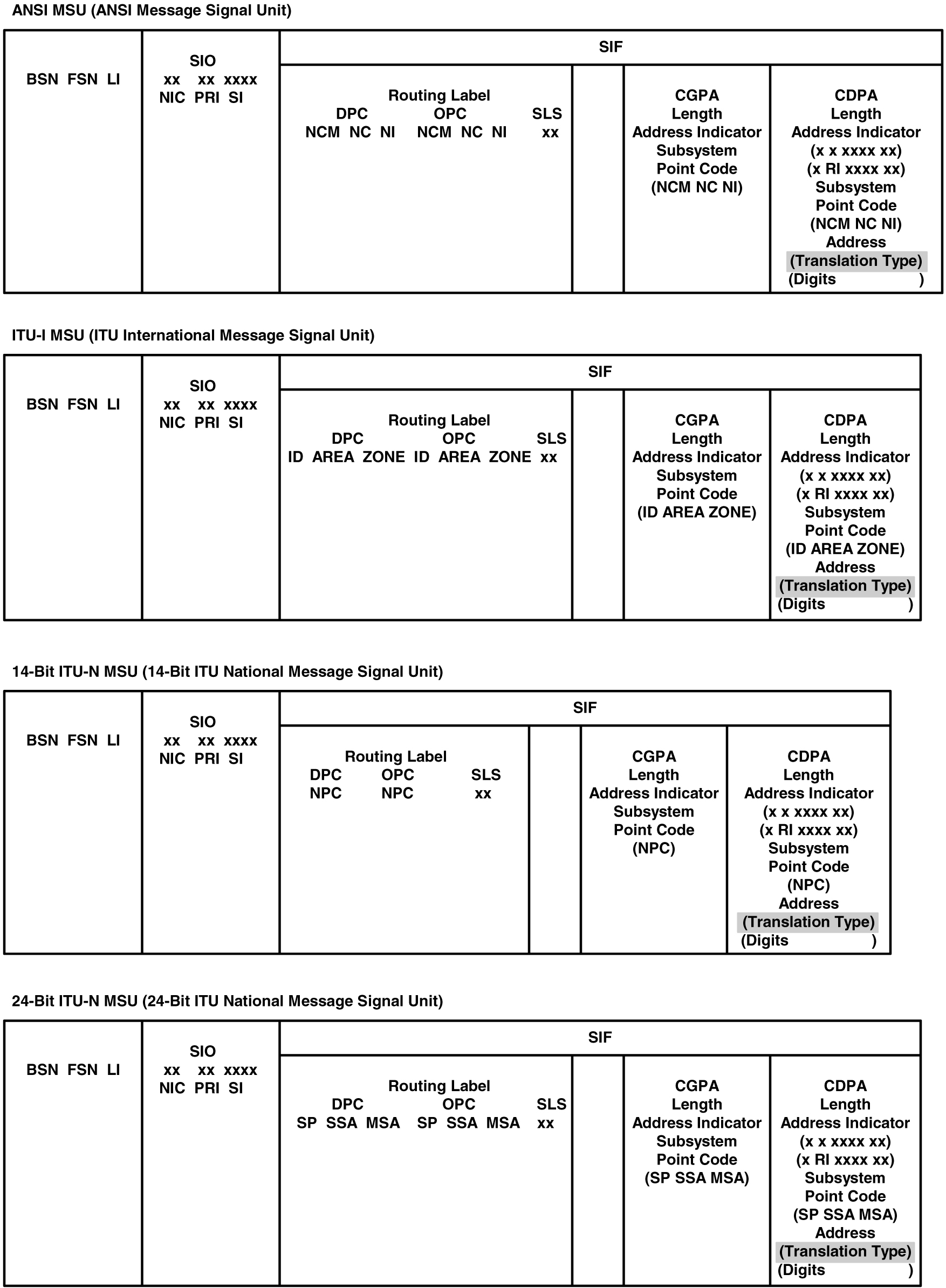

Figure 5-4 Allowed Translation Type Screening Function
img/c-introduction-4-dbags-fig2.jpg

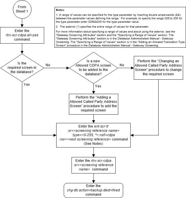

  6. Add a new allowed TT screen to the database using the ent-scr-tt command.
    If a gateway screening stop action is to be assigned to the allowed TT screen being changed, enter the ent-scr-tt command with the nsfi=stop parameter and the actname parameter with the name of a gateway screening stop action set shown in the output of the rtrv-gws-actset command executed in step 4.
    Caution:
    The EAGLE does not support redirecting MSUs for the DTA feature or intercepting ISUP IAM messages for the Calling Name Conversion Facility feature from the allowed TT screen. Gateway screening stop action sets containing either the RDCT (redirect) or CNCF (calling name conversion facility) stop actions should not be assigned to the allowed TT screen. If a gateway screening stop action set containing the RDCT or CNCF stop actions is specified with the ent-scr-tt command, unsolicited information message (UIM) 1128 is generated when the attempt is made to redirect MSUs from the allowed TT screen. Unsolicited information message (UIM) 1218 is generated when ISUP IAM MSUs are intercepted from the allowed TT screen. For more information on UIMs 1128 and 1218, go to the Unsolicited Alarm and Information Messages Reference.
    The value of the type parameter can be from 0 to 255 or an asterisk (*).
    A range of values can be specified for the type parameter. See the Specifying a Range of Values section for more information on how a range of values is used for the type parameter.
    For this example, enter this command.
    ent-scr-tt:sr=gw16:type=250:nsfi=cdpa:nsr=gw18
    A message similar to the following should appear.
    rlghncxa03w 06-10-25 15:28:30 GMT  EAGLE5 36.0.0
    ENT-SCR-TT: SCREEN SET AFFECTED - GW16  1% FULL
    ENT-SCR-TT: MASP A - COMPLTD

Figure 5-5 Add an Allowed Translation Type Screen - Sheet 1 of 3
img/ent-scr-tt-01-300.png

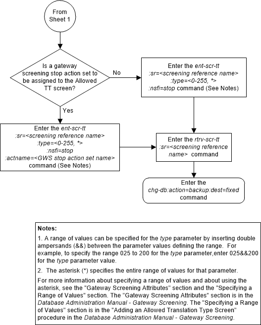

Figure 5-6 Add an Allowed Translation Type Screen - Sheet 2 of 3
img/ent-scr-tt-02-db-manual-ref.png
Figure 5-7 Add an Allowed Translation Type Screen - Sheet 3 of 3
img/ent-scr-tt-03-db-manual-ref.png

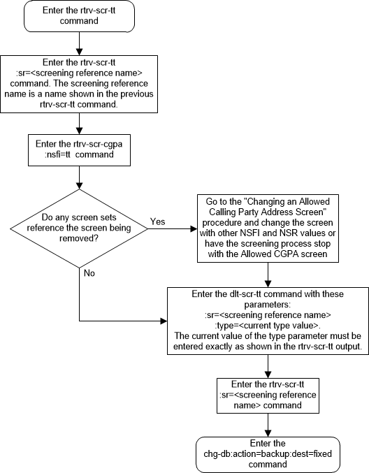

Removing an Allowed Translation Type Screen
This procedure is used to remove an allowed translation type (TT) screen from the database using the dlt-scr-tt command. The parameters used by the dlt-scr-tt command are shown in the Gateway Screening Attributes section. The general rules that apply to configuring gateway screening entities are shown in the Gateway Screening Configuration section.
The example in this procedure removes the allowed TT screen iec, with the translation type 016 from the database.
The allowed TT screen can be referenced by the Allowed CGPA screen. Enter the rtrv-scr-cgpa:nsfi=tt command to verify that this screen does not reference the allowed TT screen being removed from the database.
To change the NSFI of any of these screens, perform the Changing an Allowed Calling Party Address Screen procedure.

Figure 5-8 Remove an Allowed Translation Type Screen
img/dlt-scr-tt-300.png

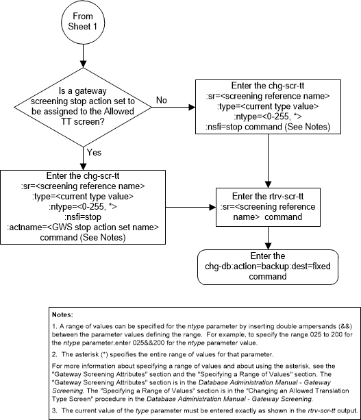

Changing an Allowed Translation Type Screen
This procedure is used to change the attributes of an allowed translation type (TT) screen in the database using the chg-scr-tt command. The parameters used by the chg-scr-tt command are shown in the Gateway Screening Attributes section. The general rules that apply to configuring gateway screening entities are shown in the Gateway Screening Configuration section.
The example in this procedure is used to change the translation type 016 for the allowed CGPA screen iec to 210 and change the NSFI to stop.

Figure 5-9 Change an Allowed Translation Type Screen - Sheet 1 of 3
img/chg-scr-tt-01-300.png
Figure 5-10 Change an Allowed Translation Type Screen - Sheet 2 of 3
img/chg-scr-tt-02-db-admin-ref.png
