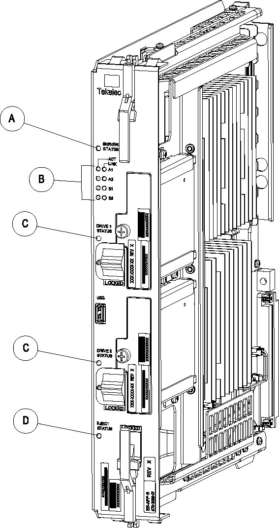

E5-APP-B Card LEDs
This section describes the LEDs found on the front face of the E5-APP-B card.
Server Panel LEDs
Figure 3-1 shows the E5-APP-B card LEDs on the front panel
Figure 3-1 E5-APP-B Card LEDs
img/card_overview-2.jpg
The following light-emitting diode (LED) status indicators can be found on the E5-APP-B card:
  • One Server Status indicator (A)
  • Four E-Net link and Active LED status indicators (B)
  • Two drive module status indicators (C)
  • One Card Eject status indicator (D)

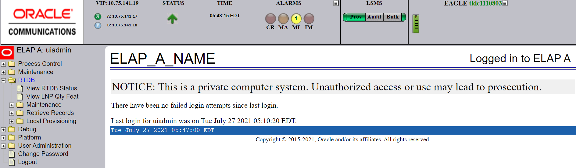

Displaying Errors on ELAP GUI
If the ELAP application detects an application error or receives an alarm message from the platform layer, the ELAP application displays the error on the graphical user interface (GUI):
  • With a text message running across the banner.
  • By illuminating the alarm level indicator on the GUI that corresponds to the alarm level of the error. If that alarm level indicator is already illuminated, the number shown on the indicator is incremented. For details about the alarms represented by the indicator, click the alarm button.
The following figure shows an example of errors displayed on the ELAP GUI.
Figure 3-2 Errors displayed on ELAP GUI

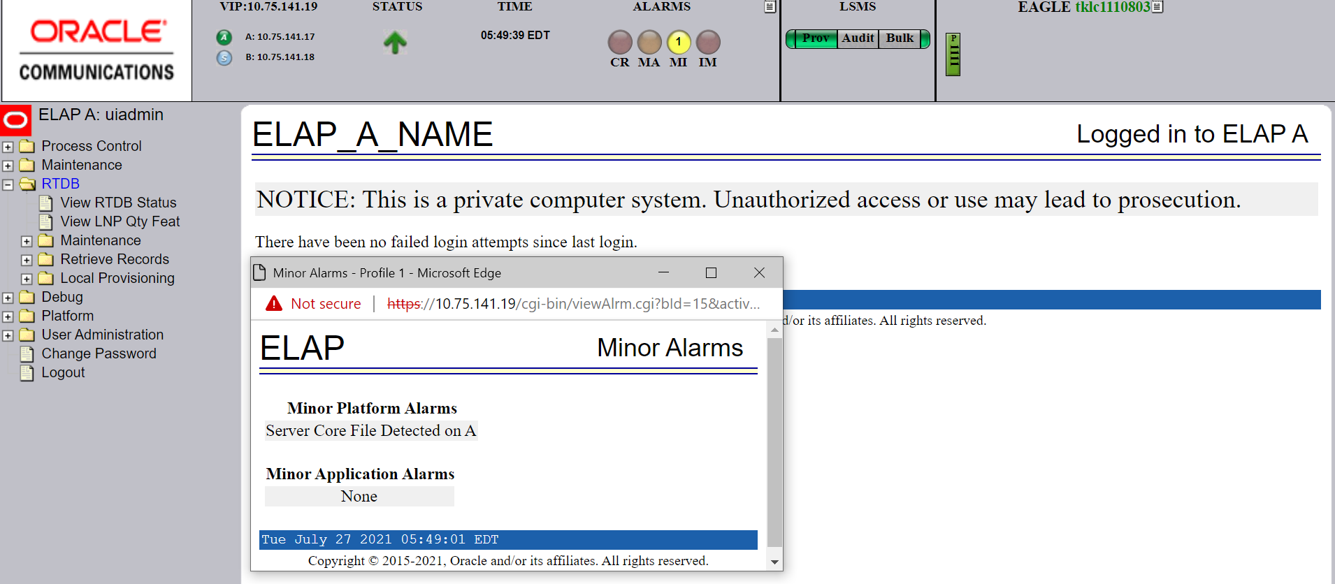

To obtain additional information about the alarms, click any lighted alarm indicator. A pop-up window is displayed, showing the number of each type of alarm and listing the text of each existing alarm in each type. The following figure shows an example.
Figure 3-3 Viewing Alarm Details
When an alarm value in the Alarm View popup window represents multiple alarms, the text of each alarm being reported is displayed. The individual alarm text is found in Alarm Categories. To correct the alarm condition, perform the associated procedure described in Recovering From Alarms.
The reported alarm values may represent multiple alarms. To determine which alarms are indicated, perform Decode Alarm Strings. After determining which alarms are being reported, find the individual alarm numbers in Platform and Application Alarms.
