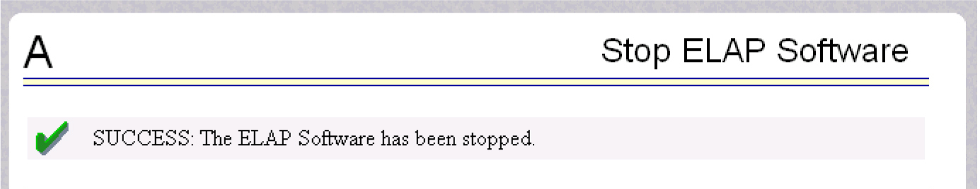

  5. Select Process Control>Stop Software to ensure that no other updates are occurring.
    The screen shown in Figure 4-1 is displayed.
    Figure 4-1 Stop ELAP Software
    img/t_restoring_databases_from_backup_files_mps_maintenance_t1100mps_maintmanual-fig1.jpg
    After the software on the selected ELAP has stopped, the screen shown in Figure 4-2 is displayed.
    Figure 4-2 Stop ELAP Software - Success
    img/t_restoring_databases_from_backup_files_mps_maintenance_t1100mps_maintmanual-fig2.jpg

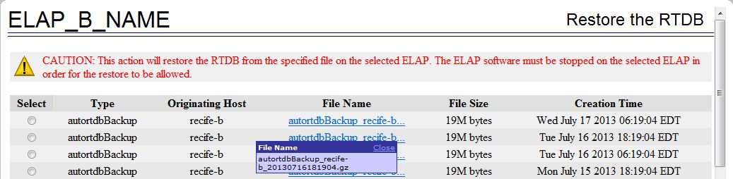

  6. Select RTDB>Maintenance>Restore RTDB.
    The screen shown in Figure 4-3 is displayed.
    Figure 4-3 Restoring the RTDB
    img/capture_restore_rtdb_elap.jpg
  7. On the screen shown in Figure 4-3 , select the file that was transferred in 3. Click Restore the RTDB from the Selected File.

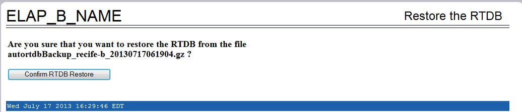

  8. To confirm restoring a file, click Confirm RTDB Restore shown in Figure 4-4.
    Figure 4-4 Restore the RTDB Confirm
    img/capture_restore_rtdb_confirm_elap.jpg
    After the file is successfully restored, the success screen is displayed.

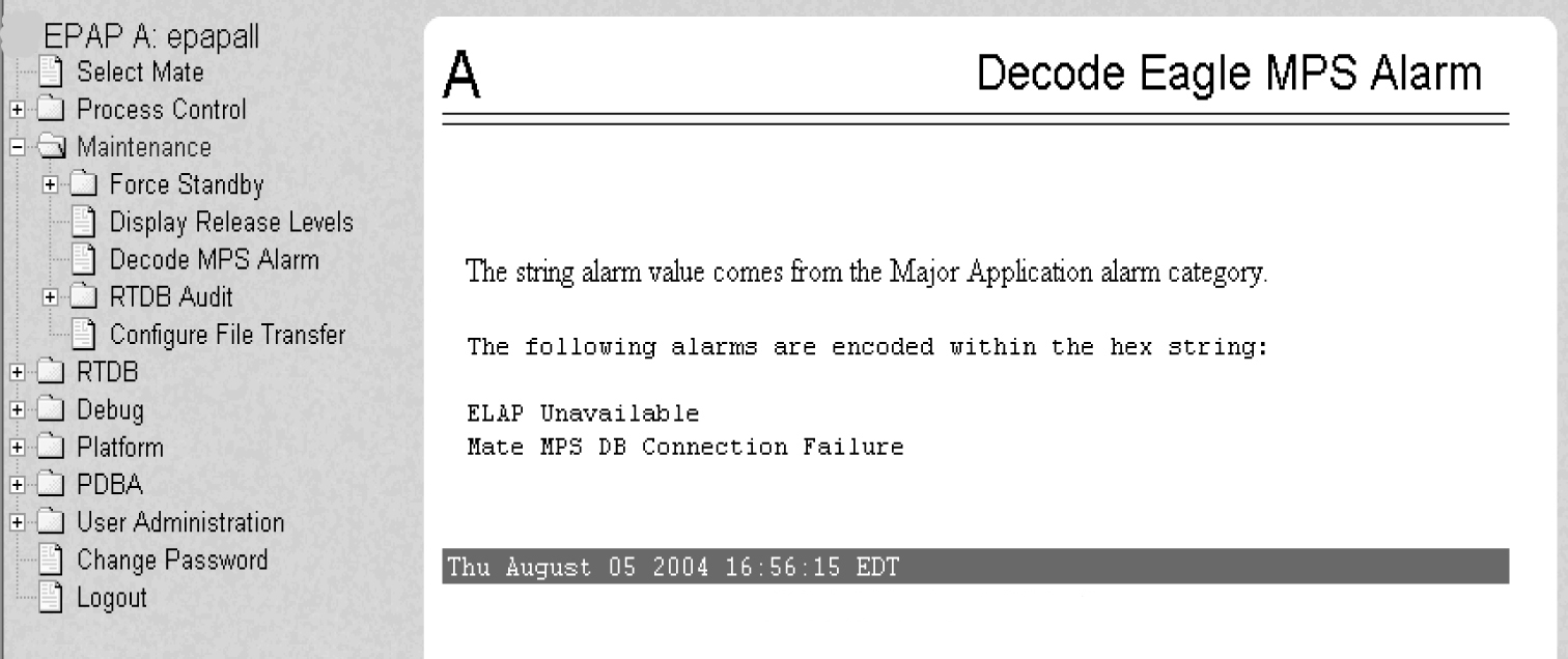

  1. Log in to the User Interface screen of the ELAP GUI (see Accessing the ELAP GUI Interface).
  2. After logging in to the ELAP, select Maintenance>Decode MPSAlarm from the menu.
  3. Enter the 16-digit alarm string into the window on the Decode MPSAlarm screen, as shown in Figure 4-5.
    Figure 4-5 Decode MPS Alarm Screen
    img/t_recovering_from_alarms_mps_maintenance_t1000mps_maintmanual-fig1.jpg
    img/t_recovering_from_alarms_mps_maintenance_t1100mps_maintmanual-fig1.jpg

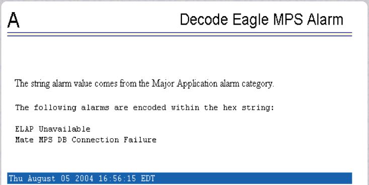

  4. Click the Decode button.
    The system returns information on the Alarm Category (Critical Application, Major Platform) and error text, as shown in Figure 4-6.
    Figure 4-6 Decoded MPS Alarm Information
    img/t_recovering_from_alarms_mps_maintenance_t1000mps_maintmanual-fig2.jpg
    img/t_recovering_from_alarms_mps_maintenance_t1100mps_maintmanual-fig2.jpg
  5. Find the alarm text string shown on the GUI in Table 5-1. Note the corresponding alarm number change. Perform procedure Determine Alarm Cause.
