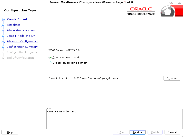

  4. On the Create Domain screen, select Create a new domain, and click Next.
    Create Domain screen gives the user an option for creating a new domain, and another one for updating an existing one. Below the options list, there's a field to define the domain location.
    Field Name and Description Value
    Domain Location: Enter the location where the apex_domain can be created. Example: </u01/ouaw/domains/apex_domain>

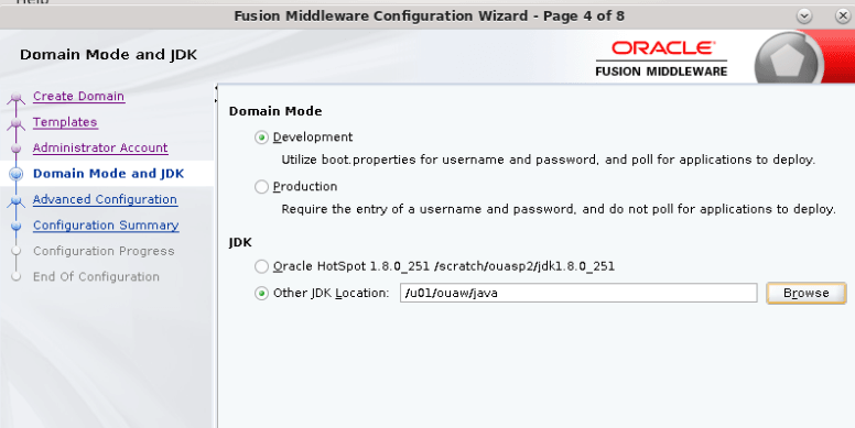

  7. On the Domain Mode and JDK page, select the options as shown below, and click Next.
    Select Production option under Domain Mode, and Other JDK Location under JDK.
    Domain Mode: Select the appropriate domain mode. Production mode
    JDK: Select the JDK location using a browser. Example: <JAVA HOME>

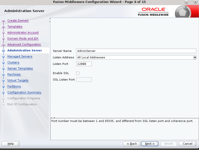

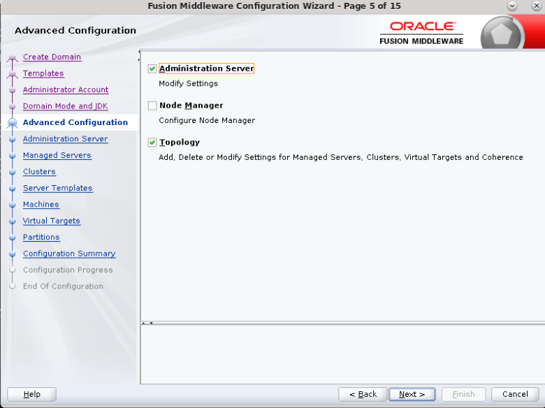

  8. On the Advanced Configuration page, select Administration Server and Topology.
    Advanced Configuration screen shows three options with their respective checkboxes.
  9. On the Administration Server page, enter the values as in the table below, and click Next.
    Administration Server screen shows the three fields to be populated by the user in accordance with the table.
    Server Name: Enter the Admin server name. AdminServer
    Listen Address: Enter the listen address. All local addresses
    Listen Port: Enter the listen port number. Example: <12000>

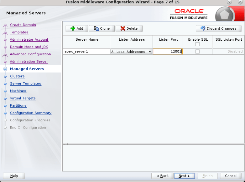

  10. On the Managed Servers page, enter the following values to add a managed server. Click Next.
    Managed Servers screen displays a five column table containing the name, the listen address, and the listen port; the fourth column has a checkbox for enabling SSL, and the fifth column shows the SSL Listen Port status.
    Server Name: Enter the managed server name. Example: <apex_server1>
    Listen Address: Enter the listen address. All local addresses.
    Listen Port: Enter the listen port number. Example: <12001>

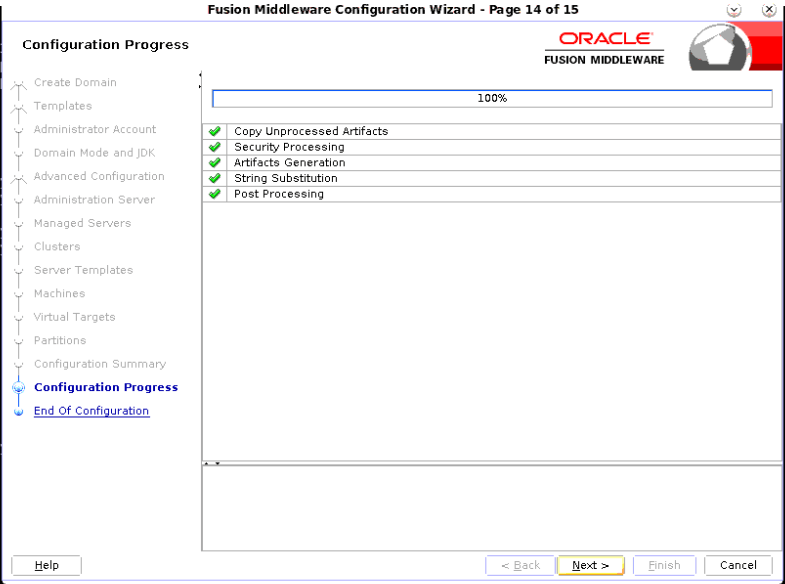

  13. On the Configuration Progress page, wait until the progress bar is 100% complete and then click Next.
    This screen shows the configuration's progress percentage.

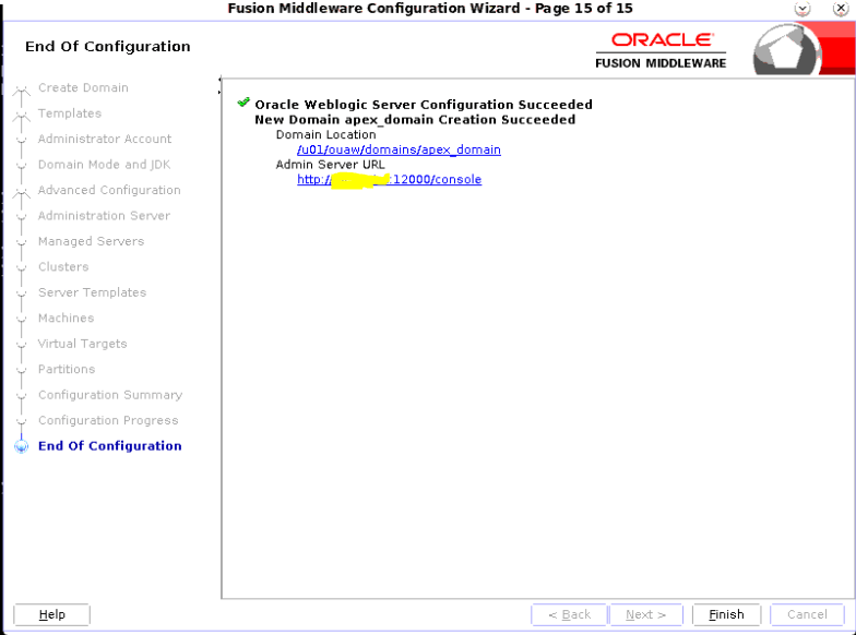

  14. On the End Of Configuration page, you will find the domain path and the administration server URL that will be used in the following steps. Click Finish.
    This screen shows the configuration status, the domain location, and the administration server URL.

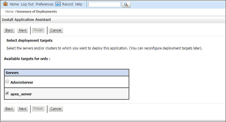

  4. Select the deployment target as <apex_server1>.
    This screen shows the Install Application Assistant. Select the appropriate option in the Servers table.

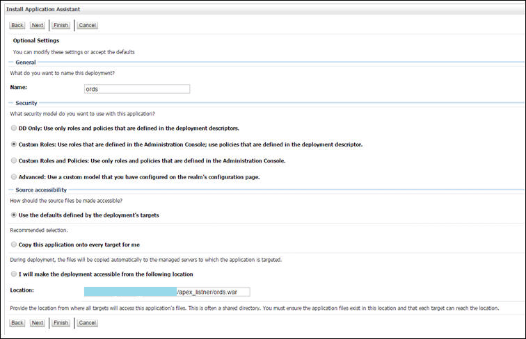

  5. Enter the following information on the application assistant:
    Install Application Assistant page, where the user is to select options in accordance with the table below.
    Name: Enter the deployment name. ords
    Security: Select the security model to be used. Select the Custom Roles option.
    Source accessibility: Select the source accessibility option. Select theUse the defaults defined by the deployment's targetsoption.
  6. The location of ords.war file and target will appear on the Summary section. Click Finish.

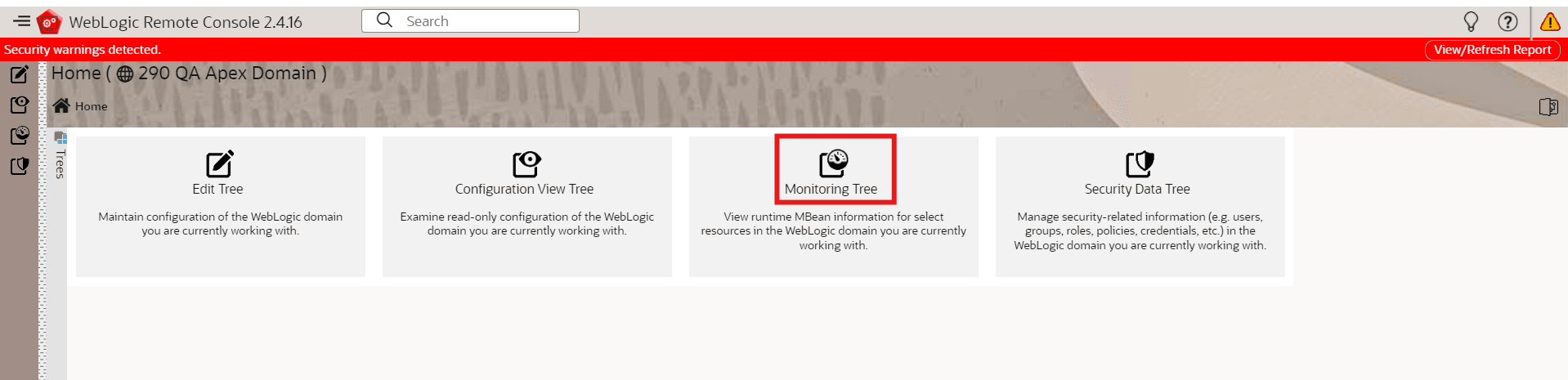

Installing ords.war and i.war in WebLogic 14c

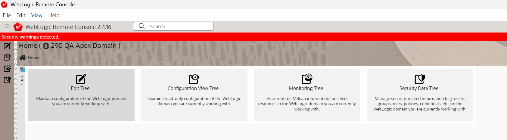

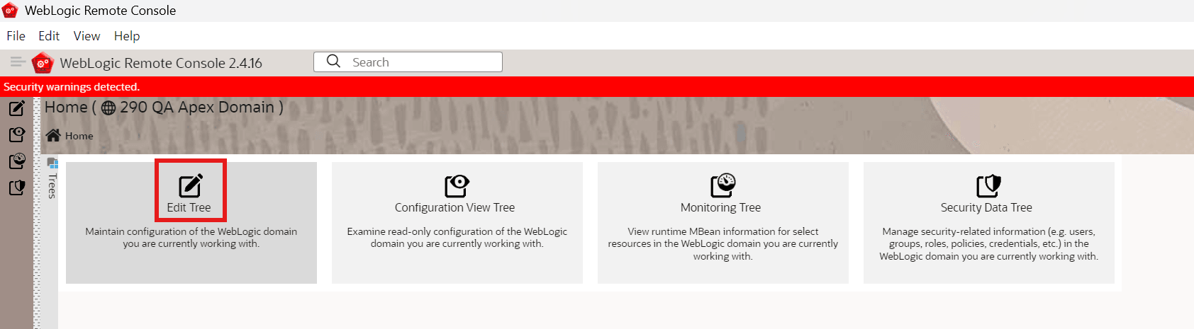

To access the WebLogic 14c admin console, you need to install the WebLogic Remote Console in your system. Refer to WebLogic Remote Console for more information.
  1. Log in to the <apex domain> WebLogic administration console.
    This is the WebLogic administration console.

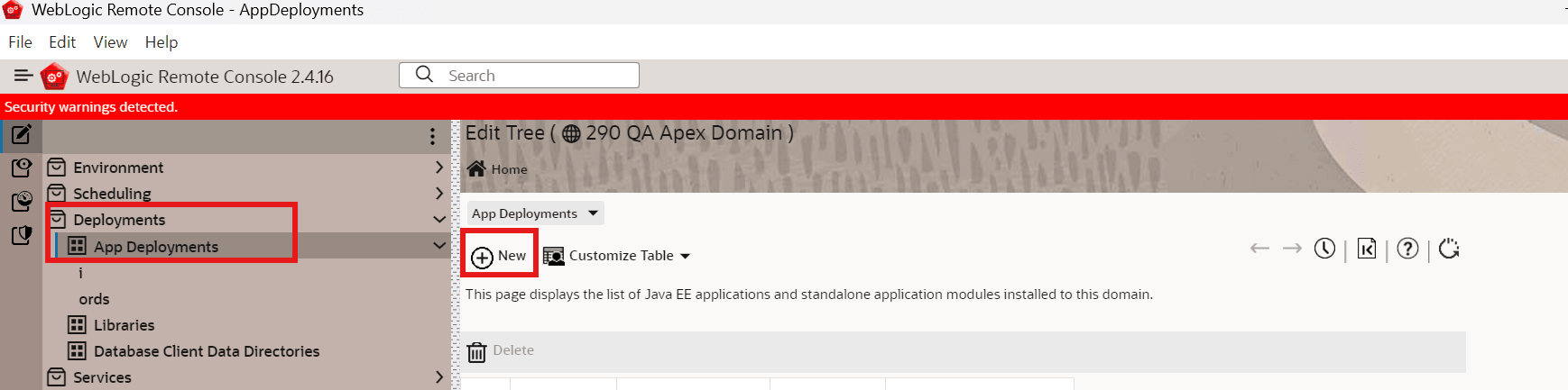

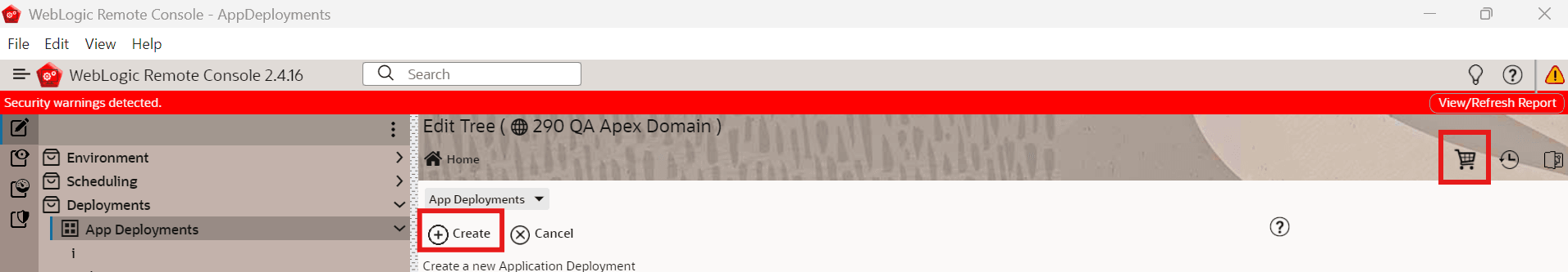

  2. Navigate to Edit Tree > Deployments > App Deployments > New.
    This allows you to maintain the configuration of the WebLogic domain you are currently working with.
    This allows you to create a Java EE application or standalone application module that will be installed in the domain you are currently working with.

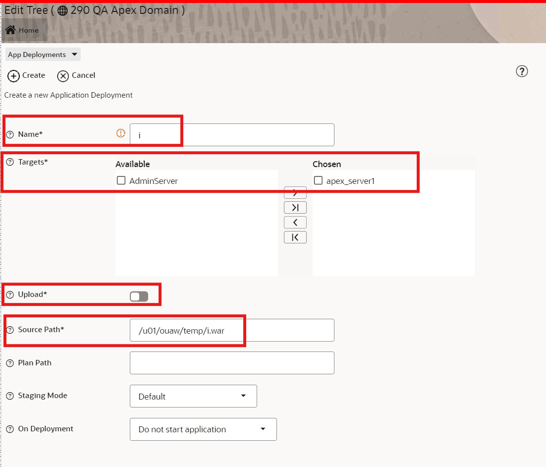

  3. Enter the appropriate values for Name (Example: i), Targets (Example: Apex Managed Server apex_server1), and Source Path (Example: full path of the i.war file location).
    This populates the general information of the application deployment.
  4. Click Create and Save then the Commit Changes (img/ouaw-weblogic-remote-console-commit.png) button.
    This creates and saves your new application deployment.
  5. Repeat steps 2 to 4 to deploy the ords.war file.

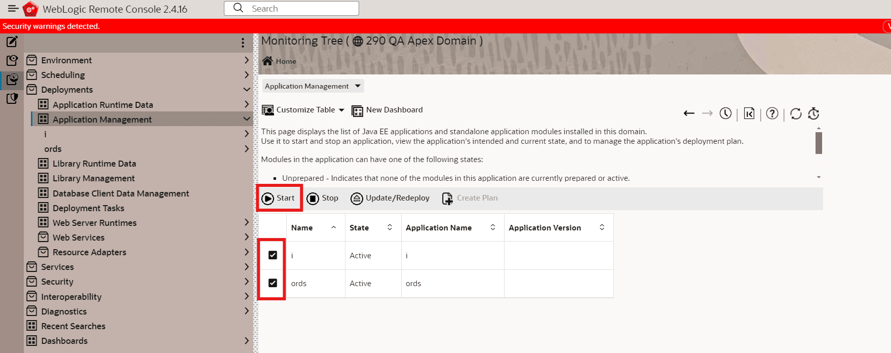

  6. Navigate to Monitoring Tree > Deployments > Application Management.
    This enables you to view runtime MBean information for select resources in the WebLogic domain you are currently working with.
  7. Select the i and ords checkboxes then click Start > Servicing All Requests.
    This allows you to select and monitor the app deployment in the WebLogic domain you are currently working with.

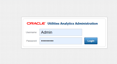

Access the AdminTool
  1. Access the AdminTool from the following URL: http://<hostname>:<apex_server1_port>/ords/f?p=104
  2. Provide the following credentials to access the Admin Tool.
    Username: Admin
    Password: Admin_123
    Oracle Analytics Administration login screen.
    After logging in to the application for the first time, you will be asked to change your password.
  3. After logging in, you can get the following Admin Tool access to ETL Configuration and ETL Job Execution.
    Oracle Utilities Analytics Administration Home tab. Find the mentioned sections in the left-hand pane.
