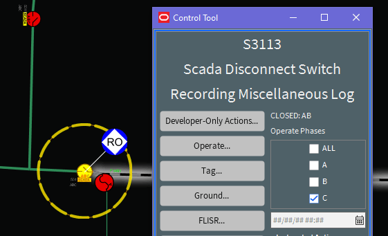

You can access the Control Tool from the Viewer by double-clicking a device or by selecting a device and then clicking the Control Tool button () on the Viewer toolbar. If you click the Viewer drawing area without selecting a device, the system selects the nearest device.
The name of the device and its type are displayed at the top of the Control Tool. When operating in Real Time with Web Switching enabled, the tool recording the steps will also be displayed at the top of the Control Tool. Tools that record steps include Switching Sheets, Standalone Safety Documents, Event Details Steps tabs, and the Miscellaneous Log. The recording tool label will be hidden in Study mode if no tool is actively recording Study actions.
The left side of the Control Tool provides a set of buttons with options that you can perform; the options that appear differ depending on the type of device that the Control Tool was opened from (pipe, valve, pump, cable, conductor, transformer, fuse, and so on).
Control Tool Actions
Control Tool operations and functions are performed by clicking their corresponding buttons. The following table describes common Control Tool buttons and the actions that they perform.

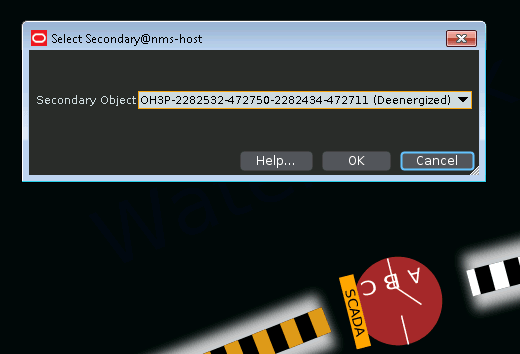

• Secondary Device Actions
• Open Backfeed
• Instruct Open Backfeed
• Close Backfeed
• Instruct Close Backfeed
• Open Main & Close Backfeed
• Instruct Open Main & Close Backfeed
• Open Backfeed & Close Main
• Instruct Open Backfeed & Close Main

Operate Phases
Allows you to operate all or specific phases of a device by toggling All or any combination of A, B, and C phases. Any phases not applicable to the device are disabled (for example, the Control Tool for an A phase transformer will have B and C disabled). This option is disabled if the selected device is ‘gang-operated.'

Operating Devices
You can open or close a device in the Viewer to reflect the current state of the device in the field. The Control Tool's available device operation options depend on the status of the device. For example, a Control Tool opened from an open device will only allow you to close the device. In real-time mode, you must have authority over the control zone where the device is located in order to operate the device.
If a device has multiple phases and you only want to open or close one of the phases, you can select which phase you want to operate using the toggle buttons in the Operate Phases section on the right side of the Control Tool.
Note: Phase selection is disabled when the selected device is ‘gang-operated'.
The Control Tool's Operate Phases pane displays the phases available for the selected device. A label above the Operate Phases section indicates the phases that are currently closed. For example, in the image below, a three phase switch is shown in the Viewer with the A and B phases abnormally open; the Control Tool shows that the C phase is closed and its Operate Phases pane lists all three phases available on the device.Screen captures showing a single-phase selection in the Operate Phases pane.
The Control Tool opens with the All phases checkbox selected whether the device is single phase, two phase, or three phase. You can select one or more phases to perform actions. If you attempt to perform open or close operations on phases that have already been operated, the system will offer to correct the phase selection for you.
Opening a Device
To open one or more phases on a device:
1. Open the Control Tool for a closed device.
2. Select the phase or phases that you want to open. If you wish to open all closed phases, you may leave ALL selected (which is the default).
3. Click Open. The selected phases for the device open. If no phase is selected, an error message will be displayed.

3. Click on the Ground... button and select Place Ground from the drop-down list. The Select Secondary Object dialog box will open.
The Select Secondary dialog box's option list allows you to select a conductor from all conductors attached to the device on the side you want to ground. Once selected, the conductor will be highlighted in the viewer. Screen capture illustrating selecting a secondary option when placing a ground.
4. Select the conductor and click OK.
If you are grounding a live conductor, the Add Ground Error dialog box opens with a warning: Danger! This operation would ground a live section.
To abort a grounding operation, click Cancel.
5. Click OK to proceed with the ground. A ground symbol will appear on the device in the Viewer.Screen capture of a switch with a ground symbol.

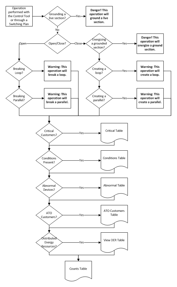

Using the Look Ahead Dialog Box
The Look Ahead dialog box provides information concerning the results of performing a requested device operation. The Look Ahead dialog box uses system status and topology tracing to "look ahead" of the requested operation and determine its consequences.
The Look Ahead dialog box displays whenever you attempt to perform an action that would result in the distribution system status or topology changing (that is, a switching operation). Once you have looked at key information in the Look Ahead dialog box, you may perform or cancel the operation.
This section includes the following topics:
Understanding the Look Ahead Process
The Look Ahead dialog box displays whenever a switching operation is initiated from the Control Tool in energized or de-energized portions of the distribution system. The Look Ahead dialog box displays a warning if an operation will create or break loops or parallels. Counts, conditions, and abnormal device information are not available when dealing with loops and parallels.
If the operation will outage or restore the system, additional data is gathered and displayed in the Look Ahead dialog box. The information displayed depends on the results of performing the operation. A tab is enabled only if table information is available. You cannot open or close a device until you view any abnormal devices or conditions (see View Abnormal Tab).
Note: If you attempt to open a switch in an outage area, the system displays the Create Nested Outage dialog box before displaying the Look Ahead dialog box. The dialog box provides the following options:
• Click Yes to create a nested outage.
• Click No to open the switch without creating a nested outage.
• Click Cancel to cancel the operation.
The following flow diagram below shows the basic logic of the Look Ahead dialog box.
Flow diagram showing the basic Look Ahead Tool logic.

When you perform actions in the Control Tool while you are recording in Web Switching Management, the system automatically populates fields in the associated switching sheet as follows:
• The date field on the Control Tool, which defaults to the current date and time, is used to populate the Completed Date field in the associated switching sheet when an operation is completed in the Control Tool.
• If steps are instructed to a crew, this date is used to populate the Instructed Date field in the switching sheet.
The Instructed Actions area below the date field displays a list of actions that have been instructed on the selected device. The drop-down list allows you to select an instructed action to complete.
The Show Sheet... button displays the sheet that contains the selected instructed action so you can execute the actions from Web Switching Management.
Note: This option is available only when Web Switching Management is licensed. This allows you to navigate to the switching sheet so you can perform the step from there. If you are not using Web Switching Management, you can Complete, Abort, or Fail the selected instructed action from the Control Tool.
