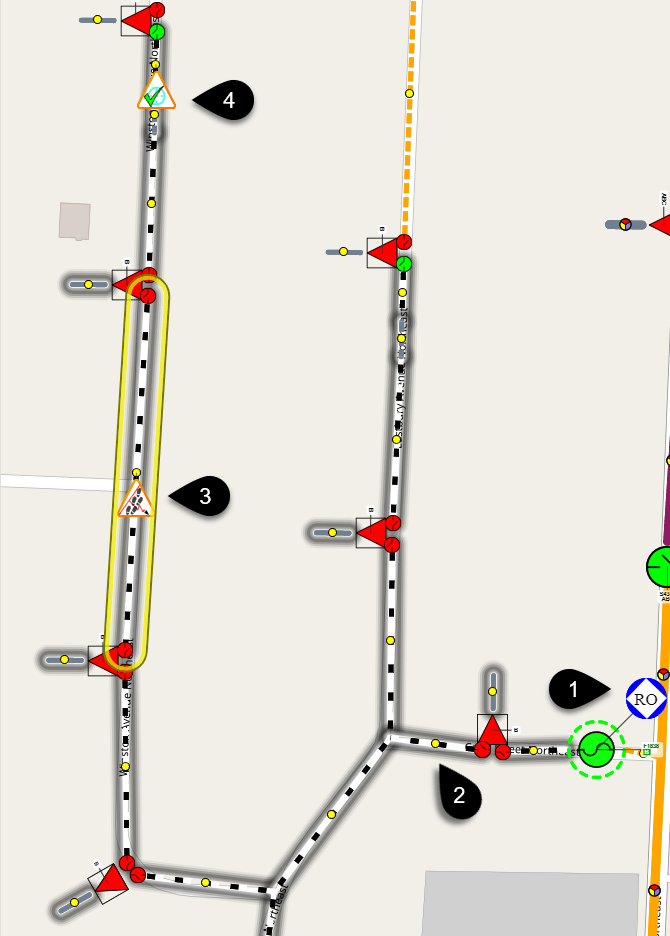

The Map provides visual cues and symbols to represent devices, events, and conditions. For example, the following screen capture depicts [1] an abnormally open switch with a real outage (RO symbol), [2] the resulting de-energized section of the network, [3] a highlighted segment with a Patrolling symbol, and [4] a device patrolled symbol.
You can view conductor and highlight coloring meanings by selecting the "Open the Legend Panel" option [1] on the Map toolbar. The legend slides out from the right side of the Viewer [2].
Screen capture of Map with callouts to sections of the network: yellow conductor signifies a patrolled section, pink signifies the probably/predicted extent of an outage, and gray signifies a de-energized section.

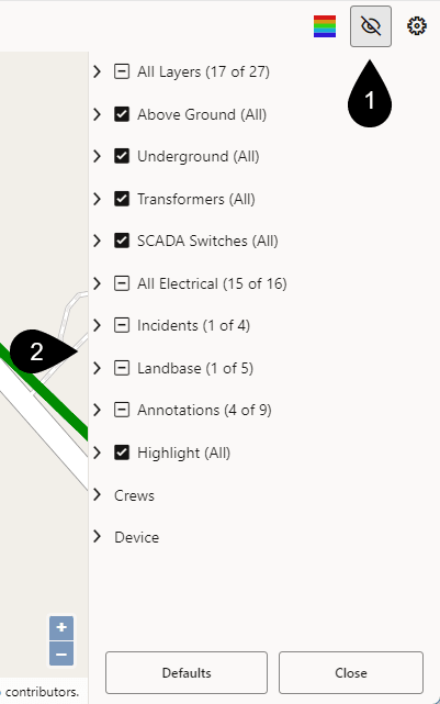

Map Hide/Display Options
The Hide/Display panel allows you to select what devices or map components to show or hide. Select the Hide/Display toolbar button [1] to open the panel [2]. See Hiding and Displaying Viewer Objects for more information.
Illustrated screen capture showing the Hide/Display button activated and the panel displayed.
You can also press Ctrl+Shift+F to open the panel.
The panel is broken down into a number of collapsible sections, with each section containing a number of check‑boxes or radio buttons that control which objects and conditions should be shown on the map. Most of the sections consist entirely of check‑boxes, and for these the entire section can be toggled on/off even when the section is collapsed, using the check‑box in the section's title bar.
The sections represent conceptual groupings of object types and so can have overlapping contents where the same item belongs to several groups, for example "Network Transformers" can be found under "All Layers", "Underground", "Transformers" and "All Electrical". This allows entire groups of related object types to be toggled on/off with a single action.
The settings in this panel can be restored to their configured default values at any time using the "Defaults" button at the bottom of the panel.
The standard product configuration provides the following sections:
All Layers: This section contains all of the layer based filters.
Landbase: Toggle the visibility of the landbase (if one is selected in the Settings panel).
Overhead Conductors: Toggles the visibility of overhead conductors.
Underground Cables: Toggles the visibility of underground cables.
Underground Fuses: Toggles the visibility of underground fuses.
Secondary: Toggles the visibility of the secondary network.
SCADA Disconnects: Toggles the visibility of SCADA disconnects.
SCADA Circuit Breakers: Toggles the visibility of SCADA circuit breakers.
Other SCADA: Toggles the visibility of other SCADA map components which do not have a specific toggle.
Overhead Transformers: Toggles the visibility of overhead transformers.
Substation Transformers: Toggles the visibility of substation transformers.
Network Transformers: Toggles the visibility of network transformers.
Padmount Transformers: Toggles the visibility of padmount transformers.
Elbows: Toggles the visibility of elbows.
Other Electrical: Toggles the visibility of other electrical map components which do not have a specific toggle.
Supply Nodes: Toggles the visibility of supply nodes.
Structures: Toggles the visibility of structures such as poles.
Manholes: Toggles the visibility of manholes.
Roads: Toggles the visibility of roads modeled in NMS.
Street Intersections: Toggles the visibility of street intersections modeled in NMS.
Waterways: Toggles the visibility of waterways modeled in NMS.
Other Landbase: Toggles the visibility of other landbase elements modeled in NMS that do not have a specific toggle.
Measurements: Toggles the visibility of digital and analog SCADA measurements.
Limits: Toggles the visibility of limit data if the Measurements option is selected.
Show All Calls: Toggles the visibility of all customer calls.
Show All AMI: Toggles the visibility of all AMI‑related conditions.
Show FLA By Default: Toggles the visibility of all FLA‑related conditions.
Show All Damage: Toggles the visibility of damage assessments on devices that are not the main asset of the damage assessment.
Above Ground: A subset of the "All Layers" section.
Underground: A subset of the "All Layers" section.
Transformers: A subset of the "All Layers" section.
SCADA Switches: A subset of the "All Layers" section.
All Electrical: A subset of the "All Layers" section.
Incidents: A subset of the "All Layers" section.
Landbase: A subset of the "All Layers" section.
Annotations: Controls the display of various annotations such as labels.
Conductor Current Phase Markers: Toggles the visibility of the current phase markers on conductors. These indicate the current phase of the conductor using a colored indicator with the colors indicating the phases. Either a single dot for single phase, a circle with 2 colored halves for 2 phase conductors, or a circle broken into 3 colored sections for 3 phase conductors. These will be placed at intervals along the conductors so the phase can be easily determined.
Condition Labels: Toggles the visibility of labels on certain types of condition, for example events or crews.
Device Labels: Toggles the visibility of device labels.
Device Nominal Phase Labels: Toggles the visibility of nominal phase labeling on devices - this indicates the nominal phases and their current energized state, with color highlighting when the phase is in an abnormal state.
Conductor Nominal Phase Labels: Same as above for conductors.
Conductor Feeder Labels: Toggles the visibility of labels on conductors which indicate their nominal feeder.
Flow Direction: Toggles the visibility of electrical flow direction arrows on conductors. This will use power flow analysis if it is enabled on the system.
Highlight: These options toggle the visibility of highlights on devices and conductors.
Predicted De-energized: adds a glow around primary conductors that are predicted to be de-energized.
Predicted Secondary De-energized: adds a glow around secondary conductors that are predicted to be de-energized.
Confirmed De-energized: adds a glow around primary conductors that are confirmed to be de-energized.
Confirmed Secondary De-energized: adds a glow around secondary conductors that are confirmed to be de-energized.
Confirmed Degraded: adds a glow around primary conductors that are confirmed to be degraded.
Confirmed Secondary Degraded: adds a glow around secondary conductors that are confirmed to be degraded.
Distributed Generation: adds a glow around conductors fed (or partially fed) by distributed generation.
Powerflow Violations: adds a glow around devices or conductors that have a power flow violation.
Powerflow Warnings: adds a glow around devices or conductors that have a power flow warning.
Voltage Angle Violations: adds a glow around devices or conductors that have a voltage angle violation.
Assessed: adds a glow around conductors that have been marked as assessed.
Crews: Controls the visibility of crew symbols.
Assigned Crews: Controls the visibility of the assigned crews.
Crew Types: Toggles the visibility of the different crew types configured in the system, for example "Tree Crew" or "Line".
Device: Options related to device characteristics.
Network Level: Allows the user to choose between "All Primary", "Backbone and Laterals", "Backbone Only", "SCADA Only" and "Primary and Secondary".
Phases: Allows the user to choose between "All", "3-Phase Only" and "Multi-Phase".
Pending Devices: Allows the user to choose to display construction pending, decommissioning conditions and inactive devices.
Note that the Roads, Street Intersections, Waterways, and Other Landbase options toggle visibility of these elements which have been modeled in NMS, not those provided as part of the geographic map landbase.

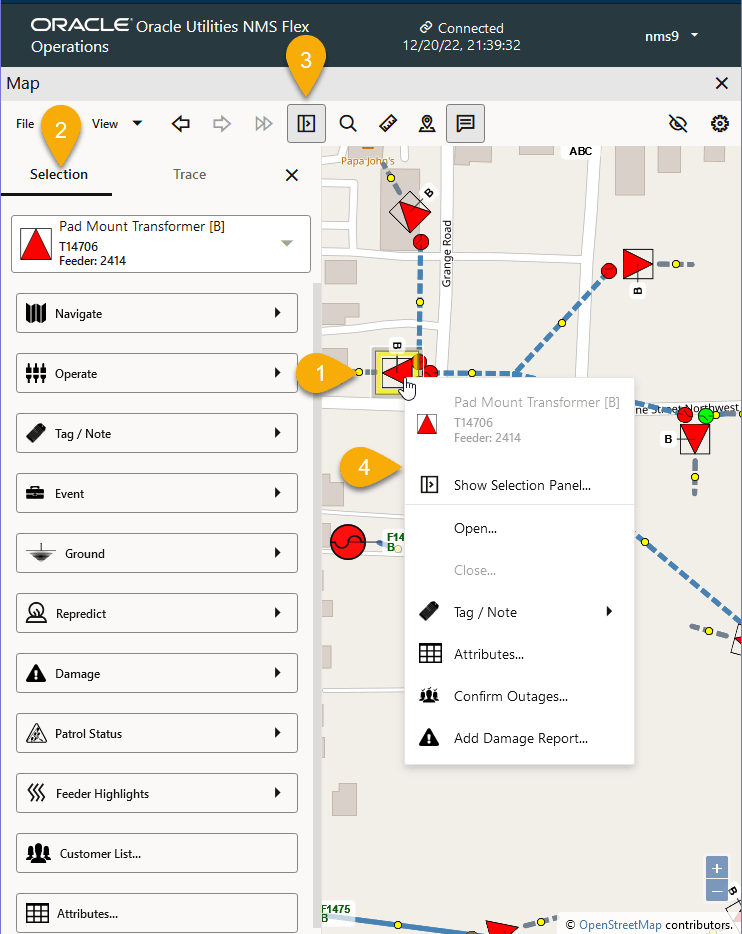

Selecting and Interacting with Map Objects using the Selection Panel
When you select a device or symbol, it will be highlighted or outlined in yellow [1]. The Selection Panel will be displayed [2] when the Selection Panel icon is toggled on [3]. Device operations are available through right-click context menus [4].
The Selection Panel is a combination tool providing actions and information that are found in multiple tools in the NMS operations client (for example, the Control Tool).
Get Directions or Access Other Map Views
The Diamond shape with arrow icon that launches a map application. Navigate menu allows you to select from options based on the object selected.
Directions to Location opens a navigation site (in a new browser tab) to get directions to the object's location.
Cycle Available Geographic and Internal Map Views cycles through different views of the device (schematics, geographic, and so forth).
View Full Extent zooms out to show the device in relation to its network.
Diamond shape with arrow icon that launches a map application. View in Geographic Map changes the Map to the geographic view.
Diamond shape with arrow icon that launches a map application. View Schematic Map changes the Map to the schematic view.
Diamond shape with arrow icon that launches a map application. View Single-Feeder Map changes the Map to show the feeder one line view.
Note: When using Flex Operations on a touchscreen, tap on a device to display a popup menu which enables you to:
Display the selection panel
View the device’s tooltip
Display the device’s right-click menu

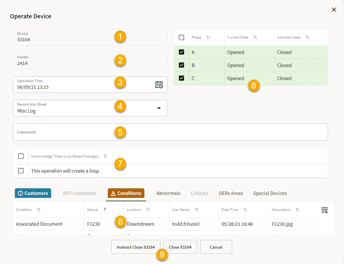

Operating Devices
The Operate Device dialog box is displayed when instructing or completing device operations; it allows you to verify important information before instructing or completing the device operation. It can be displayed from the Map or from a switching sheet.
As illustrated in the screen capture above, the Operate Device dialog box has the following fields and buttons.
1. The Device to be operated.
2. The Feeder for the device to be operated.
3. The Operation Time recorded. Default to the current time, but can be backdated if required, to allow for more accurate recording of time off / time restored.
4. The Record Into Sheet field allows you to choose where the device operation will be recorded. If you are recording into a switch sheet, you can still choose to record the operation into the Miscellaneous Log, if required.
5. The Comment field allows you to add a comment to the device operation. This will be seen in the Comment field in the switching step for the device operation in the switching sheet or Miscellaneous Log.
6. The Phases table allows you to select the phase(s) to be operated. All available phases are selected by default, but can be deselected by clicking the check‑boxes. Clicking anywhere else on a phase row selects that row and deselects other rows.
7. The Look Ahead Messages section displays safety or electrical information messages. For example, warns you that you are going to make or break a loop, or energize a grounded section. These messages must be acknowledged/checked before the command buttons (for example, Instruct Close [Device]) become enabled.
8. The tabbed Look Ahead section provides information relevant to the impending device operation. Some information can be configured such that it must be viewed before operating the device. In cases like this, the tab with the information will oscillate until selected; once the tab has been selected and the page viewed, the command buttons become enabled.
9. Command buttons allow you to instruct or complete the device operation. These buttons will only become enabled once any electrical look ahead messages and conditions have been acknowledged.
You can operate devices as described below.
1. From the Map, select the device, then from the Selection Panel, select Open or Close, as applicable, from the Operate menu.
Note: The Operate Device dialog box will be displayed when executing switching sheet steps.
2. In the Operate Device dialog box, enter information as desired in the top panel. Things you may edit include the phases to be operated, where to record the action to (Miscellaneous Log or a switching sheet), and comments.
3. In the lower part of the Operate Device dialog box, view Look Ahead information. If the action results in conditions that need to be acknowledged, the Conditions tab will jiggle. Select the Conditions tab and view the results of the operation.
Note: For more information see Understanding the Look Ahead Dialog Box.
4. Once you have reviewed the information, click the Open or Close button, as applicable, to complete the operation.
In the Map, the device and network update to reflect the change in state.

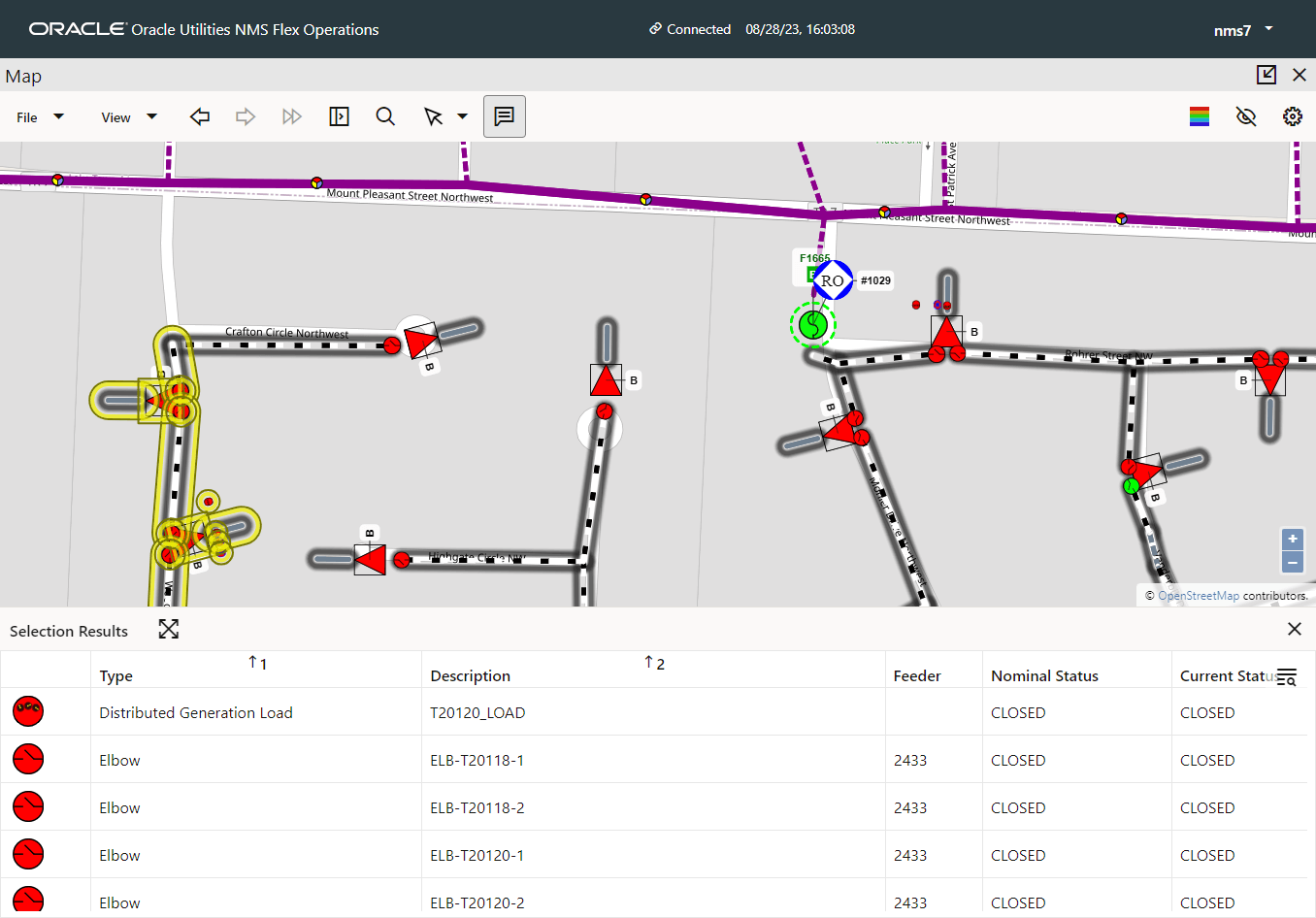

Selecting and Interacting with Multiple Map Objects
There are three tools available for selecting multiple objects on the map, which can be accessed from the tool selector drop down on the Map toolbar (Toolbar icon):
1. Box Selection: When in this mode, you can define a rectangle which will select all objects that overlap with that rectangle. You can define the rectangle by clicking and holding the left mouse button then dragging the mouse, or by clicking or tapping once to define one corner, then clicking or tapping again to define the other, which can be easier to accomplish on a touch device.
Note: This mode can also be accessed by holding shift and then clicking and dragging with the left mouse button. This will suppress the standard panning behavior and perform a box select instead.
2. Circle Selection: When in this mode, you can define a circle which will select all objects that overlap with that circle, by clicking and holding the left mouse button in th center of the circle, then dragging out to increase the radius of the circle.
3. Polygon Selection: When in this mode you can define a polygon which will select all objects that overlap with that polygon. To define the polygon click once to define the start point, then add more points by repeated clicks of the mouse. To complete the definition of the polygon either double click to place a final point and close the polygon, or click the starting point of the polygon again. The start point has an empty circle around it which will show filled when hovered with the mouse, to indicate it will be activated when clicked and close the polygon.
Note that in all of the above multi select modes the resulting selection is updated in real‑time as the selection area is being defined.
In addition to the above tools individual items can be toggled in/out of the selection by holding the Ctrl key while clicking with the left mouse button.
Selection Results Panel
Once a multi-select has been completed the Selection Results panel will be shown to allow the user to explore the objects that were selected.
When an item in the list is clicked it will be selected, the map will move to zoom and center on the object, and the selection panel shown just as if it had been clicked in the map.
When an item in the list is double clicked all of the above will happen and the Selection Results panel will close.
If any item in the map is right clicked then the same menu will be shown as if you right clicked the object on the map, with the addition of a "View on Map and Close Panel" action indicating the default action which will occur on a double click (described above).
After selecting items in the list, if you wish to return to a view with all of the items in the list visible and selected in the map, press the "Position, zoom and select so that the full list is visible and selected" button on the title bar of the Selection Results panel.
Map Selection Filtering
When performing multi-selects of events or crews all of the events or crews in the resulting selection will be filtered in the Events and Crews tool, when map selection filtering is enabled (see Working with the Events and Crews Tool).
