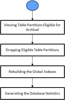

Maintenance - The maintenance process is a process where you archive and then drop the table partitions where all records are eligible for archival. The following figure indicates the steps involved in the maintenance process:
