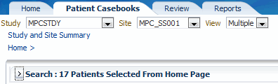

The Patient Casebooks page opens and displays the selected patients in the Casebook Spreadsheet. Note that:
The Search pane is collapsed, and the title in the Search pane indicates the number of patients you selected from the Home page. For example:
- The breadcrumb displays Home > to indicate your navigation path to the Patient Casebooks page.
