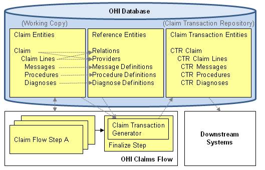

The following diagram illustrates the context of the claim transaction repository within Claims:
The claims flow steps create and update the claim entities (working copy) and when a claim is finalized a 'standalone' claim transaction is created with the details of claims and referenced entities that are required by downstream systems. The claim transaction data model is very similar to the model used during the processing of claims (working copy). The main differences between the models are:
besides the transaction model, additional financial detail can be stored in the Financial Transaction Model. This is not part of the Claims Transaction Repository itself, but also created when executing the transaction creation scenario.
the internal keys and references of the claims model are replaced with external meaningful values in the repository model.
some details of referenced entities are included in the repository model.
While a claim remains finalized, the working copy of the claim and the claim transaction representation of it contain essentially the same details. However, if updates are made to the entities that a claim refers to (for example, if an attribute of a relation was updated), the new values would show if viewing the claim but not if viewing the claim transaction.
If a claim transaction is 'unfinalized', the working copy of the claim will change while the claim transaction repository will preserve values as they were when it was finalized. The claim transaction for the unfinalized claim will be labeled as 'unfinalized' (but not otherwise changed) and a reversal transaction will be created for it. When the claim is refinalized, a new claim transaction will be made for the claim and the working copy and the new claim transaction will be the same. The earlier claim transaction will not be changed.

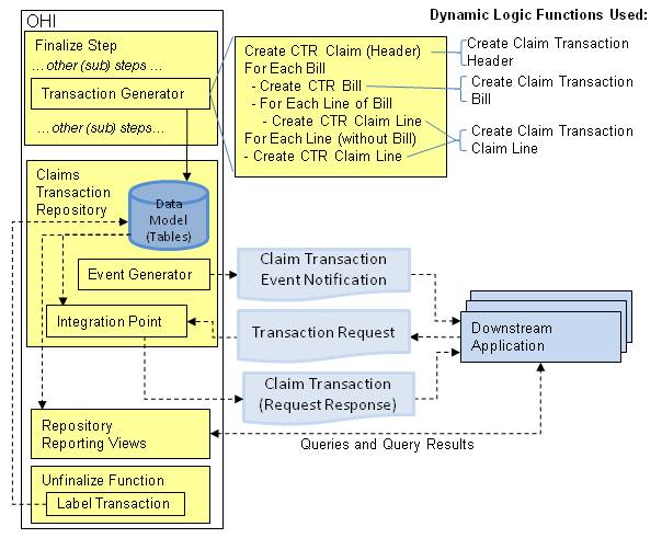

The following diagram illustrates the context and main internal logic of the repository:
Claims Finalize Step
The finalize step is the final step of the claims flow in Claims. In the finalize step, the final processing actions are completed (as described in the "Claims Flow" chapter in the Operations Guide) and a claim transaction is created (using the transaction generator).
The 're-finalization' of a claim also results in a transaction being created and stored in the repository. The only difference is that the transaction resulting from re-finalization is identified as being a new version of the claim (and it contains new values of the claim and referenced entities).
Transaction Generator
This transaction generator creates and stores claim transactions within the finalize step.
The transactions are created in the same unit of work as other finalize actions to ensure that transactions capture values at the time of finalization (and to ensure that transactions are always and only prepared if the claim is actually finalized).
The generator builds a claim transaction 'representation' of a claim from the Claims working copy 'representation' of it using dynamic logic functions. The functions are created as part of system configuration. They transfer the values from claims in Claims and referenced data entities that are needed by any downstream application to the claim transaction. The functions transfer values to both the fixed and dynamic fields of the repository from the fixed and dynamic fields of claims in Claims. This allows flexibility in filling of all fields (fixed and dynamic). The dynamic logic for creating claim transactions is defined within the context of transaction creation scenarios. Different scenarios can be created for different types of claims.
In addition, a financial transactions model is created which serve as a basis for creating payable invoices and accounting entries. They are also created using dynamic logic that is prepared during system configuration.
The transaction generator creates the transactions using the following logic:
A transaction creation scenario for the claim being processed is selected
The Create Claim Transaction Header dynamic logic function is executed
The claim transaction object is instantiated by the dynamic logic function
For each bill of the claim
the Create Claim Transaction Bill dynamic logic function is executed
the bill transaction object is attached to the claim transaction object
For each claim line of the claim:
the Create Claim Transaction Claim Line dynamic logic function is executed
The claim line transaction object is attached to the claim transaction object
For each claim transaction, create a financial transaction and financial transaction process data
the Financial Transaction dynamic logic function is executed
the financial transaction and financial transaction process data is attached to the claim transaction object
For each claim line transaction coverage (part of the claim line transaction object), create a financial transaction detail and financial transaction detail process data
the Financial Transaction Detail dynamic logic function is executed
the financial transaction detail and financial transaction detail process data is attached to the claim transaction object
For each claim transaction, modify the claim transaction object which might entail adding a financial transaction detail
the Financial Transaction Change dynamic logic function is executed
the financial transaction object is attached to the claim transaction object
The claim transaction object is written to the database
Strictly speaking, the financial transactions and its details are not part of the Claim Transaction Repository. They are, however, created at the same time when executing the transaction creation scenario.
This logic illustrates the role of the dynamic logic in creation of claim transactions. The main structure is fixed while the dynamic logic functions determine exactly what the main elements of the message (Claim Header, Bill, Claim Line, Financial Transaction, Financial Transaction Detail, Financial Transaction Change) contain. Note that in all cases, the dynamic logic functions of the selected scenario are used.
Refer to the Repository Configuration section for more details on dynamic field and dynamic logic configuration possibilities.
- Data Model (Tables)
This component holds claim transactions. The details of a claim transaction in the repository are never updated, although an 'unfinalized' label can be added to a transaction. Dynamic fields may be added to the repository in a similar way as to how they can be added to the main claim entities (working copy). Note that the dynamic fields of the repository are not necessarily the same as the ones for the working copy. This is because the repository fields will often hold values from referenced entities in the repository claim entities. They would be native fields in the referenced entities but dynamic fields in the repository model. Likewise, dynamic fields on the referenced entities that are required in the repository would be defined on claim transaction entities as referenced entities are not in the repository (that is, they would be on different entities). Refer to the "Dynamic Fields" section in the Dynamic Logic chapter of the Developer Guide for more details.
- Event Generator
The repository has a configurable event generator. Whenever a transaction is created in the repository or labeled, the event generator checks if the transaction meets the criteria of one or more of the defined events. If it does, notifications for the events are published (with identification details of the transaction needed to retrieve it via the integration point or reporting views). Refer to the Repository Configuration section for details.
- Integration Point
The repository also provides a set of services (Integration Point) to allow downstream applications to access the claim data. Requests to this integration point can result in working copy claims and / or claim transactions being returned. When a working copy claim is returned, it is transformed into a claim transaction without a version. In effect, it is a preview of what the claim transaction for the claim would be if it were finalized at the time of the request. This transformation is done using a transaction creation scenario in the same way that a claim transaction is created when a claim is finalized. The entire transactions are returned in an XML structure. Refer to the Integration Point section for details.

Oracle Health Insurance Repository Reporting Views
This component provides read access to repository transactions for purposes where the full transaction is not required (via the integration point). Refer to the separate "Repository Reporting Views" page in the Developer Guide for details.
Oracle Health Insurance Unfinalize Function
The claim unfinalize functionality in Claims allows a finalized claim to be changed. When a claim is unfinalized, its transaction in the repository is labeled as being 'unfinalized' and the event generator sends out an event notification for each configured event that matches the details of the claim transaction being unfinalized. These notifications inform downstream applications that they can expect a new version of the claim.
In addition, a reversal transaction for the version being unfinalized as well as a reversal financial transaction is created. Reversal transactions are in effect copies of regular transactions with most amounts and values reversed. For full details, refer to the Reversal Transactions section.
The labeling of a claim and creation of a reversal transaction and reversal financial transaction is done in the same unit of work as the unfinalize operation in Claimsto ensure that labels and reversals are always and only applied if the unfinalize action succeeds. Unfinalized labels and reversal transactions are never updated or removed. When the claim is refinalized a new regular transaction will be created (without a label).
Downstream Applications
The downstream applications are the Claims Financial Processing (if being used) and other local external (not part of Claims) applications that need to respond to / process claim transactions. Examples include the data warehouses, EOB and EOP / EDI (835) producers, portals, and information services.
The downstream applications make use of the Claim Out Integration Point for accessing complete claim transactions and of the Repository Base Views for access to selected details of claims. In addition, they could use the Claim Out Integration Point, the main Claims Base Views and / or the Claims Functional Reporting Views for access to the working copy of claims.
Each downstream application will need to implement an approach to initiating transaction processing for 'new' claim transactions and to actually processing claim transactions. Several possible approaches are outlined below. Note that the approaches for initiating transactions have been separated from approaches to processing transactions. In general, each approach for initiating transactions can be used in combination with any of the approaches for processing transactions (leading to a significant number of possible combinations).
