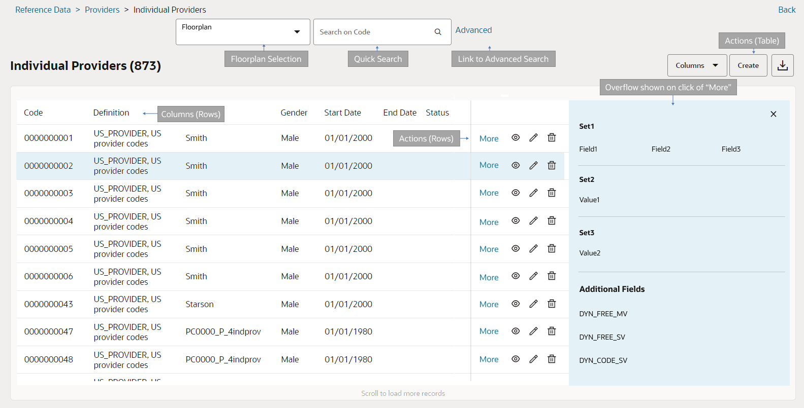

Entity Name and Results Count
Non-configurable, default functionality
The entity name plural is displayed above the table. The total count is displayed next to it
The count is displayed only when the user has performed a search
If no results match the search criteria, the results component displays the message 'no rows were found'.
Floor Plan Selection
Search Object - Table View template supports multiple floor plans for the same page
The user can switch context with a drop-down button located next to the quick search input
Actions
Optional component
By default no action is available unless specified in the floor plan
Only 'Add' available at page level, action link 'Create' is displayed when defined
Re-directs user to the create object page (recursive) in create object mode
When more than one view and edit object plans are evaluated by the system, then they are all displayed as available options in the drop-down. A user selects one of the options and the create object page is displayed using the selected floor plan
If only one plan is evaluated, then the drop-down is not displayed and on selecting the action 'Create', system immediately opens the create object page using the evaluated template
For details on floor plan evaluation refer to the chapter "Presentation Configuration" in the Developer Guide.

Quick Search
Optional component
Center aligned
Can be customized to search on multiple attributes including flex codes, reference fields
For more details refer Quick Search component
Advanced Search
Optional component
Displayed as a hyperlink which displays the advanced search dialog
Enables search on a combination of attributes
For more details refer Advanced Search component

Table
Required component
Used to display the search results in form of a table
Table component consists of the following sub-components:
Rows
All table properties are defined under rows and rows are configured with the following components:
Actions
View, Edit, Copy, and Remove are displayed for each row when configured.
Action Remove, deletes the object from the list.
A dialog seeking user confirmation Delete this record? with Ok and Cancel is displayed when this action is selected. Selecting Ok deletes the record.
When the record deletion is successful, a success confirmation message
{object name singular} deletedis displayed as specified in the section Indicating Success of the Response Messages chapter in the Developer Guide. -
If any messages are returned from the server other than success, then they are displayed on the UI.
Action View opens the View and Edit object page in the view mode.
Action Edit opens object page edit mode.
To edit a row inline, configure
inlineEditat the floorplan level. Once configured, the system displays an additional Edit action to edit the row inline.inlineEditconfiguration applies only to the episodes page.
Action Copy opens the View and Edit object page in edit mode by cloning the object selected for copy.
The menu (…) displays additional actions when more than three actions are configured for a row.
Labels
It is used to display property values in form of a label and can take in exactly one property per label
Multiple labels can be added to the results
Region
Used if additional properties need to be displayed for the row overflow region
The region will slide in from right hand side of table on clicking "More" link, with X (close icon) to close
Set 1 and Set 2: Sets are used to display multiple properties as a set. Each result can have up to 2 sets.
It is recommended to use only Set 1 when using the filter component on the page.
