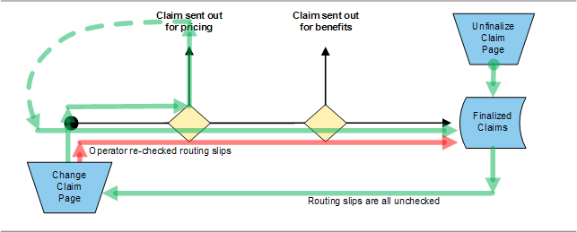

Manual Un-finalize
The image shows possible flows in the situation that a claim is manually unfinalized:
The operator opens the Unfinalize Claim page for the finalized claim, picks an unfinalize reason and unfinalizes the claim.
Claims changes the status of the claim to CHANGE. The routing slips for pricing and benefits are unchecked
The Enter Change Claim page opens, displaying all routing slips unchecked.
The green flow reflects the default behavior of Claims:
The operator does not touch the routing slips and resubmits the claim.
Because the claim pricing routing slip is unchecked, and pricing is external (to Oracle Health Insurance) the claim is sent out.
The claim is priced outside of Claims.
The claim reenters Claims through the claims in integration point, with the pricing routing slip checked.
The claim’s benefits are calculated and the claim re-finalizes.
The red flow reflects what happens if the operator decides to override the default behavior
The operator rechecks the routing slip for pricing and resubmits the claim.
The claim is kept in, using the existing pricing results.

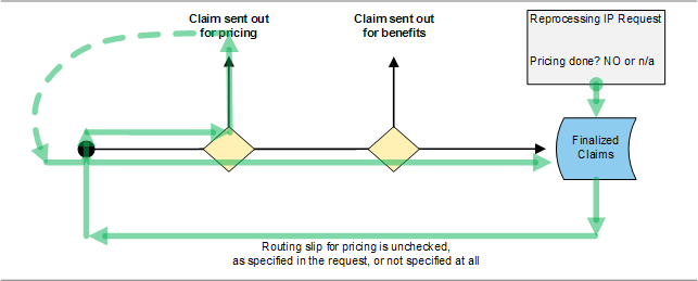

Un-finalize Through Reprocessing IP

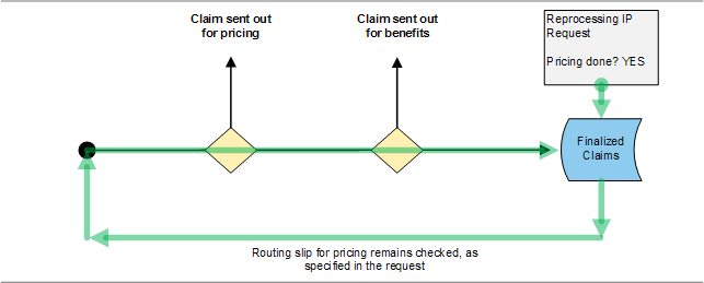

The following scenarios focus on the flow of claims unfinalized by the reprocessing IP.
Request With Checked Routing Slips
Claims receives a request to reprocess a finalized claim. The request specifies that the claim’s pricing routing slip remains checked.
The claim is unfinalized, the claim status is set to INITIAL and the pricing routing slip remains checked.
Request With Unchecked or Unspecified Routing Slips
Claims receives a request to reprocess a finalized claim. The request either specifies that the claim’s pricing routing slip is to be unchecked, or the routing slip isn’t specified at all.
The claim is unfinalized, the claim status is set to INITIAL. Alternatively, if the reprocessing request contained pend reasons, the claim is set to CHANGE. Either way, the pricing and benefits routing slips are unchecked.
Assuming the request contained no pend reasons, and because pricing is external (to Oracle Health Insurance), the claim is sent out.
The claim re-enters Claims through the claims in integration point, with the pricing routing slip checked.

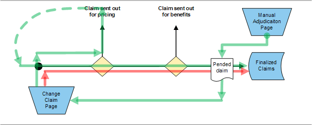

Sending Back A Pended Claim
The image shows the possible flows in the situation that a claim is pended for manual adjudication:
The operator opens the Manual Adjudication page for the pended claim, selects the action "Change claim" and clicks on Ok.
Because the claim’s pricing routing slip is unchecked, and pricing is external (to Oracle Health Insurance) the claim is sent out.

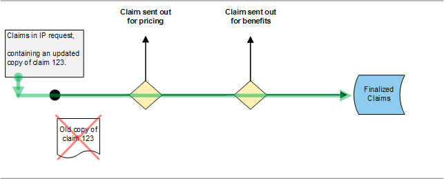

Overwriting a Claim
When Claims receives a new copy of an existing claim, the claim status of the existing copy is also irrelevant. The existing copy is replaced by the new copy. The values of the routing slips are as specified by the new copy.
The claim line codes in the claim request and the claim line codes in the old copy of the claim are compared. If a match is found, the keep pricing and keep benefits indicators are compared. If both lines have a checked keep pricing indicator, then the allowed amount and allowed number of units of the existing claim line will be retained, and the allowed amount and allowed number of units in the claim request will be ignored. If both lines have both a checked keep pricing indicator and keep benefits indicator, then the entire existing claim line is retained, and the matching claim line in the claim in request message is ignored.
In the scenario portrayed by the image, it is assumed that the new copy has a checked pricing routing slip. The claim is not sent out.

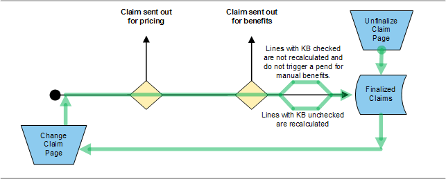

Keep Benefits Checked
This flow shows the effect of checking the keep benefits indicator on the claim line.
The effect of checking the keep benefits indicator is that the benefits aren’t recalculated nor are the external intervention rules triggered, for that particular line. Note that because other lines (or even the claim itself) may still cause a pend, it remains possible that a line with the Keep Benefits indicator checked ends up in manual benefits.
The application changes the status of the claim to CHANGE.
The Enter Change Claim page opens, displaying the routing slips.
The operator checks the pricing routing slip.
Lines that have a checked Keep Benefits indicator are not touched and do not cause pends. All other lines are recalculated and may still cause the claim to pend.
The claim re-finalizes.

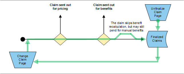

Benefits Done Checked
This flow shows the effect of checking the benefits routing slip.
The effect of checking the benefits routing slip that the claim isn’t recalculated. The purpose of unfinalizing in order to reprocess it, but without actually recalculating its benefits could be that the claim only requires a manual edit on the "old" benefits. When an operator checks the benefits routing slip, it stands to reason that the operator also checks the pricing routing slip.
The operator checks all routing slips and resubmits the claim.
The claim is kept in, using the existing pricing and benefits results. Even though the application does not recalculate the claim, it may still pend for manual benefits.
