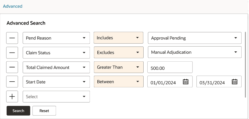

Advanced Search with Operators
An Advanced Search allows you to search based on specific or multiple attributes, using various operators:
An Advanced search enables the search on specific attributes or on multiple attributes with a combination of operators.
Operators
  • Equal To – Returns results that match the specified value.
  • Not Equal To – Excludes results that match the specified value and returns results that match all other values.
  • Like – Returns results that match similar values, not necessarily exact ones. It is for matching similar or partial text values.
  • Between – Returns results within the specified date range (from date to to date). At least one date input is required.
    • If no to date is provided, results from the from date onwards is returned.
    • If no from date is provided, results up to the to date is returned.
  • Not Between – Excludes results within the specified date range (from date to to date). Both dates are required.
  • Greater Than – Returns results greater than the specified value.
  • Greater Than or Equal to – Returns results that are greater than or equal to the specified value.
  • Less Than – Returns results that are less than the specified value.
  • Less Than or Equal to – Returns results that are less than or equal to the specified value.
  • Includes – Returns results that contain the specified value.
  • Excludes – Excludes results containing the specified value and returns results that match all other values.
Operator Functionality
  • String/Text Operators
    • Equal To
    • Not Equal To
    • Like
  • ENUM/LOV/refType Operators (single or multi-value)
    • Equal To
    • Not Equal To
    • Includes
    • Excludes
  • Date Operators
    • Equal To
    • Between
    • Not Between
  • Number Operators
    • Equal To
    • Greater Than
    • Less Than
The following image illustrates how the Advanced Search can be configured.
Example
"advancedSearch": {
    "properties": [
            "name": "agent_code",
            "sequence": 3,
            "refType": {
                "type": "agents"
"refTypeMapping": [
        "type": "agents",
        "properties": [
                "name": "code",
                "viewColName": "agent_code"
                "name": "name",
                "viewColName": "agent_name"

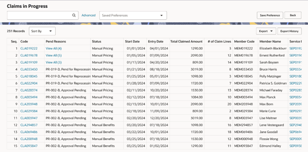

Data Grid
  • Mandatory component.
  • Used to display the search results in the form of a data grid.
  • If no results match the search criteria, the results component displays the message, No rows were found.
  • Data Transfer History displays the history of previous data transfers for seven days.
  • The latest saved search preference is loaded if available.
The Data Grid component consists of the following sub-components.
  • Actions (Data Grid)
    • Data Transfer: Used to transfer the report data to a specified format.
    • Data Transfer History: Displays the history of previous data transfers.
  • Rows: Can be configured with the following component.
    • Columns: Each property defined in this section forms a column in the data grid.
Features
The data grid component is lightweight and designed for seamless presentation of large datasets. This makes it fast and efficient.
  • Read-only table representation
  • Handles large datasets with ease
  • Built-in sorting functionality
  • Optimized for performance
  • Minimal resource usage
  • Cell configurable as deep links
  • Supports multiple values per cell
Data grid is used for operational reporting views floorplans.
Example
  "dataGrid": {
    "row": {
      "columns": {
        "properties": [
            "name": "policy_code",
            "sequence": 1,
            "reftype": {
              "type": "policies"
            "deepLink": true
            "name": "status",
            "sequence": 2
            "name": "last_updated_date",
            "sequence": 3
            "name": "policyholder_name",
            "sequence": 4
            "name": "pend_reasons",
