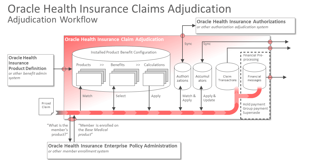

Adjudication Workflow
The adjudication process is an embedded workflow within Claims. It consists of a number of configurable steps, each of which has a specific purpose. This process includes steps that handle the following aspects:

Accumulate and Calculate Coverage
Claims benefit calculation configuration is rule driven. There are no embedded assumptions and hard-coded calculations in the application. Instead, it separates the semantics of a calculation from the math by providing set of configuration building blocks such as accumulators, coverage labels and cover / withhold rules that can be brought together to form calculation templates.
These templates drive the sequence of rules that apply, for example, first apply the deductible followed by the copayment, or the other way around. The actual accumulators that apply are retrieved as separate parameters from the selected benefit.
At this point in the claims flow, all the retrieved information comes together in order to execute the coverage calculation.

Finalize Claim
After the claim liability is calculated, the application finalizes the claim.
This means that all related increments to accumulators are made permanent and that the incurred increments to the accumulators become visible to other claims that are still in the process.
When the claim finalizes the application stores a immutable snapshot of the claim. These are called Claim Transactions and are stored in the internal claim transaction repository.
It is possible to select a finalized claim and resubmit that claim for processing. A typical occasion is an accepted provider appeal, which requires that the original claim adjusted and reprocessed. When the adjusted claim re-finalizes, it generates retractions, and a new version for the all accumulator increments as well as for the previous claim transaction.
Financial Pre-Processing
Concurrently with the creation of the claim transactions the application also generates a Financial Transaction. This transaction is also stored in an internal repository and carries the information that is required by downstream financial applications that are responsible for paying the claim. The application implements a three step approach for generating payment message.
These steps can either be initiated by an end user or can be initiated through the application’s API, for example, by an external job scheduler. These jobs prepare the financial transactions to be published to a downstream application by
Aggregating financial transactions into one or more sets, depending on configurable aggregation criteria
Consolidating the transactions in set by making sure only the latest version of a transactions is processed (reprocessing a claim produces a retraction of the old transactions, and a new (version) financial transaction that reflects any changes)
Generating financial messages that are made available to downstream systems.
