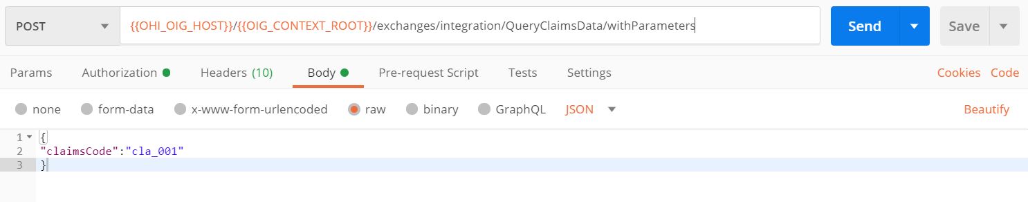

This integration can be invoked using Exchange Integration Point - with parameters options (see image), with claimCode being the request parameter.
Query Claims Data

This integration can be invoked using Exchange Integration Point - With Payload.
In this example the exchange invocation payload is the same as the payload required by the long-running operation. Alternatively, the dynamic logic function 'Invoke Function Payload' can also be implemented to generate payload.
   "limitCodes" : [ "code1", "code2", "..."],
   "transactionStartDateTime" : {
      "value" : "..."
   "transactionEndDateTime" : {
      "value" : "..."
