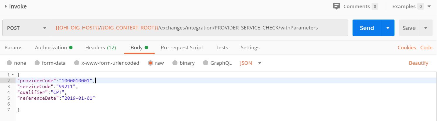

In this example the provider code, service code, and as of date are supplied as request parameters. Generic API can be used to GET /organizationproviders details. The system reads the dynamic record 'Capitated Services' to check if the given service is capitated or not. If the service is capitated as of the input date, then the exchange must return the response as 'Service is Capitated', otherwise 'Service is Not Capitated'. This use case can be realized by having a CUSTOM step.

The integration is configured by sending in the following payload to /integrations generic api
    "code": "PROVIDER_SERVICE_CHECK",
    "type": "integration",
    "descr": "PROVIDER_SERVICE_CHECK",
    "integrationSteps": [
            "sequence": 1,
            "subtype":"CUSTOM",
            "outputName":"PROVIDER_SERVICE_CHECK",
             "destination": {
                  "code": "capitation"
            "typeConfig": {"customFunctionCode" :"PROVIDER_SERVICE_CHECK"}

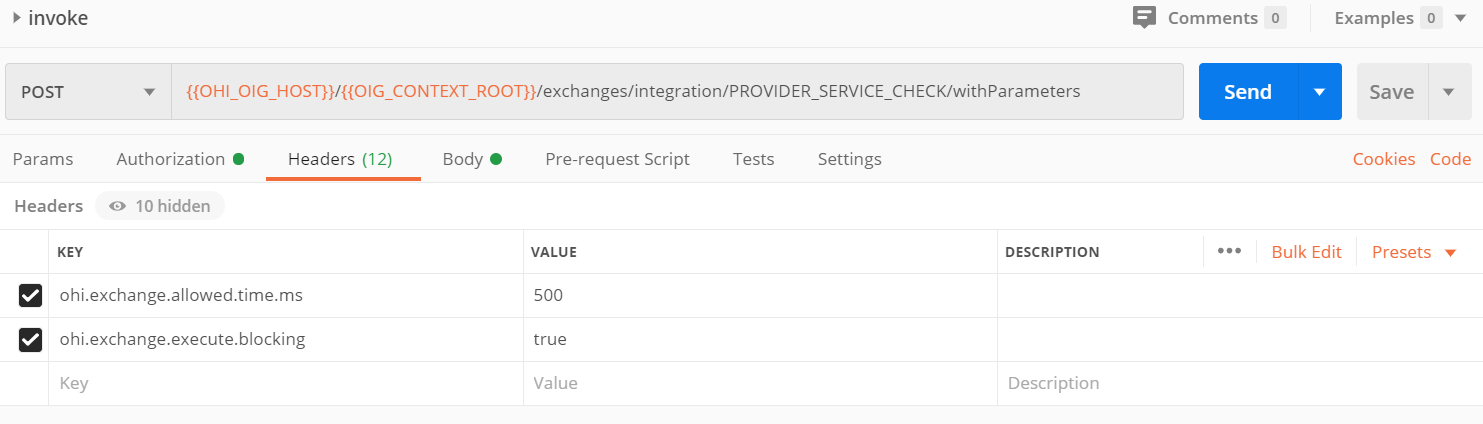

For blocking call, this integration must be invoked with the following HTTP Headers
Description
ohi.exchange.allowed.time.ms
The maximum allowed time in milliseconds a client is willing to wait for the exchange to complete. Typically in the order of magnitude of 1 to 5 seconds.
ohi.exchange.execute.blocking
true
Image 1# Invoke exchange using Exchange Integration IP - With Parameters option
service-check
Image 2# HTTP Header parameters
service-check-2
