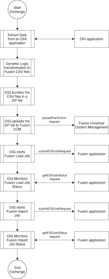

The following graphic shows an overview of the steps executed as part of an Oracle Insurance Gateway Fusion integration that extracts data from an OHI application and loads and imports that data into Fusion:
The overview depicts the scenario in which all steps succeed. If a step in the process would fail that fails the Oracle Insurance Gateway exchange. It can be restarted after resolving the problem.

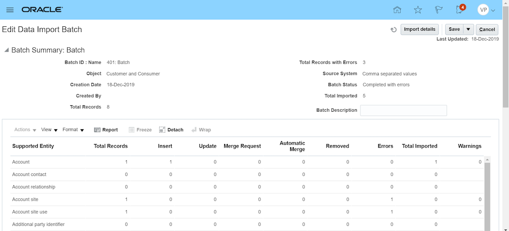

Fusion Import Results
The Oracle Insurance Gateway tracks the status of loading and importing data. Please note that although the import process finishes with status 'succeeded' that does not necessarily mean that all data was imported successfully. Check the results of the import process in Fusion itself. For example, the following screenshot shows the results of a CUSTOMER import batch that completed with status 'succeeded':
Of 8 records that were uploaded in CSV files 5 were imported but 3 were not.
