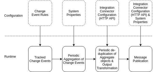

Configuring the Integration Connector
By default, the Integration Connector feature is disabled. Next to defining Change Event Rules of type 'Message', the following steps are needed to enable and configure the Integration Connector:
Set system property ohi.connector.event.aggregation.activated to true. This enables periodic aggregation of Change Events into Aggregate Events.
Configure a Message Transformation Dynamic Logic (see the example below).
Configure the Integration Connector through its HTTP API resource "/connectorconfigurations", referencing the Dynamic Logic. See its Swagger / OpenAPI specification for details. The following is an example configuration message for an Integration Connector configuration (in context of Oracle Health Insurance Enterprise Policies Administration):

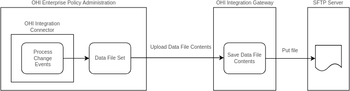

Working with the Oracle Health Insurance Integration Gateway (OIG)
For delivering Data Files via SFTP (to an SSH FTP v3 capable SFTP server), the Integration Connector can be configured to work with the Oracle Health Insurance Integration Gateway. The solution setup, in this case based on use of the Integration Connector in Oracle Health Insurance Enterprise Policy Administration, is outlined in the following diagram:
The Integration Connector is configured to upload the contents of all the Data Files of the Data File Set (using multipart/form-data) to the Oracle Health Insurance Integration Gateway’s "/api/exchanges/integration/{integration_code}" resource URL in which the "integration_code" points to an integration configuration with an integration step which refers to a destination with SFTP configuration that contains specific SFTP endpoint parameters.
The Oracle Health Insurance Integration Gateway saves the contents of all the Data Files in the Data File Set and they are transferred by SFTP to the configured destination.
See the Oracle Health Insurance Integration Gateway documentation for configuration details for SFTP endpoints.
