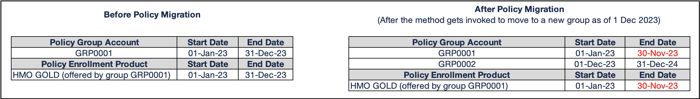

copyAndEndDatePolicyGroupAccount
This method creates a copy of the latest Policy Group Account with the passed Policy Group Account and the Start Date. The method also sets the End Date to the latest Policy Group Account if the current End Date is NULL/on/after the date provided in a parameter to the method. There is no change to the End Date if the current End Date of the latest Policy Group Account is before the passed parameter date. Adds the newly created copy to the policyGroupAccount detail list.
The method also End Date of all its Policy Enrollment Products as per the old Policy Group Account on the new Policy Group Account only during the migration.
For example, see the following illustration:
copy and edit date pga
The Dynamic Logic using this method fails with a technical error (OHI-DYLO-007) if the passed Group Account does not exist in the system.
Nothing happens, and the method returns NULL if there is no existing policyGroupAccount detail on the Policy.
