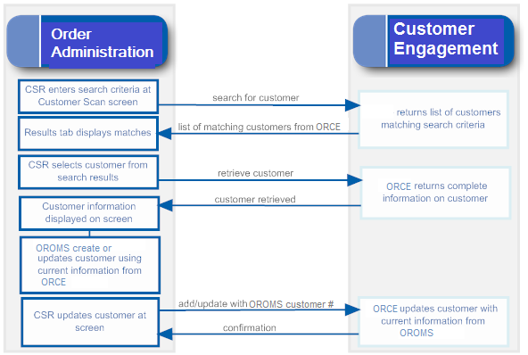

When does Order Administration communicate with Customer Engagement?
- Searching for a customer: When you search for an existing customer in an Order Administration menu option, Customer Engagement returns a list of customers matching the search criteria. See Notes on Searching for a Customer on Order Administration Screens for more information.
- Synchronizing customer information (add/update customer): Synchronization occurs when:
You create a new customer in Order Administration Classic View or Contact Center Order Entry. Order Administration sends a message indicating to create the new customer in Customer Engagement.
You retrieve an existing customer record from Customer Engagement. When Customer Engagement sends the current customer information to Order Administration, Order Administration creates or updates its customer record based on the information received from Customer Engagement. The creation or update occurs through both Classic View and Modern View.
You update an existing customer at an Order Administration Classic View or Modern View screen. Order Administration sends an update message to Customer Engagement.
You update an existing customer through the order API, in certain cases. See Customer Synchronization through the Order API for a discussion.
You use a periodic function to synchronize Order Administration customer records with Customer Engagement. Order Administration sends its current customer information to Customer Engagement and stores the Relate ID in the Customer Sold To table. See Synchronizing Customer Information through a Periodic Function for more information.

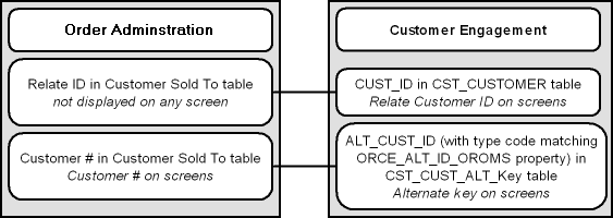

How are synchronized customers linked? A pair of synchronized Order Administration and Customer Engagement customer records are linked by matching customer numbers:
- Order Administration: the Relate Id in the Customer Sold To table identifies the customer ID in Customer Engagement
- Customer Engagement: the Alternate key in Customer Engagement identifies the customer number in Order Administration. The ORCE_ALT_ID_OROMS setting in Working with Customer Properties (PROP) defines the alternate key type for the Order Administration customer number in Customer Engagement.

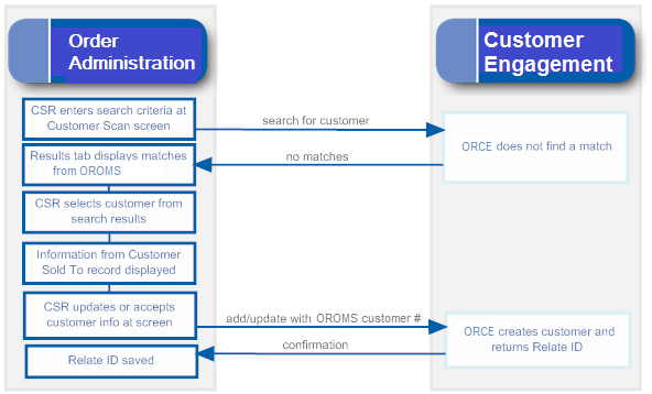

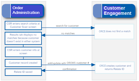

When the Customer Contacts the Call Center
Overview: A customer can also create an order by contacting the call center. When the customer contacts the call center to place an order, request a catalog, create a customer membership outside of order entry, or update name and address information, the CSR needs to first search for the customer in order to keep the Customer Engagement and Order Administration customer records in sync and prevent creating duplicate records. The process when a customer contacts the call center is:
- Search Customer Engagement first: When the CSR performs a search, Order Administration first checks in Customer Engagement for any matches. Unlike the process used for the order API, the customer search can send various criteria to Customer Engagement. If the CSR selects a customer from the search results and enters any updates, Order Administration syncs these updates with the Customer Engagement customer record.

Searching Customer Engagement for the Customer
When the customer contacts the call center to place an order, request a catalog, create a customer membership outside of order entry, or update name and address or other information:
Searching:
- The CSR enters the search criteria at the Customer Scan Screen.
- There is at least one customer record in Customer Engagement that matches the search criteria.
- The Results tab at the Customer Scan screen displays the names, home addresses, email addresses, and primary phone numbers of any customers in the Customer Engagement database matching the search criteria. The Results tab displays the error message Maximum search results exceeded, please refine your search if the number of matching records exceeds the Customer Lookup Limit system configuration setting in Customer Engagement. In this situation, you need to make your search criteria more specific to make sure that you can find the customer record you are looking for.
Selecting a customer from the Customer Engagement search results:
- If the CSR selects a record from the Results tab:
Order Administration requests information on the complete customer record from Customer Engagement
Customer Engagement sends the customer information, including the alternate key, if any, that maps to the Order Administration customer number.
If the alternate key identifies an existing customer in the Customer Sold To table, Order Administration updates the customer record with the current information from Customer Engagement. Also:
If more than one record in Customer Engagement is assigned the same alternate key mapping to the Order Administration customer number, Order Administration uses the information from the first matching record to update the customer record in the Customer Sold To table.
If the alternate key that identifies an existing customer in the Customer Sold To table has a different ORCE customer ID, Order Administration updates the ORCE customer ID for the customer record.
If there is not an alternate key that identifies an existing customer in Order Administration, Order Administration creates a new customer record.
Searching Order Administration for the Customer in Classic View
Searching:
- There are no records in Customer Engagement that match the search criteria, but there is at least one match in the Order Administration Customer Sold To table.
- The Results tab at the Customer Scan screen displays the names, home addresses, email addresses, and primary phone numbers of any customers in Order Administration’s Customer Sold To table that match the search criteria.
Selecting a customer from the Order Administration search results:
- If the CSR selects a record from the search results:
Order Administration retrieves the current information from its Customer Sold To table.
When the CSR updates or accepts the customer information, Order Administration sends an add/update message to Customer Engagement.
Customer Engagement creates the customer record, assigning the Order Administration customer number as an alternate key, and sends the Customer Engagement customer number to Order Administration.
Order Administration updates the Customer Sold To record with the Relate Id.
Creating a New Customer
Searching:
- There are no records matching the search criteria in either Customer Engagement or Order Administration.
- The results do not include any records.
Creating the customer:
- When the CSR enters the information on the new customer:
Order Administration creates the customer record in its Customer Sold To table.

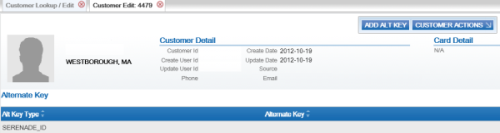

Customer number |
Alternate key OROMS_ID |
Indicates the Alt Key Type of the alternate key in Customer Engagement that maps to the Order Administration customer number. This field is available for display in Customer Engagement by selecting Alternate Key in the Customer Lookup /Edit option. Customer Engagement automatically creates this entry for a customer when you send the customer to Customer Engagement interactively or through the Customer Engagement Add or Update Customer Message if it does not already exist based on the ORCE_ALT_ID_OROMS setting in the Customer Engagement Properties file. In this situation, Customer Engagement also adds a row to the CST_ALT_KEY_TYPCODE table in the Customer Engagement database if it does not already exist. |
Relate id |
Customer ID |
Note: The Relate id:

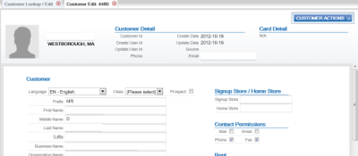

| Customer-level information and permissions |
The customer-level permissions in Customer Engagement are informational only. |
Displaying in Customer Engagement: Included under the Customer option. See above. |
Retail Store ID |
Signup Store Home Store |
The value defined in the Default Location for ORCE Integration (K69) system control value is passed if the relate_cust_sync_success flag is set to N in the CWOrderIn message, indicating that the e-commerce site has not yet successfully synchronized information about the customer with Customer Engagement. Otherwise, if the relate_cust_sync_success flag is set to Y, the location ID is not passed, in order to prevent updating the existing store locations in Customer Engagement. |
N/A |
Source |
Contact Center defaults when a new customer is sent to Customer Engagement. |
Mail flag |
Mail contact permission flag |
Order Administration to Customer Engagement: Y defaults if the Mail flag is selected Customer Engagement; otherwise leave blank. Order Administration does not automatically update the setting sent from Customer Engagement. |
Opt in/out setting for primary email address |
Email contact permission flag |

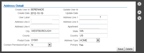

| Address Note: Only the customer’s HOME address in Customer Engagement is mapped to Order Administration. If more than one HOME address exists in Customer Engagement, the system uses the primary HOME address. This information is required in order for Order Administration to create the customer record correctly.Customer Engagement automatically creates an Address type of HOME when it receives a customer from Order Administration interactively or through the Customer Engagement Add or Update Customer Message. In this situation, Customer Engagement also adds a row to the CST_ADDR_TYPCODE table for ADDRESS_TYPECODE HOME in the Customer Engagement database if it does not already exist. |
No address validation in Customer Engagement: Unlike Order Administration, Customer Engagement does not require an address for a customer, and does not validate that the address includes certain required components; for example, no address lines are required. To prevent problems in Order Administration, it is important that any other means you use to create customers in Customer Engagement, such as through your e-commerce site, always creates a home address when you use the Customer Engagement customer integration. If a home address does not exist in Customer Engagement, Customer Engagement displays the customer in Order Administration without an address. Also, if certain fields for the home address are not defined in Customer Engagement, these fields will be blank when you display the customer in Order Administration. However, when you update the customer’s address in Order Administration so that is passes validation, the system will also update the customer’s home address in Customer Engagement |
Displaying in Customer Engagement: Select Address. ![]() |
N/A |
Primary |
Set to Yes in Customer Engagement. |
Street |
Address line 1 |
Truncated in Order Administration to 32 positions. Any trailing spaces are removed. |
Apt/Suite |
Apartment |
Truncated in Order Administration to 32 positions. If deleted in Order Administration, also deleted in Customer Engagement. Any trailing spaces are removed. |
Address (lines 2-4) |
Address lines 2-4 |
Truncated in Order Administration to 32 positions. Stored in the Customer Sold To Extended table. If deleted in Order Administration, also deleted in Customer Engagement. Any trailing spaces are removed. |
City |
City |
Truncated in Order Administration to 25 positions. Any trailing spaces are removed. |
State |
State |
Truncated in Order Administration to 2 positions and validated against the states in the Country table. Any trailing spaces are removed. |
Postal code |
Postal code |
Truncated in Order Administration to 10 positions and validated against the SCF table. Any trailing spaces are removed. |
Country |
Country |
Must be a 2-position country code; validated in Order Administration against the Country table. Note: Use the two-position ISO country code; for example, use US instead of USA.Any trailing spaces are removed. |
Contact permission/opt in setting (address level) |
Order Administration to Customer Engagement updates:
Customer Engagement to Order Administration updates:
Note: The mail permission setting in Customer Engagement must consist of or start with the letters Y or N; otherwise, synchronizing the customer with Order Administration results in an error when validating the customer in Order Administration because the only valid settings in Order Administration are Y and N. |

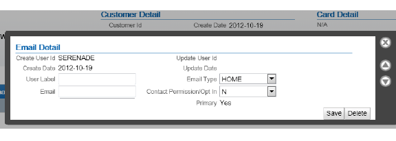

| Email address In Order Administration, the primary email address is stored in both the Customer Sold To table and the Customer Sold To Email table. Additional, non-primary email addresses are stored only in the Customer Sold To Email table. Only the HOME email address that is flagged as primary in Customer Engagement is eligible to be included in the integration. |
Customer Engagement automatically creates an Email type of HOME when it receives a customer from Order Administration interactively or through the Customer Engagement Add or Update Customer Message. In this situation, Customer Engagement also adds a row to the CST_EMAIL_TYPCODE table for EMAIL_TYPECODE HOME in the Customer Engagement database if it does not already exist. |
Displaying in Customer Engagement: Select Email. Optionally, highlight the email address to open the Email Detail window. ![]() |

Primary |
Email address |
Email type: HOME |
Only the HOME email address that is flagged a primary is eligible to be included in the integration. If the customer has any other email type in Customer Engagement, but not a HOME email type, the email address(es) are not passed to Order Administration. Any trailing spaces are removed. |
Opt in/opt out |
Contact permission/opt in setting (email level) |

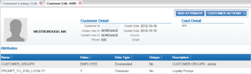

| Profile data In Order Administration, profile data is stored in the Customer Profile table. |
Included in the integration? The Send Profile Data to ORCE (L51) system control value controls whether to include demographic profile data when synchronizing customer information. Required setup: You need to complete the setup described under Order Management System Customer Profile > Customer Engagement Attribute Definition in order to synchronize the information between the systems. Examples are provided below. |
Displaying in Customer Engagement: Select Attributes. ![]() |
Profile description |
Attribute name |
Use the Setting Up Customer Profiles (WPFL) option in Order Administration to set up the type of demographic information you are capturing, and also use the Attribute Definition screen in Customer Engagement to create a corresponding attribute definition for each Order Administration profile code. Example: To capture marital status, you can set up:
Profile data description |
Attribute value |
Use the Setting Up Customer Profiles (WPFL) option in Order Administration to set up each valid profile data value that you can capture. It is not necessary to set up valid data in Customer Engagement; Customer Engagement stores the data as a text string. Example: In the Setting Up Customer Profiles (WPFL) option in Order Administration, set up profile data options such as:
Customer Engagement stores an attribute value of MARRIED. |

Email address: Only the email address with a type of HOME is used as part of the integration.

- Relate Id: Customer Engagement customer number = Relate Id in the Order Administration Customer Sold To table
- Customer number: Customer Engagement alternate key record whose Alt Key Type matches the ORCE_ALT_ID_OROMS setting in Working with Customer Properties (PROP) = the Order Administration customer number
- E-commerce ID: Customer Engagement alternate key record whose Alt Key Type matches the ORCE_ALT_ID_WEB setting in Working with Customer Properties (PROP) = the e-commerce site’s customer number. From the ecommerce_id passed in the CWOrderIn message, and saved as the E-commerce ID in the Customer Sold To table only if the order API was unable to synchronize the Order Administration and Customer Engagement customer records

Email addresses never deleted from Customer Engagement: Even if you change or delete a customer’s email address, this information is not visible on the screen but is retained in the Customer Engagement database. For this reason, searching on the deleted or overwritten email address still finds the customer, and customer matching logic described under Customer Synchronization through the Order API uses the deleted or overwritten email address as it would use a current email address.

Email and phone: If you change the email address and phone numbers in Order Administration, the previous information persists in the Customer Engagement database, although it is no longer displayed on the screen and does not repopulate the Order Administration customer record at resynchronization. However, if you search for a customer using the previous email address or phone number as a search criterion, the customer is eligible to be included in the search results.
