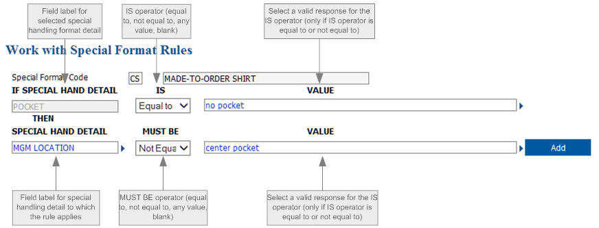

Work with Special Format Rules Screen
Purpose: Use this screen to work with rules to validate the custom special handling instructions for order lines that use a particular custom special handling format.
Why set up rules? Setting up rules for a complex special handling format helps you prevent the customer or CSR from entering special handling instructions that are inconsistent, impractical, or otherwise invalid. For example, for if monogramming is optional, but there are additional requirements when monogramming is selected, setting up rules can help prevent problems in creating the special handling instructions.
What do rules consist of? Each rule includes:
- an IF statement that identifies whether the rule applies, for example: If the pocket style for a shirt is equal to “no pocket”
- a THEN statement that specifies the rule to apply, for example: then the monogram location cannot be “pocket”
More rule examples:
- If the cuff type for a shirt is any value (not blank), then the sleeve length must not be 0 (short sleeve)
- If the cuff type for a shirt is blank (no cuff style specified), then the sleeve length must be 0 (short sleeve)
- If the monogram for a shirt is any value (not blank), then the monogram style must also be any value (not blank)
What if the special handling format violates a rule?
- Order entry: When you select Accept at the Work with Custom Special Handling Screen, the screen displays an error message such as MGM LOCATION - center pocket response is not valid for POCKET - no pocket. You need to fix the error before accepting the special handling for the item. If there are multiple errors, the screen displays each error individually, and you need to fix each error before accepting.
- Order API: If the special handling instructions do not conform to a rule, the order line is put in error status with an error code of GA: SH Resp fail defined rule.
All existing validation, such as maximum number of characters, still occurs when you use special handling format rules.Setting up rules is optional.
| Field | Description |
| Special format code |
The code and description of the special handling format that you selected from the Work with Special Handling Format Screen. Code: alphanumeric, 2 positions; display-only. Description: alphanumeric, 30 positions; display-only. |
| IF statement |
The IF statement determines whether to apply the rule. |
| If special handling detail |
The Field label for the special handling detail you selected at the Work with Special Handling Format Detail Screen. The IF statement must be based on the selected detail. Alphanumeric, 15 positions; display-only. |
| IS |
The test you are using to evaluate whether the special handling rule applies. Possible tests are: Any Value = Apply the rule if the entry for the special handling detail for the order line is not blank Blank = Apply the rule if there is no entry for the special handling detail on the order line Not Equal To = Apply the rule unless the entry for the order line matches the value for the IS statement Equal To = Apply the rule if the entry for the order line matches the value for the IS statement |
| Value |
The response you are using to qualify the special handling rule based on whether the special handling entry matches or does not match a particular value. You can specify a response value only if the IS operator is set to Not Equal To or Equal To. Typically, you use this field to select one of the responses you set up at the Work with Special Format Response Screen. Example: Apply the rule if the pocket style is equal to “no pocket,” where:
You cannot enter a value here if the IS operator is set to Any Value or Blank.
| THEN statement |
The THEN statement defines the rule to apply. |
| Then special handling detail |
Select the Field label for the special handling detail that is affected by the rule. Example: If the font is blank, then the monogram must be blank, where:
You can select the Field label for any of the special handling details set up for the custom special handling format you are working with except for the IF special handling detail. |
| MUST BE |
The operator that applies to the entry for the Then special handling detail. Possible operators are: Any Value = The entry for the Then special handling detail cannot blank Blank = The entry for the Then special handling detail must be blank Not Equal To = The entry for the Then special handling detail must not match the value for the THEN statement Equal To = The entry for the Then special handling detail must match the value for the THEN statement |
| Value |
The response that either must match (Equal To) or cannot match (Not Equal To) the response on the order. If the MUST BE operator is set to Not Equal To or Equal To, use this field to select one of the responses you set up at the Work with Special Format Response Screen. Example: The cuff style must be equal to “no cuff” where:
You cannot select a value here if the IS operator is set to Any Value or Blank.
