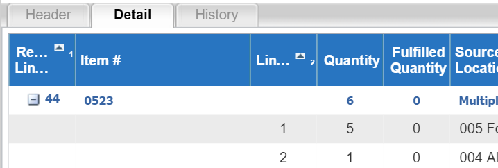

Split lines at Detail tab: If any line on the order is split, you need to expand the requesting system line number at the Details tab in order to see and work with the details for all lines and see additional options:
Illustrates a split line at the Detail tab.

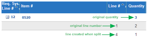

Line #
The order line number assigned by Order Broker. May be different from the requesting system’s line number if the system did not send all of the order lines to Order Broker for fulfillment and the version specified in the submit order message was lower than 3.0, or if an order line is split.
If split: If any of the lines on the order are split, the Item # is before the Order Broker Line # and is always displayed, even if you have not expanded the line by clicking the plus sign next to the Req. Sys. Line # (Requesting system line number); however, the Line # and other fields are not displayed until you click the plus sign.
Examples of line splitting:
  • Split by the Routing Engine:
    • The Routing Engine assigns the order to location A, and then Location A rejects the order
    • The Routing Engine then assigns half the quantity to location B, and half to location C. Result: the quantity in location B is now line #1; the quantity in location C is now line #2

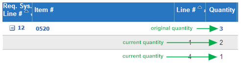

  • Partial status update: The entire quantity of 5 was originally assigned to location A, but location A rejected 3 units. Result: the quantity in location A is now line #1; the rejected quantity, now reassigned or unfulfillable, is now line #2
Illustrates a split line, with the original quantity, original line number and current quantity, and line number created when split and the quantity on this line.

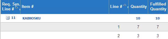

Fulfilled Quantity
The quantity of the item shipped to the customer (delivery order) or picked up by the customer pickup order, ship-for-pickup order). Updated when the Routing Engine receives a status update message indicating that the new order, line, or quantity status is fulfilled.
If split: The total fulfilled quantity is displayed at the summary level for the line, and the fulfilled quantity for each current line number is listed below with the current line.
Illustrates the fulfilled quantity of the original line as well as the two current lines that exist through splitting.
Fulfilling Location
The fulfilling location that was most currently assigned to fulfill the item. Displayed only if the order is not a ship-for-pickup order.
If split: If the line is currently split across multiple fulfilling locations, the word Multiple is displayed at the summary level. You can expand the line to review all assigned locations by clicking the plus sign to the left.

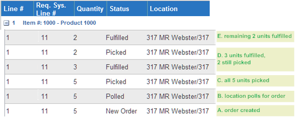

Status history and changes to the Under Review indicator are tracked at the line level even if the organization does not split orders or order lines.
Illustrates the history of a line. The line was created; the location polled for orders, and the order was included in the response; units were picked; a partial quantity was fulfilled; the remaining quantity was fulfilled.

Which line number? The status history entry always lists the line number referenced in the status update request, even if the status update creates a new line number.
Example: Line 10 currently includes 5 units in picked status. A partial status update indicates to change the status of 3 units on the line to fulfilled status. This update changes the quantity of line 10 to 2, and creates a new line, line 11, for 3 units in fulfilled status. However, both status history entries list line number 10, since that was the line number referenced in the status update request. The Routing Engine does not write a separate status history record for the creation of line 11.
