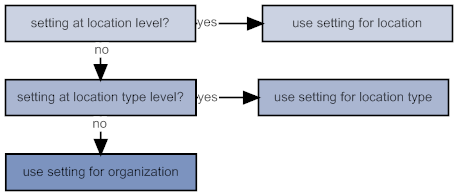

Applying a preference: Set each preference at the lowest level in the hierarchy where it should apply. When determining the preference for an individual location, Order Broker uses the first defined preference it finds, starting at the location level and then working up to the location type level, then finally the organization level. For example, if you set a preference to Not Defined at the location level, the setting at the location type level applies.
Illustrates the preference hierarchy: use the setting at the location level, if any; otherwise, use the setting at the location type level, if any; otherwise, use the setting for the organization.
Example:
Required result: All US stores should use proximity locator logic except for the Natick store. The US store locations are assigned to the location type of US Store.
Correct preference settings: Set Use Proximity Locator for US Stores to Yes, but set it to No for the Natick store location only.

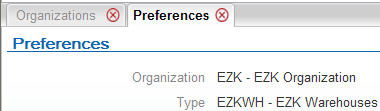

Type
When you highlight a location type in the left-hand pane, its code and name are displayed at the top of the screen.
Illustrates the top of the Preferences screen with a sample organization and location type displayed.
Settings at the location type level:
  • The Use Proximity Locator, No Offline Response Action, and Fulfillment Tab settings at the location type level apply to locations of that type unless they are overridden at the location level. These settings override any settings at the organization level.
  • If a setting is set to Not Defined at the location type level, the organization-level setting applies.
See review preferences at a specific level, above, for more information on how to work with preferences for a location type.
