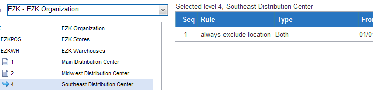

                               Highlight the location type or location to display the rules that are currently assigned at that level, or select a different organization from the drop-down list. Note that the currently selected location level is indicated above any assigned rules.  |

                               Use the navigational fields in the left-hand pane to select the organization, location type, or location where the rule should apply, as described above. You can assign a rule at only one level at a time; however, rules you set at the organization level or location type level apply to all lower levels, unless they are overridden by another rule at a lower level. See Probability Rule Overview for background. Use the fields at the top of the screen to select the rule and optionally specify a date range or reset the Active flag. Rule not displayed? If you create or update the name of a probability rule while the Probability Location screen is open, the new or renamed rule is not available for assignment until you close the Probability Location screen and reopen it.  |

                               Rule assigned? A blue
arrow ( Note: To refresh the display of the blue arrows based on your activity at this screen, close the Probability Location screen and re-enter. |

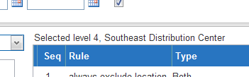

| Selected level |
                               When you highlight an organization, location type, or location in the left-hand pane, the code and description are displayed in the center of the screen above any rules that apply to the selection. ![]()  |
