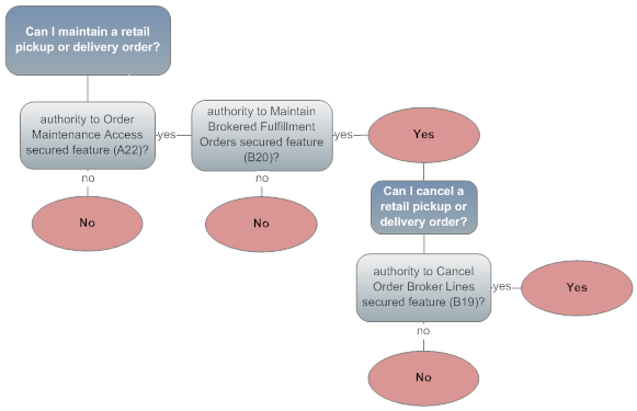

Maintaining a retail pickup or delivery order: The following chart summarizes the authority required to maintain or cancel a retail pickup or delivery order:

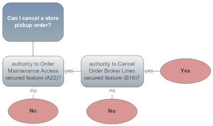

Canceling a store pickup order: The only possible maintenance of a store pickup order is to cancel it. The following chart summarizes the required authority.

Orders that are not eligible for maintenance: You cannot maintain an order if its status is Suspended or Error, if it is a canceled pre-order quote, or if it is a store pickup order:
- Use batch order entry to work with orders in Suspended or Error status. See Introducing Order Batches for more information.
- If you select a store pickup order, the only available option is to cancel the entire order, provided you have sufficient authority. See Store Pickup Orders for an overview, and see Canceling a Store Pickup Order for details.

Maintaining Retail Pickup or Delivery Orders from Order Orchestration
If you have authority under the Maintain Brokered Fulfillment Orders (B20) secured feature, a window displays a warning message when you select an open or held delivery or retail pickup order for maintenance, indicating that maintenance options are limited.
Secured feature: If you do not have authority under the Maintain Brokered Fulfillment Orders (B20) secured feature, you cannot maintain a delivery or retail pickup order received from Order Orchestration.
Possible updates: You might need to maintain a retail pickup or delivery order to:
- Sell out an item that is no longer available: Order Administration sends a reject request to Order Orchestration. Order Orchestration then attempts to find another location to fulfill the order unless the order has already reached the Search retries maximum specified in Order Orchestration.
- Cancel an item that the customer no longer wants: Order Administration sends a cancel request to Order Orchestration, indicating that the order should not be fulfilled. Order Orchestration does not reassign a canceled order to another fulfilling location.

Canceling brokered orders: You need authority under the Cancel Order Broker Lines (B19) secured feature to cancel a retail pickup, delivery, or store pickup order, or an order that includes a brokered backorder line. For an overview, see Order Orchestration Integration, including:
- Canceling a Brokered Backorder Request
- Retail Pickup (including Ship-for-Pickup) or Delivery Orders
- Canceling a Store Pickup Order
Canceling a retail pickup or delivery order: If you cancel a retail pickup or delivery order, the system changes the Order Orchestration record’s status to Canceled and sends a status inquiry request to Order Orchestration. If the order’s status in Order Orchestration is:
