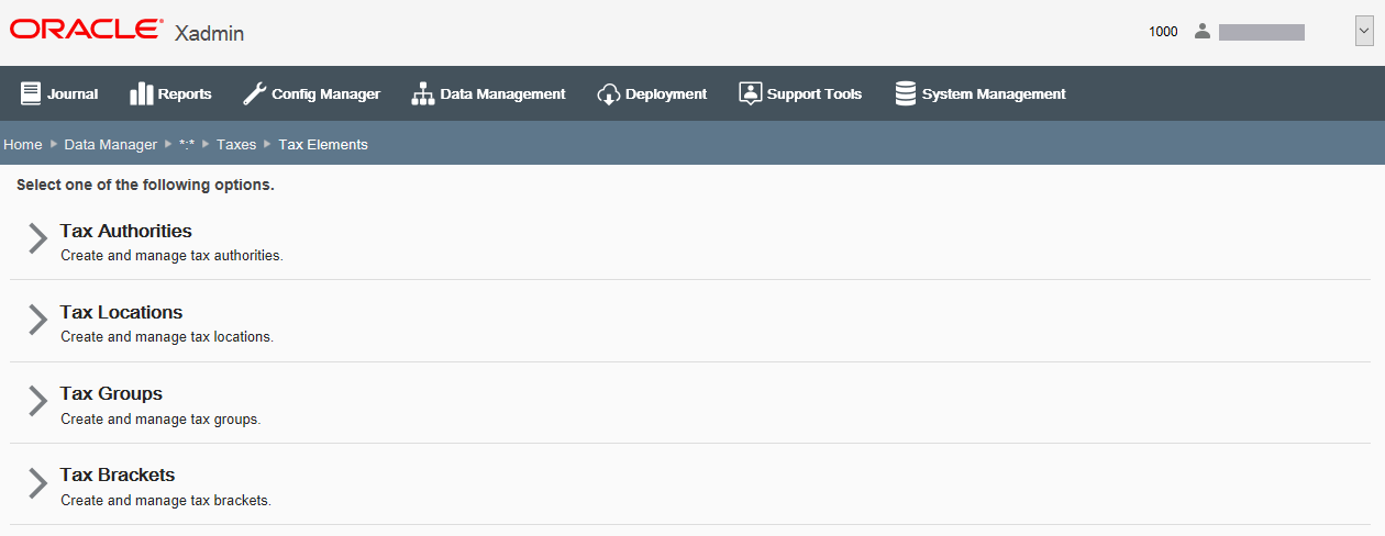

Tax Elements
Set up the basic tax elements here before setting up the tax rate rules.
Figure 6-28 Tax Elements Page
Tax Authorities - Identifies the name of the authority that imposes the tax, and also supplies the rounding rules that are used in the calculation. See Tax Authorities.
Tax Locations - Defines the tax locations that can be assigned to individual stores. See Tax Locations
Tax Groups - Defines tax groups for items that are taxed according to the same rules. For example, certain food products may belong to the same tax group. After defining the tax groups, they may be assigned to individual items. See Tax Groups.
Tax Brackets - Defines the tax brackets used to calculate the sales tax for an item or transaction. See Tax Brackets.
