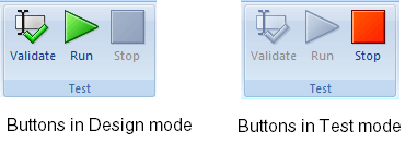

To test your integrated Excel Workbook, click the Run button on the Oracle ADF tab, and click the Stop button to return to the design mode. Figure 14-1 shows the buttons of the Oracle ADF tab in design mode and in test mode.
Figure 14-1 Run and Stop buttons in Oracle ADF tab

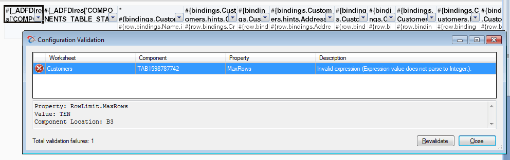

    For example, Figure 14-2 illustrates a validation failure message of an invalid EL expression.
    Figure 14-2 Invalid EL Expression Resulting in a Validation Failure

How to Fix Validation Failures
When you validate your workbook, you might get validation failures or warning messages, which you can fix easily by following these steps:
  1. Identify the component that gave the error or warning message.
    In Figure 14-2, note the component location and other details (for example, property name) that the Configuration Validation dialog provides.
  2. Open the property editor of the component.
  3. Navigate to the invalid property value identified by the full property context path.
  4. Edit the property value to resolve the validation failure.

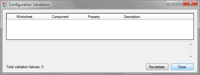

  5. Revalidate the workbook to verify whether the validation failure has been resolved. Click Revalidate to run the validation rules again.
  6. After fixing all validation failures, click Close to close the Configuration Validation dialog.
    Figure 14-4 illustrates the Configuration Validation dialog with no warnings or error messages.
    Figure 14-4 Configuration Validation Dialog with No Validation Failure Messages

To run an integrated Excel workbook in test mode:
  • To test and run an integrated Excel workbook, click the Run button on the Oracle ADF tab.
    The integrated Excel workbook switches to test mode from design mode. Before starting the test mode, ADF Desktop Integration clears all design time component placeholders.
To stop test mode and return the integrated Excel workbook to design mode:
  • In the integrated Excel workbook that you are testing, click the Stop button on the Oracle ADF tab.
    The integrated Excel workbook switches to design mode from test mode. Before switching back to design mode, ADF Desktop Integration removes all visible and cached data from all parts of the workbook, and then redraws the design time component placeholders.
