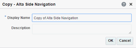

Copying an Asset
You can create copies of most assets, including the built-in assets. This is useful for when you want to:
Create a backup of an asset.
Update an asset while keeping the original in use.
Use a built-in asset as the starting point for creating a new asset. You cannot edit built-in assets, but you can create a copy to use as a starting point for further refinement.
When you create a copy of an asset, the copy is initially hidden regardless of the status of the original asset.
You cannot create copies of Content Presenter display templates.
To copy an asset:
