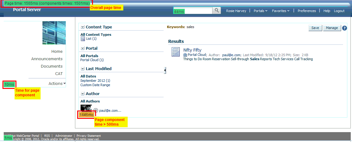

The portal page analyzer offers a simple way to diagnose slow pages and requires minimal set up or configuration. When this feature is on, the time spent on “high level” page components is calculated and displayed so you can see at a glance which components are slowing down your page. The overall time spent on the page also displays at the top left of the page (see [Figure D-1]).
Figure D-1 Portal Page Displays Timing Information
About Page Component Timings
In WebCenter Portal, “high level” page components are wrapped in a ShowDetailFrame so they can be moved, hidden or shown on the page, and edited by Oracle Composer and it is the overall timing for each ShowDetailFrame that displays.
About Overall Page Time
The overall page time is the sum of the individual page component timings, plus some additional processing time for page-level operations such as session replication, save and restore page state, page level security checks, and so on. For more consistent results, refresh the pages by clicking through the testing pages before enabling Page Performance Analysis.
Color Coding
Performance timings display in various colors to help alert you to problem areas. Refer to the following table:

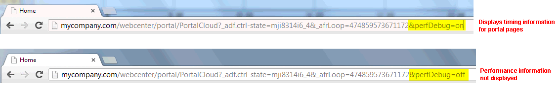

Displaying and Hiding Page Timing Information for Your Current Session
When an administrator enables the page performance analyzer in an WebCenter Portal instance, anyone with access to that WebCenter Portal instance can elect to display or hide page timing information, for their current user session, by appending the perfDebug parameter to the page URL as follows:
| To... | Add a perfDebug parameter to the page URL |
Display timing information on portal pages |
Stop displaying page performance information |
To display timing information on portal pages:
Verify that your administrator enabled the page performance analyzer in your WebCenter Portal instance.
See also Enabling and Disabling Portal Page Performance Analysis.
Log in to WebCenter Portal and navigate to the portal page that you want to investigate.
You do not need to log in if the page is a public page.
Add
&perfDebug=onto the end of the page URL ([Figure D-2]).For example:
http://mycompany.com/webcenter/portal/MySalesPortal?_adf.ctrl-state=mji8314i6_4&_afrLoop=474789135539036&perfDebug=on -
Click “Go” or press Enter to redisplay the page with timing information (as shown in [Figure D-1]).

Figure D-2 Appending the perfDebug Parameter to Page URLs
To stop displaying page timing information:
In your browser, add
&perfDebug=onto the end of any page URL ([Figure D-2]).For example:
http://mycompany.com/webcenter/portal/MySalesPortal?_adf.ctrl-state=mji8314i6_4&_afrLoop=474789135539036&perfDebug=off -
Click “Go” or press Enter to display the page again without timing information.

Append
&perfDebug=onto the page URL to display timing information for the page.See also, Displaying and Hiding Page Timing Information for Your Current Session.

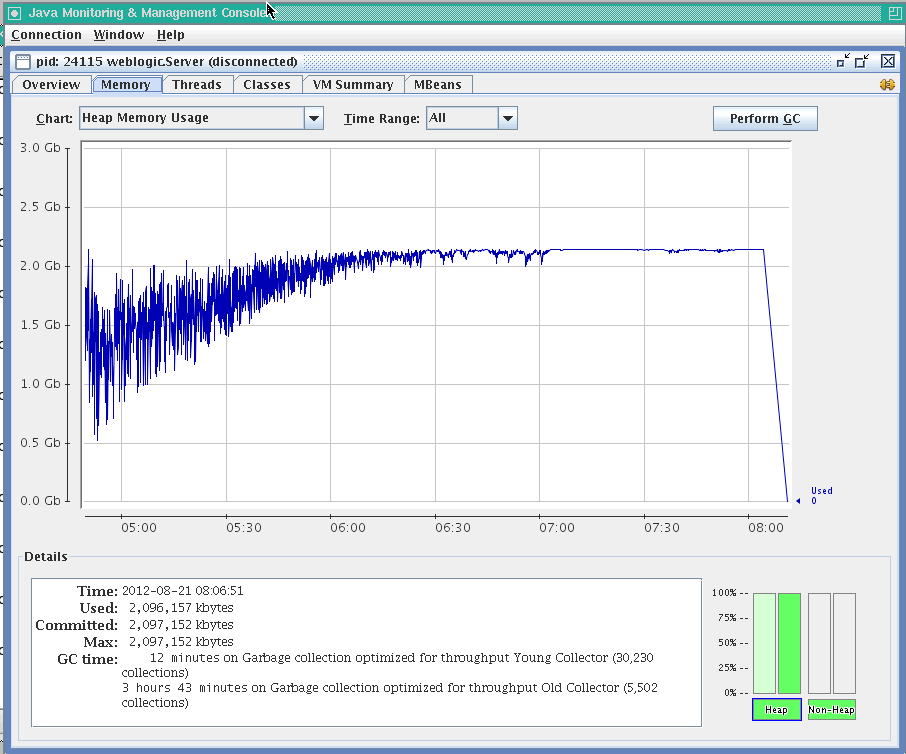

Troubleshooting Memory Leaks and Heap Usage Problems
If WebCenter Portal performance degrades over time, heap usage and garbage collection activity is increasing, and you see OutOfMemoryErrors, there could be memory leaks in the application causing the amount of free memory in the JVM to continuously decrease.
Figure D-3 Typical Memory Leak Trend in JConsole
To solve this problem:

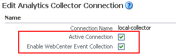

Troubleshooting Issues with Analytics
Problem
If users cannot see analytics in WebCenter Portal, verify the following:
Solution
Check that the Analytics Collector configuration is correct and in particular that both Enable WebCenter Event Collection and Active Connection are both set. See Registering an Analytics Collector for Your Application.
Figure D-4 Enabling the Connection and Analytics Collection
If you make changes to the connection you must restart the managed server on which WebCenter Portal is deployed. For more information, see Starting and Stopping Managed Servers for WebCenter Portal Application Deployments.

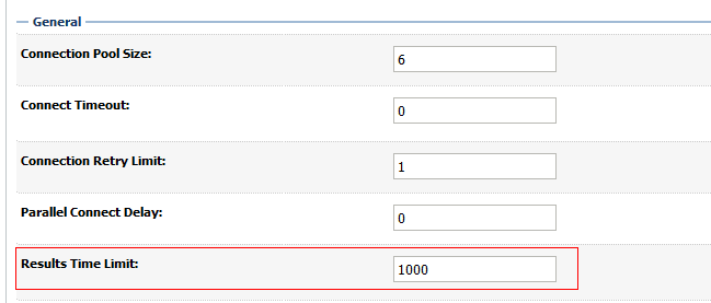

To update the Results Time Limit value:
Log in to the WebLogic Server Administration Console.
From the Domain Structure pane, click Security Realms. The Summary of Security Realms pane displays.
Click your security realm. The Settings page for the security realm displays.
Open the Providers tab and select the LDAP authentication provider you are configuring.
Open Provider Specific tab and verify if the Results Time Limit is set to some value, other than 0.
Figure D-5 Specifying the Results Time Limit Value
Increase the Results Time Limit value and click Save.
Restart WebLogic Server for the changes to take effect.
