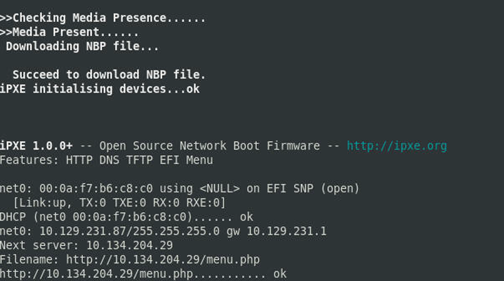

    The host will perform a PXE boot from the Oracle Dual Port (25 Gb or 100 Gb) Ethernet adapter port, DHCP, and the UEFI PXE boot server response. This screen appears.
    image:Screen shot showing the progress of the PXE boot.
  11. Choose the UEFI PXE boot server using TFTP protocol, for example:
    image:Screen shot showing how to choose a UEFI PXE boot server.

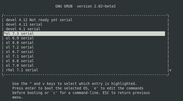

  12. Select Oracle Linux OS from the UEFI PXE boot server for the OS installation, for example:
    image:Screen shot showing how to choose Oracle Linux from the UEFI PXE                             boot server for the OS installation.

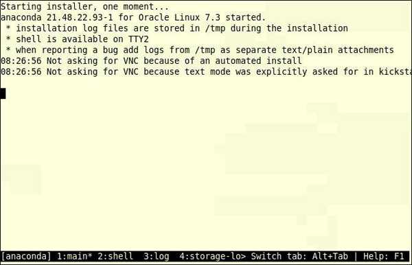

  13. Ensure that the OS installation begins on the Oracle Dual Port (25 Gb or 100 Gb) Ethernet adapter, for example:
    image:Screen shot showing the Linux installer starting the OS                             installation.

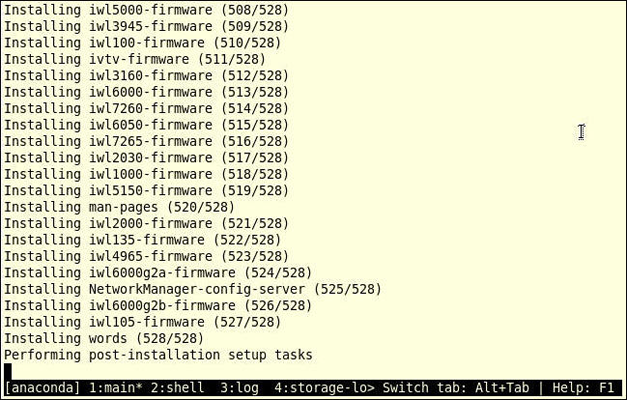

  14. Ensure that the OS installer completes and begins the post-installation steps, for example:
    image:Screen shot showing the Linux installation.
