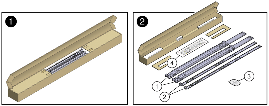

- Unpack
the slide rails.
The rackmount kit contains two slide rails, two mounting brackets, and optional securing
screws.
Note -
Refer to the rackmount kit installation card for simplified instructions
about installing your server into a 4-post rack, using the slide rail and
CMA options.
1
Slide rails
2
Mounting brackets
3
Four M4 x 5 fine-pitch mounting bracket securing screws
(not used)
4
Installation card

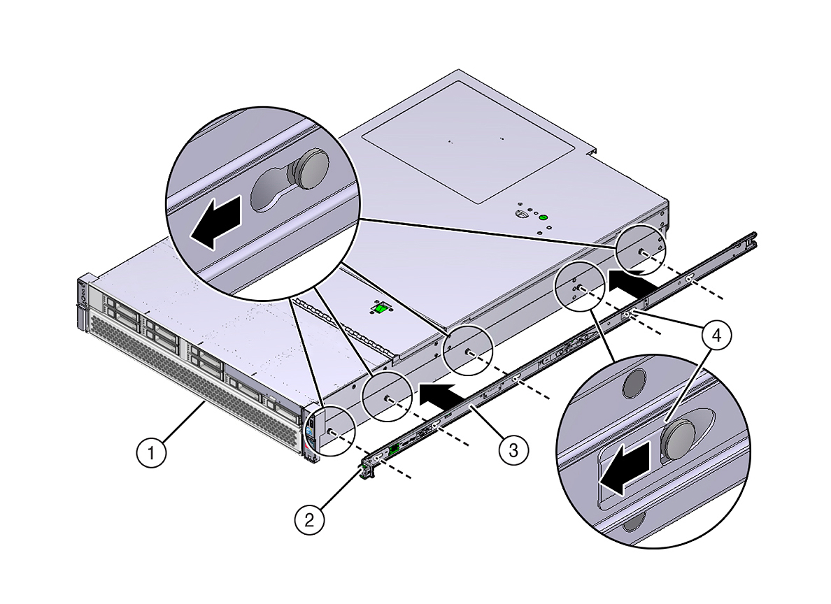

- Position
a mounting bracket against the chassis so that the slide rail lock
is at the server front, and the five keyhole openings on the mounting
bracket are aligned with the five locating pins on the side of the
chassis.
1
Server front
2
Slide rail lock
3
Mounting bracket
4
Mounting bracket clip
- With the heads of the five chassis
locating pins protruding through the five keyhole openings in the
mounting bracket, pull the mounting bracket toward the front of
the chassis until the mounting bracket clip locks into place with
an audible click.
- Verify that the rear locating
pin has engaged the mounting bracket clip.
- Repeat Step 2
through Step 4 to
install the remaining mounting bracket on the other side of the
server.
