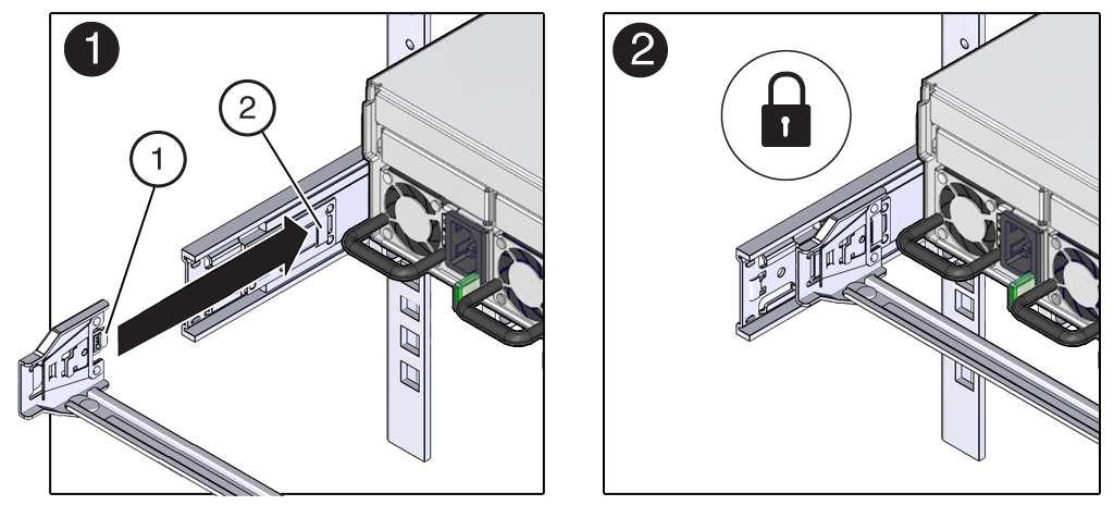

Install the CMA's connector A into the left slide rail.
Insert the CMA's connector A into the front slot on the left slide rail until it locks into
place with an audible click (panels 1 and 2).
The connector A tab goes into the slide rail's front slot (panel 1).
1
Connector A tab
2
Left slide rail front slot
Gently tug on the right side of the front slide bar to verify that connector A is properly
seated.

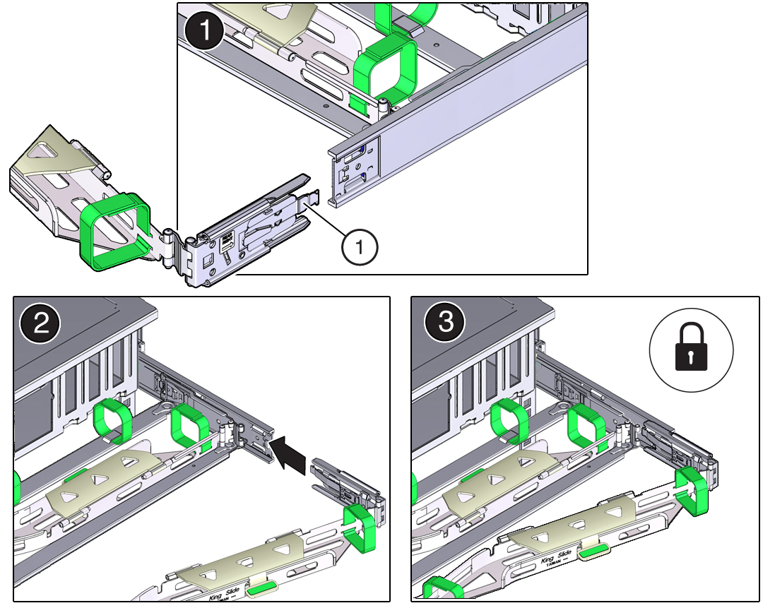

Install the CMA's connector C into the right slide rail.
Align connector C with the slide rail so that the locking spring (callout 1) is positioned
inside (server side) of the right slide rail (panel 1).
1
Connector C locking spring
Insert connector C into the right slide rail until it locks into place with an audible click
(panels 2 and 3).
Gently tug on the right side of the CMA's rear slide bar to verify that connector C is
properly seated.

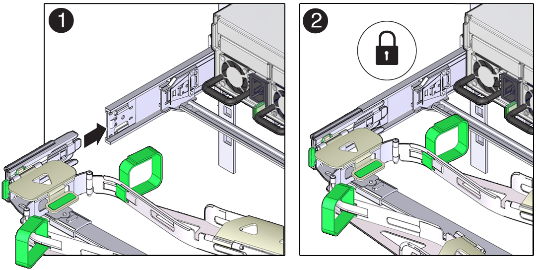

Prepare the CMA's connector D for installation.
Remove the tape that secures the slide rail
latching bracket to connector D and ensure that the latching bracket is properly aligned with
connector D (panels 1 and 2).
Note -
The CMA is shipped with the slide rail latching bracket taped to connector D. You must remove the tape before you install this connector.
Install the CMA's connector D into the left slide rail.
While holding the slide rail latching bracket in place, insert connector D and its associated
slide rail latching bracket into the left slide rail until connector D locks into place with an
Note -
When inserting connector D into the slide rail, the preferred and easier method is to install
connector D and the latching bracket as one assembly into the slide rail.
Gently tug on the left side of the CMA's slide bar to verify that connector D is properly
seated.
Note -
The slide rail latching bracket has a green release tab. This tab is used to release and
remove the latching bracket so that you can remove connector D.
seated.
Note -
