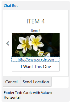

responseItems:
- type: "cards"
  cardLayout: "horizontal"
  footerText: "Footer Text: Cards with Values: Horizontal"
  cards:
  - title: "${myvalues.name}"
    description: "${myvalues.description}"
    imageUrl: "${myvalues.image}"
    cardUrl: "http://www.oracle.com"
    iteratorVariable: "myvalues"
    actions:
    - label: "I Want This One"
      type: "postback"
      payload:
        action: "itemPicked"
        variables:
          user.horizontalVariable: "${myvalues.name}"
globalActions:
  - label: "Cancel"
    type: "postback"
    payload:
      action: "cancel"
  - label: "Send Location"
    type: "location"
Description de l'image rich-text-card-inlay.png ci-après
