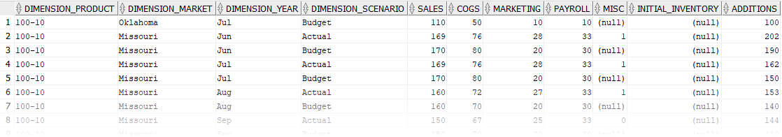

以下是一個事實表格的範例,其中計量維度已經旋轉,這表示它是樞紐分析維度。此旋轉維度影響了事實表格的型態,因為該維度已儲存成員變成以下資料欄標頭:SALES、COGS、MARKETING、PAYROLL、MISC、INTITIAL_INVENTORY 以及 ADDITIONS。

    CREATE TABLE "SAMP_FACT"
    ( "PRODUCT" NVARCHAR2(1024),
    "MARKET" NVARCHAR2(1024),
    "YEAR" NVARCHAR2(1024),
    "SCENARIO" NVARCHAR2(1024),
    "SALES" NUMBER(38,0),
    "COGS" NUMBER(38,0),
    "MARKETING" NUMBER(38,0),
    "PAYROLL" NUMBER(38,0),
    "MISC" NUMBER(38,0),
    "INITIAL_INVENTORY" NUMBER(38,0),
    "ADDITIONS" NUMBER(38,0)
    ) NOCOMPRESS LOGGING PARALLEL 4;
