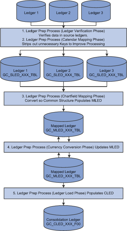

Ledger Preparation Processing Phases
The ledger preparation processing phases are:
Ledger Verification.
Verifies source data prior to running the Ledger Preparation process.
Calendar Mapping.
Maps subsidiary source data to a common accounting calendar, removes unnecessary keys to improve processing times, and populates the source staging ledger.
Ledger Data Mapping.
Maps ledger accounts to a common account structure and populates the mapping ledger.
Currency Mapping.
Maps monetary amounts a common consolidation ledger currency and updates the mapping ledger
Loading the Consolidation Ledger.
Moves data into the consolidation ledger.
These naming conventions identify the records used at each phase of ledger preparation processing; if customizing, replace XXX with the unique identifier that you have established for each record:
GC_SLED_XXX_TBL |
The name for the ledger record after the calendar mapping phase. This is the source stage ledger, or SLED. The delivered record for the source stage ledger, PS_LEDGER_F00 is GC_SLED_PGL_TBL. |
GC_MLED_XXX_TBL |
The name for the ledger record after mapping rules have been applied. This is the mapped ledger, or MLED. The delivered record for the mapping ledger is GC_MLED_MGT_TBL. |
GC_CLED_XXX_F00 |
The name for the resulting ledger record after ledger preparation is complete. This is the consolidation ledger, or CLED. The delivered record for the consolidation ledger is GC_CLED_MGT_F00. |
This diagram depicts the ledger preparation processing flow:
Ledger Preparation processes
The format of the consolidation ledger impacts ledger preparation processing:
For trial balance format consolidation ledgers, the system processes both current period activity and year-to-date (YTD) activity (period end balances) from the source ledgers.
The system converts any YTD amounts to current period activity.
For financial statement format consolidation ledgers, the source ledger data must also be in financial statement format.
No conversion occurs.
The consolidation ledger is balanced after currency conversion by using the balancing account type rule defined for the consolidation model.

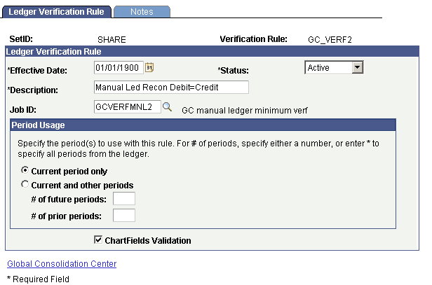

Defining Ledger Verification Rules
Ledger verification rules are based on balancing rule equations, such as debits equal credits. These equations are defined using Enterprise Performance Management Warehouse metadata, including filters, constraints, and job total metadata, which is then processed through the reconciliation engine. You define a balancing rule equation and add it to a ledger verification rule by following these steps:
Define filters and constraints for each side of the balancing rule equation.
Use the constraints to define job total metadata for each side of the equation.
Use job total metadata to define the balancing rule metadata.
Add the job total metadata IDs to Global Consolidations Ledger Verification Rules.
After the ledger verification rules are defined, you then add them to the ledger preparation rules and run the ledger preparation process. .
See Defining Ledger Preparation Rules and Groups.

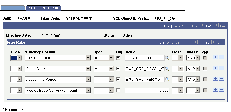

The first step is to set up the filters and constraints for the balance rule equation. In this example, two filters were established, one for each side of the balance rule equation, as follows:
This illustrates the GCLEDMDEBIT filter criteria page, which calculates the left side of the equation and selects debit data:
Filter - Selection Criteria page for the GCLEDMDEBIT filter

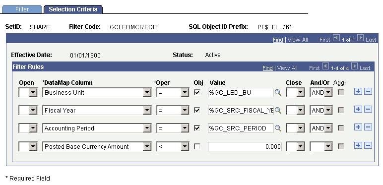

This illustrates the GCLEDMCREDIT filter criteria page, which selects the right side of the balance rule equation, credit data:
Filter - Selection Criteria page for GCLEDMCREDIT
Note. Unless you have modified the underlying fields and tables, here is no need to modify these filters.

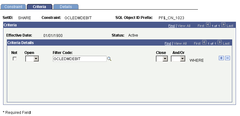

The two previously described filters were then associated with constraints, as follows:
This illustrates the constraint that was established to use the debit filter.
Constraint - Criteria page for GCLEDMDEBIT Filter

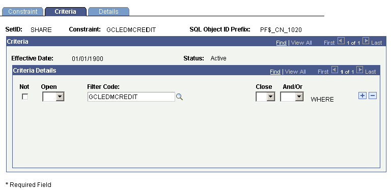

This illustrates the constraint that was established to use the credit filter:
Constraint - Criteria page for GCLEDMCREDIT Filter
Note. There is no need to modify these constraints even if you modify the filters that are associated with them, unless you have changed the names of the filters.

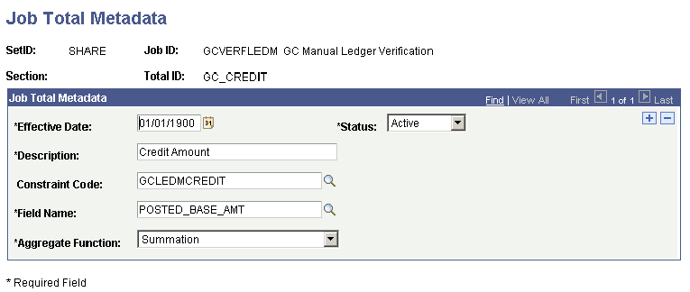

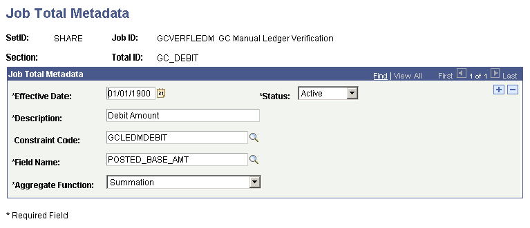

With the filters and constraints in place, the next step is to establish Total IDs for both the credit and debit constraints on the Job Total Metadata page. The Total ID's are also associated with a Job ID on the Job Total Metadata page. Because the both the debit and credit calculations are used during the ledger verification process, they are established for the Global Consolidations Manual Ledger Verification Job ID, GCVERFLEDM.
This illustrates the Job Total Metadata page for the Total ID GC_DEBIT, that uses the GCLEDMDEBIT constraint:
Job Total Metadata page for GC_DEBIT
This illustrates the Job Total Metadata page for the Total ID GC_CREDIT that uses the GCLEDMCREDIT constraint:
Job Total Metadata page for GC_Credit
Note. There is no need to modify the job total metadata even if you modify the filters and constraints that are associated with them. The only reason to modify this metadata is if you have added new filters and constraints that you want to use.
The next step is to use the Job IDs and Total IDs to establish the Balance Rules Metadata, as follows.
This illustrates the balances rules metadata for debits = credits.

The final step is to associate the Job ID from the Balance Rules Metadata with a ledger verification rule. In this example, the balance rules metadata, GCVERFLEDM is associated with the ledger verification rule GC_VERF1.
Ledger Verification Rule page
The preceding example illustrates how EPM metadata is setup to verify that the debits equal the credit. . This is one of several basic accounting principle rules that are delivered as sample EPM metadata and that you can use or modify to suit your business practices.

Access the Ledger Verification Rules page
Job ID |
Select the job total metadata Job ID you want to assign for the ledger verification rule |
ChartFields Validation |
Select to perform to perform basic ChartField (dimension) validation aginst the ChartField Edit on the ledger template during the ledger verification rule process. |
Note. To perform ChartField validation, you must specify a TSE record for use on the Ledger Template Consolidation Variables setup page. The delivered TSE record for the manual data entry process is GC_TSE_MANL_FLD.
See Defining Spreadsheet/Manual Entry Ledger Templates.
See Defining Ledger Templates.
Period Usage
Current period only |
Select this option if you only want to apply the ledger verification rule on the current period. |
Current and other periods |
Select this option if you want to apply the ledger verification rule on the current period and to a specific number of future and prior periods. You can use the * wildcard value to select all periods. |

Defining Currency Mapping Rules
Establish currency rules
Establish currency groups
Note. The system does not support multiple base currencies for a consolidation ledger. To process consolidations in multiple base currencies, create additional scenarios for each base currency.
Converting to a Common Base Currency
PeopleSoft Global Consolidations can consolidate data from source ledgers that use currencies other than the consolidation currency. Currency mapping rules translate amounts from source ledgers into a common consolidation reporting currency. You can also consolidate in more than one reporting currency by creating a scenario for each currency.
Subsidiary ledgers are converted to a base consolidation currency prior to the consolidation process as part of ledger preparation processing. This occurs after the ledgers are converted to the common consolidation calendar and the common consolidation chart of accounts. This means that you can set up currency conversion rules that are based on the common consolidation chart of accounts. The mapped ledger (MLED) stores ledger amounts in multiple currencies, so you can audit and track the translated account balances; the original account balance and currency are preserved. The source ledger’s base currency amounts are converted to the consolidation currency using the defined currency mapping rules and exchange rates. The rate type and exchange rates used are stored in Enterprise Performance Management Warehouse tables.
Currency conversion is computed by using this method:
The system obtains the number of decimal positions for the consolidation base currency from the Currency Code table (CURRENCY_CD_TBL).
This is used for rounding.
The Source Base Currency Amount is multiplied by the RATE_MULT amount from the Market Rate table (RT_RATE_TBL).
The result of the multiplication is divided by the RATE_DIV amount from the Market Rate table.
The result is rounded to the number of decimals defined for the currency in the Currency Code table.
Potentially, as a result of currency conversion, the ledger may be out of balance due to rounding or due to using different exchange rates for balance sheet accounts versus equity accounts. If so, the system generates the appropriate translation adjustments automatically. To balance the ledger, the system sums together all the account balances for a specific ledger business unit combination. If the result is not zero, then an adjustment is recorded to the account specified in the associated currency mapping rule.
Each ledger business unit is balanced independently of the other ledger business units that comprise the consolidation ledger. Each ledger business unit is adjusted separately as needed. The adjustment is recorded directly into the consolidation ledger with a source code of (02) Currency Conversion Adjustment for source data (01). The adjustment is recorded with source code of (2A) Currency Adjust - Manual Entry for manual source data (1A),
This table lists required fields for currency conversion. The system uses these fields to generate an audit trail and to navigate to the source data:
Required Field Within the Mapped Ledger (GC_MLED_MGT_TBL) |
Description |
Populated By |
GC_SRC_TRAN_CURR |
The currency in which the source ledger transaction amount is recorded. |
Ledger Mapping |
GC_SRC_TRAN_AMT |
The source ledger transaction amount. |
Ledger Mapping |
GC_SRC_BASE_CURR |
The source ledger base currency. |
Ledger Mapping |
GC_SRC_BASE_AMT |
The transaction amount converted into the base currency. |
Ledger Mapping |
GC_CONSOL_BASECURR |
The consolidation ledger base currency. |
Currency Conversion |
GC_CONSOL_BASE_AMT |
The source ledger’s base currency amount converted to the consolidation base amount. |

See Also
Streamlining Processing with Jobstreams
PeopleSoft Performance Management Warehouse and Reporting
Understanding the Ledger Preparation Process
After you have set up all the mapping rules, and established ledger preparation rules, a ledger preparation group, and a consolidation model which uses the ledger preparation group, you can run the ledger preparation process. When ledger preparation is run, source data for the specified run group or business unit is processed using the mapping rules that you associated with the business unit on the Ledger Preparation Rule page. You can run all the ledger preparation processes at one time, or you can specify which process to run. After all the ledger preparation processes are run, data from the source ledgers is transformed to a common chart of accounts, currency, and calendar and is moved to the consolidation ledger.
You can also establish ledger preparation run groups to indicate which ledger business units should be processed at one time. You can define these groups in a way so that data that you expect to receive together can be grouped into one run group, since it is unlikely that all your ledger business unit data will be available for ledger preparation processing simultaneously. This can also help if you plan to process consolidations on a distributed basis; each run group could be managed by individuals, for example, who would be responsible for the ledger preparation process for their sets of data. On the Run Group page, you can also establish ledger verification error handling options.
You can initiate and monitor ledger preparation processing for each node on the consolidation tree by using the Ledger Preparation Manager.
