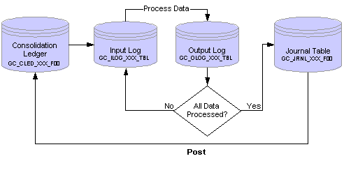

Global Consolidations uses several record objects during processing: the consolidation ledger (CLED), the input log (ILOG), the output log (OLOG), the journal table, and related temporary tables. During processing, the general data flow is:
The system retrieves data that matches the run control parameter criteria from the consolidation ledger and stores it in the input log (ILOG).
Processing occurs, using the consolidation model rules that apply.
The system writes results to the output log (OLOG) and calculates any out-of-balance amounts.
The system writes the resulting journal lines to the journal table that you define in the ledger template for the consolidation ledger.
Depending on the processing options that you select, the system posts the journals to the consolidation ledger as the last processing step, or you can run the Ledger Post application engine at a later time.
The system does not update the consolidation ledger with the results until you run the ledger post process.
This diagram illustrates the process flow:

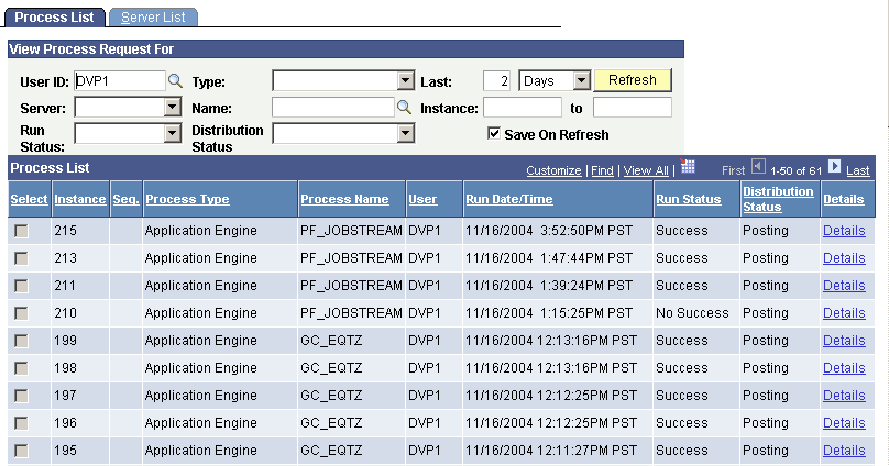

This process monitor example shows the parent and spawned children for an equitization process that was run by using the delivered jobstream:
Process Monitor page

When running the intercompany elimination process, the system:
Resolves data from the consolidation ledger (CLED) into the ILOG, based on the elimination rules for the consolidation model, the fiscal year, and period that you specify in the run control, and adds a sequence number key to each row.
Processes eliminations on the resolved ILOG data by creating entries in the OLOG to the specified elimination target ChartFields with a reversed sign, booking the entries to the elimination entity for that node.
After populating the OLOG with the elimination entries, calculates the out-of-balance amount from the OLOG lines and creates the out-of-balance entries to the OLOG.
Creates reversal entries for eliminations, if necessary.
This step depends on the processing method, which is established on the Ledger Template page for the consolidation ledger. The system creates reversal entries only if you are using a trial balance format and processing year-to-date, except when you are processing the last accounting period of the year.
Note. Steps one through four use temporary (work) tables.
Merges the temporary ILOG and OLOG tables into their permanent tables, GC_ILOG_XXX_TBL and GC_OLOG_XXX_TBL, respectively.
Creates the journal lines in the journal table with a GC_SOURCE of 04 (elimination entry).
Posts the journals to the consolidation ledger (CLED), if you choose to automatically post them.

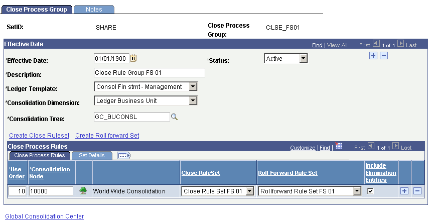

Close Process Group page with Include Elimination Entities check box selected

Running the Closing ProcessAccess the Close Processing page.
Unit, Scenario ID, Fiscal Year, and Period |
Specify the common consolidation business unit, scenario ID, fiscal year, and accounting period to process. |
Scenario Locking |
Click to access the Scenario Locking page, on which you can prevent journals from being posted to the selected scenario or tree node. |
Override Scenario's Tree Node |
Select to use a different tree node than that specified on the consolidation model. In the Tree Node field, select a tree node if you use this option. The tree node that you specify must be at a lower hierarchical level of the tree than the node specified on the consolidation model. |
Jobstream ID |
Accept the default value, GC_CLOSMGR, to use the delivered jobstream ID. |
Close Process Type |
Select the close process type. If the consolidation method is trial balance, the period input field is inactive and the system selects the close process type as Year End Processing. This field cannot be updated. If the consolidation method is financial statement based, the period input field is active and the system selects the close process type Period End Processing. This field cannot be updated. The parameter options are the same as year-end processing with two exceptions.
Note. Financial statement consolidations do not have a period zero. When selecting period end processing with a period set to the last period, the system runs the close process to period one of the next fiscal year. |
Close Request Type |
Select the close request type. When the request type option is Close/Roll Forward, the application engine posts the close amounts to the target account as a one-sided entry as well as posts the carry-forward balances to period zero of the next fiscal year. |
If you need to undo the year-end or period-end process, the system provides you with two options. First, if you incorrectly ran the close process and need to reset the posted amounts to zero, then set the close request type to Delete. If you want to replace the amounts that have been posted, then rerun the run control. The application engine deletes the entries from the previous run and replaces the amounts to retained earnings and roll forward balances with the current posting.
