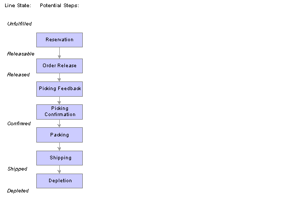

The Order Fulfillment ProcessPeopleSoft Inventory is delivered with the ability to handle one-step order fulfillment or multi-step order fulfillment. There are many options to tailor the steps in PeopleSoft fulfillment to match your work environment. Orders can be fulfilled in one step, several steps, or any combination in between based on the complexity of your shipping operations. You can use different steps in different parts of your organization.
The following diagram illustrates the possible fulfillment steps that you might use in your environment.
Potential Fulfillment Steps

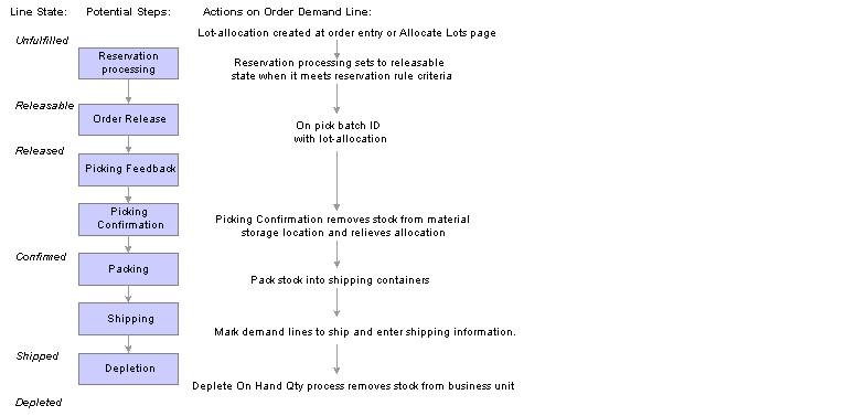

For lot-controlled items, you can create a lot allocation. The lot allocation is created when a specific lot has been allocated to a particular demand line. Lot allocations reserve quantity at the business unit item, lot, and material storage location levels. You can allocate lots to orders using the:
Order Entry Form component in PeopleSoft Order Management.
Create/Update Stock Request component in PeopleSoft Inventory.
Allocate Lots page in PeopleSoft Inventory.
Enable lot allocation by selecting the Allow Lot Allocation check box on the Inventory Definition-Business Unit Options page.
Note. The LOT_CONTROL_INV record provides a business unit view of lot quantities by summarizing quantity information for lot-controlled items recorded in the PHYSICAL_INV record.
Note. You cannot lot-allocate any demand lines that have been pre-allocated to pegging. You cannot lot-allocate demand lines that have an open peg, nor lines that have been allocated due to a peg.
The following diagram illustrates the possible fulfillment steps that you might use for a lot-allocated item.
Order Fulfillment Steps for Lot-Allocated Items
See Allocating Lots to Orders.

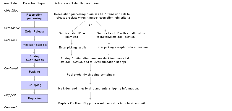

Promised itemsA promised order line is a demand line for which a scheduled shipment date has been promised based on Available to Promise (ATP) calculations of future supply and demand. Quantity for promised items is not soft-reserved or allocated (subtracted from the business unit or material storage location’s available quantity) until the demand line has been allocated by the Order Release process or confirmed as picked by the Picking Confirmation process. You can promise items marked for ATP processing using a reservations process.
Orders can be released directly from an unfulfilled state, bypassing the reservations process. ATP items released in this manner are promised and released if inventory is available at the material storage location level. Normal ATP rules are not followed as this is considered an exception situation.
The following diagram illustrates the possible fulfillment steps that you might use for an ATP item.
Order Fulfillment Steps for ATP-Items

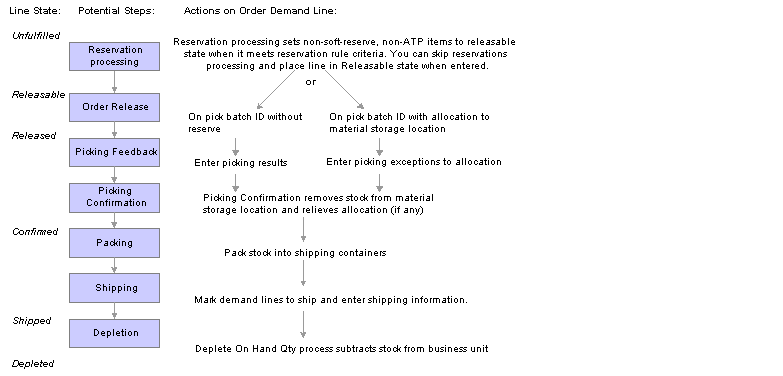

Non-Soft Reserve, Non-ATP Items
Items can be defined for no reserve, promise, or lot-allocation. Using this method, the system does not tie up available stock in the business unit until the picking stage. This is especially useful for items that are plentiful and rarely experience shortages.
Note. For non-soft reserve, non-ATP items, you have the option to skip the reservation process by adding the orders in the releasable state. Use the Non-Soft Reserved State field on the Setup Fulfillment page to choose this option.
The following diagram illustrates the possible fulfillment steps that you might use for non-soft reserve, non-ATP item.
Order Fulfillment Steps for Non-Soft Reserve, Non-ATP Items.

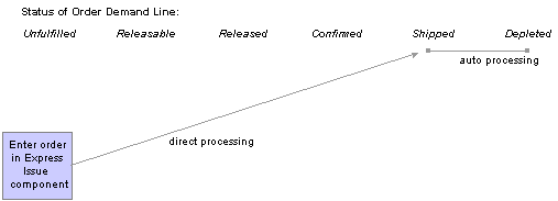

Express FulfillmentExpress issue processing is ideal for environments with small stockrooms and simple shipping needs; such as, a stock pickup window. With this direct processing method, you use the Express Issue component to enter the information required to get the requested stock to the customer or department. You can create internal orders, external orders, interunit transfers, and return-to-vendor orders from this component. Once the order is created and saved, the demand lines are placed in the shipped state. Using the auto-processing options for Express Fulfillment, you can then have the system launch the Deplete On Hand Quantity (Depletion) process at save time along with any direct invoicing process.
The following diagram illustrates the express fulfillment option:
Express Issue
This option is appropriate when you process only small volumes of stock and when you communicate directly with an internal department representative or customer while entering the order. Express issue entries cannot handle future shipment dates, kits, approval processing, loads, planned loss, backorders, or ad hoc requisitions. There is no logic built into express issue picking. You simply tell the system what items were picked from which material storage location. In addition, because you must request and ship the stock during a single session, you cannot use this method for existing orders or customer shipments.

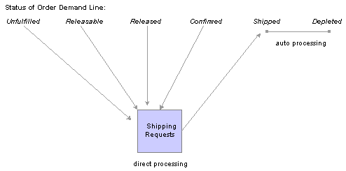

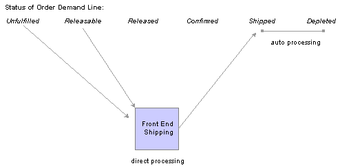

Moving Orders to the Shipped State
These direct processing methods enable you to move demand lines to the shipped state, bypassing any fulfillment steps that are unnecessary in your environment.
Use the front-end shipping requests to move demand lines from an unfulfilled or releasable state to a shipped state. The shipping request can be launched by the:

The following diagram illustrates the front-end shipping options:
Front-End Shipping
Use the shipping requests to move demand lines from an unfulfilled, releasable, released, or confirmed state to a shipped state. The shipping request can be launched by the:
Shipping Requests process page.
Fulfillment Workbench using the action of ship.
INVENTORY_SHIPPING EIP.
The following diagram illustrates the shipping request options:
Shipping Requests
